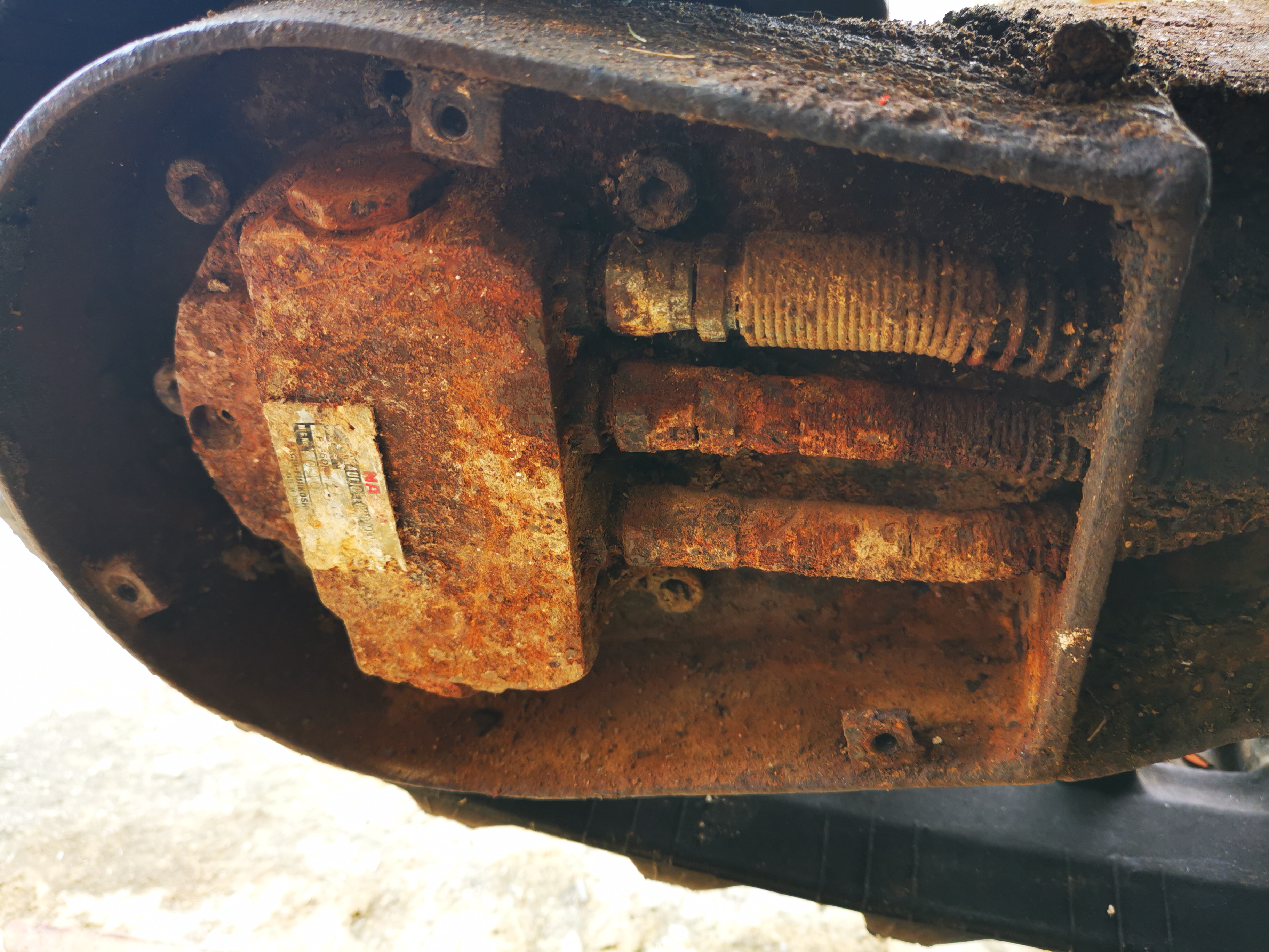

Ok, did final drive oil change (it was dark but I don't see bits of metal etc). Raised non-loaded left track still moves really slow & I can stop final drive from turning using my bare hands.
Open up the back of final drive to see 3 very rusted hose & components. I can't tell which is the drain hose, but just guessing by the looks is it the top hose? And what does this hose actually do???

If its the same setup as my old IHI. You can test the hydraulic pressure at the valve body. The three lines at the drive are forward-reverse and Case drain. If you pull the case drain off and try to move the machine back and forth only a small amount of fluid should come out. If a lot comes out then the valve plate is worn and its bypassing.
If its a two section main pump one part may be weak
If you want to play the hose swapping game. Do it at the center swivel. The hoses at the wheel side are usually pretty crunchy.
Thanks racerboy, really appreciate the tips. "Crunchy" is the perfect description!

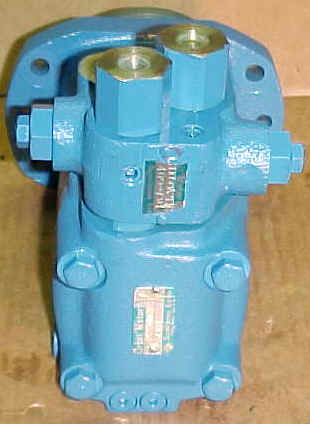

(1) Can we tell if a pump is two section just by looking at it? Mine seems to be connected somehow & have 2 part numbers on it. (found a photo here : Inventories in Stock by Oemsurplus911.com)
(2) For the 3 hoses, can I safely assume the top hose (which is thickest) is the case drain hose?
