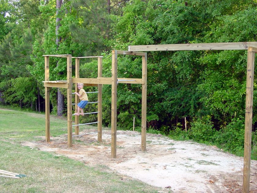

Here in one I built for a friend. Sorry don't remember the cost of material, but that has changed since then so does not matter. The swings are not in place yet. The kid really enjoy the "fort", deck, ????? Designed so I could use 21 foot galvanized pipe for the climbing rungs and monkey bars across.
