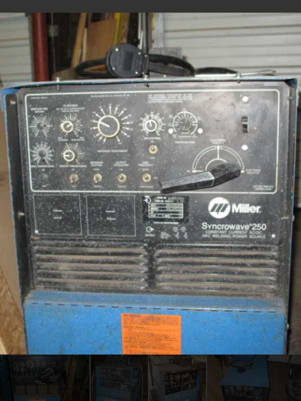

I have a Miller Syncrowave 250 with a water cooled torch and foot pedal. I don't have any idea how to set the machine. What settings should I use for steel and aluminum? What shielding gas should I use for steel? What kind of gloves do you wear? I was unable to feed the filler wire with my regular welding gloves.

I'm using 100% argon. I just wanted to make sure it was appropriate for steel and aluminum. This machine has about a dozen different knobs. How do I set those? Also my touch lets gas flow the entire time the gas cylinder is on. Is it supposed to do that? image-2763047595.jpg

The gas flow through torch on my chinese tig and the Lincoln both control the gas valve (on time by pedal and after flow by timer). So it sounds like you have an issue there.

I'd have to be there to help set it up for you. It's been about a hundred years since I ran a Syncrowave. No! The gas is only to be on when you press the pedal. I'm sure that welder has pre, and post flow, which should have a dial to adjust the amount of time for pre, and post flow. The gas solenoid must be stuck, or broken.

I played some more with it today. I can hear gas hissing all the time, but when I hit the foot pedal a different hissing sound happens. If I turn off the gas tank both hissing sounds stop. There is a gas control switch on the welder. If I flip it it stops both hissing sound, but it doesn't release gas when I press the foot pedal. Another problem. Today I was welding with it and it suddenly stopped. I haven't been able to produce an ark since then. The ground appears to be good. My Grandpa thinks the foot pedal might be messed up.

I'd suggest pulling the cover and blowing it out real good (this is a service procedure mentioned in the manual btw), and while you have it off check your points gaps, and the hoses inside the machine to the valve and the torch. I'm betting you have a crack given the age of the unit.

Also - based on the angle of your power selector, I don't think you have it locked into a functional position and that's why it stopped.
I'm tired. :D I meant to say the AC position bypasses the rectifier diodes on the output. That's what another 12 hour day does to my brain. I also have a pulser module. Not seeing all that stuff on your control panel, but we can go over that if you need more help.

That isn't my machine. I just Googled that picture. I have moved my selector around. It doesn't make any difference set to electrode negative or positive.

You should be able to go into a lift arc or SMAW and get an arc started if your remote (the pedal) isn't working.

See if you have a remote setting it should be in the off setting.
