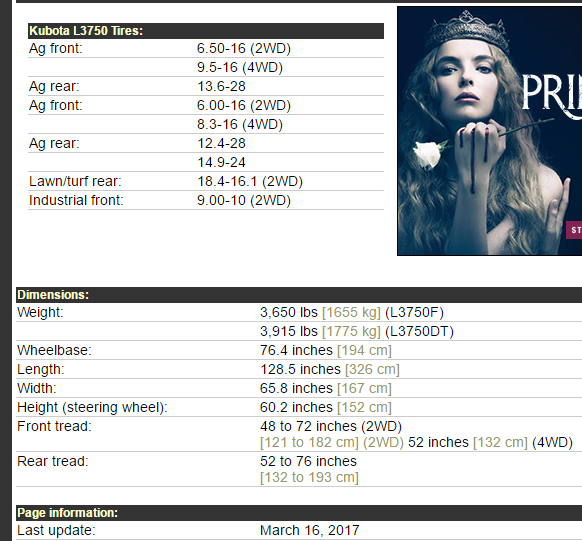

Tractordata.com list (L3750 4wd) fronts 7.2x16 and rears 11.2x24 .I would change them all.Buy U.S.A made tires and not Chinese ******.
Slightly confused, the tires on now are fronts 9.5 -16 and rears 14.9 - 24. Not sure what the number mean. Looking up now, the second number is the same for both.

It means width and rim size.Some one has obviously changed your tires at some point.Again check at
TractorData.com - information on all makes and models of tractors for info on your tractor or call a Kubota dealer.
So this is the screen shot for the tire options. Both the tires on the tractor are listed, I have found a "tire guy" just have to track him down. :)

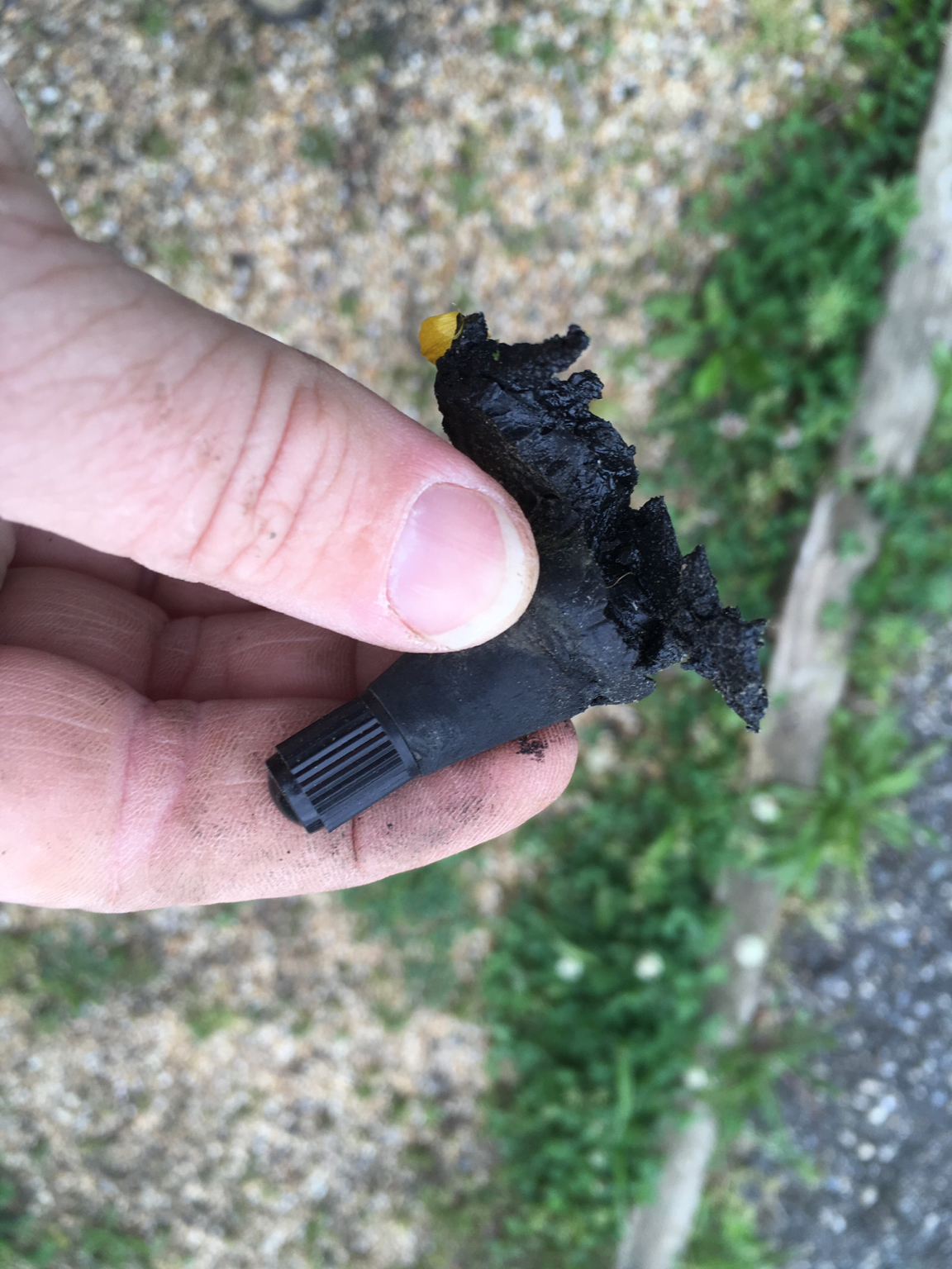

Well quick update. So this happened.
Came out and the valve stem and a small chunk of the tube was laying on the ground next to the left front. Was not the way I thought the tire would go. However the 'good' to come out of it is that I would have never thought to order tubes. Oh the things I am learning.
