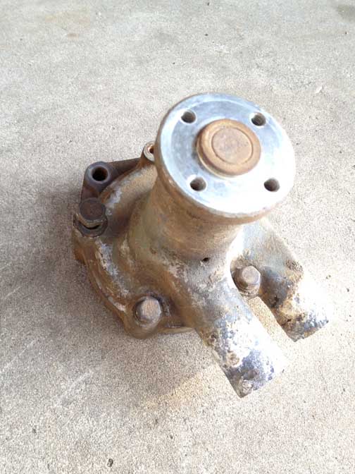

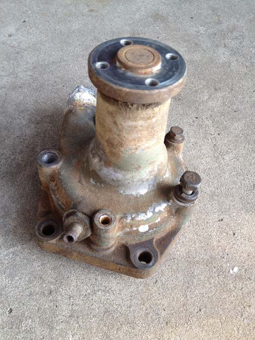

Here are a couple photos of the 177 water pump. My brother (Stealthrogue) and I took it off so we could try to find a used one or rebuild this one for the tractor. I'm not sure if it's rebuild-able as it had a lot of sediment that came out of it and the ports seem to be eaten away some. What do you all think?
Notice it has a small water port at the top that hooks to a temp gauge, I guess.
This looks identical to the 2200 water pump but the 2200 doesn't have the port at the top.
-James

*Note. This pump still has the mounting bracket attached so the two extra bolts holes at the top are for the mounting bracket. We can't get it off as the bolts broke and will need to be drilled out. :-(
   / Help with yanmar y177 ? #15
If you can locate 1 .I would just replace it than try to rebuild.Good luck !
   / Help with yanmar y177 ? #16
Thanks @kenmac. That's what I am thinking, hard to locate though. Hoye doesn't have one. Sent a message to BrokenTractor and will see what they have.
   / Help with yanmar y177 ? #18
I have had real old antique water pumps rebuilt for trucks and tractors. I used to do my own fixing stuff on the farm and you would be surprised at the interchangeability of parts its just a bearing and a seal.
Those guys know what they are doing so dont worry send it in and get a quote. I imagine that if Yanmar pumps can be rebuilt some other kit will fit yours. That pump looks suspiciously like whats on mine fwtw so its likely common parts with some others.
   / Help with yanmar y177 ? #19
Thanks guys. :thumbsup: I think I will send it to Hoye and let them try. It looks very close to the 2200 so I'm sure the bearing will fit. Or if not then if the 2200 has the same bolt pattern I can have the small port at top drilled and threaded to fit the port for the temperature gauge. I will post how it goes for you all.
