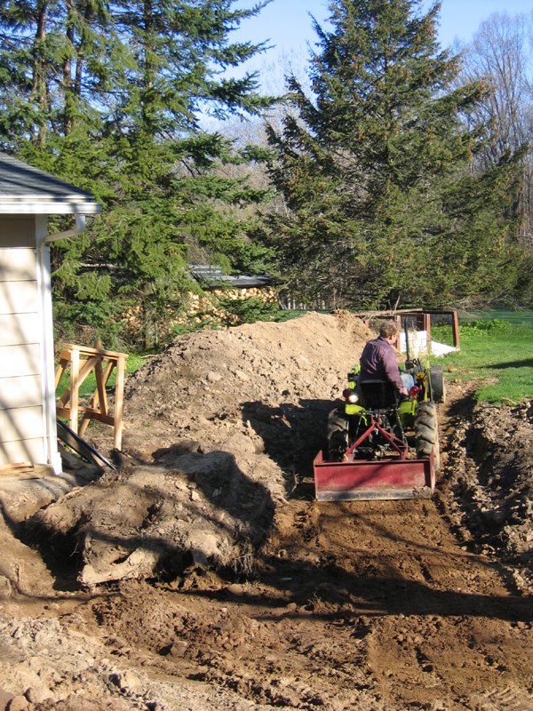

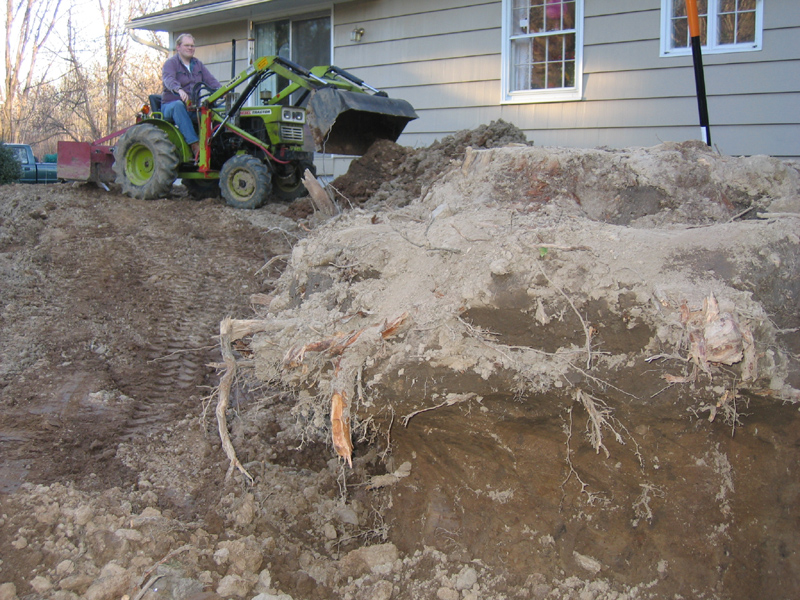

Hi Mike,
What you see in the picture is actually a Woods RM42 rotary cutter (bush hog). It's a good match size wise for this machine at 42". Not that it makes much difference, but my 155 is two more HP than the 135. Last year I did pick up a 3pt 48" landpride finish mower in hopes of consolidating to one tractor for mowing and light earth engaging work. (I also have a 25 yr old wheel horse). Due to the higher blade speed I think it cuts better than the wheel horse, but it is cumbersome mowing with the loader and the fact that the PTO engages with the transmission. For my situation, it's really not any faster and my neighbors giggle at me and think I'm obsessed with my tractor. Of course, they don't mind when I clear their driveway.
I heard you're moving to the suburbs. If it's any consolation, I live on an acre with about 1/3 of it wooded and I look for any reason to "have to keep" the tractor. I originally got it and a box blade to improve drainage and cut a swale preventing water from puddling against the house. Now we're talking patio. I guess I better keep it. :D
Sorry, don't mean to derail this thread. Green, I'd be very interested to see your loader. I'm impressed how tough these little tractors are. Just be careful of the front end. They're not as robust as the larger cousins like the 1500 or 1610 or 186. Still, for an acre of land I'm content.
Craig
