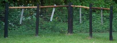

I'm attaching a few pictures of how I splice fence rolls and brace corners.

My posts are 15ft. apart. My brace posts are about 7ft from the corner post and 7ft. from each other. I stretched with 2 boards using 3 bolts and a chain in the center of the boards. Pulled like heck with my L3710 Kubota bucket. It's so tight you could bounce an elephant off of it. /forums/images/graemlins/grin.gif

attaching end post picture
