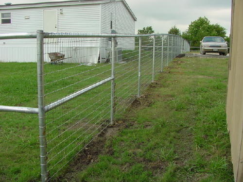

Here's how I do a woven wire fence over a pipe framework.
Wooden posts work fine. But this system will outlast just about anything else.
First I tie off the far end. What is important here as far as I'm concerned is two things. The first of course is the wire is tied off perpendicular to the lay of the land. If there is a bias then the wire shouldn't be cut and finished plumb.
What I usually look at is the section to see if the roll in the land isn't balanced. If it goes down then back up about the same distance then a plumb finish is called for. If it's a steady grade change then that angle determines the bias cut and finish.

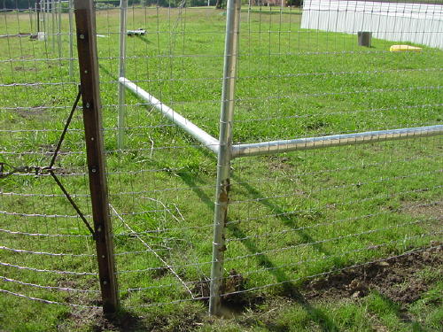

   / Help! Woven wire fence question #24
I like to pull past the end post. I will jump through hoops calling out bad words to pull past the post. Pulling past the end post allows me to finish out a section like it's supposed to be done. I can do it pulling to the post, it's just not as easy, harder to make look good.

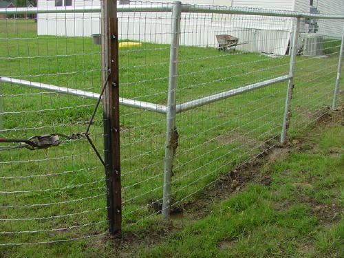

   / Help! Woven wire fence question #25
Then comes the fun part, peeling the vertical strands away to expose the horizontal ones for wrapping the posts.
I use end nippers.

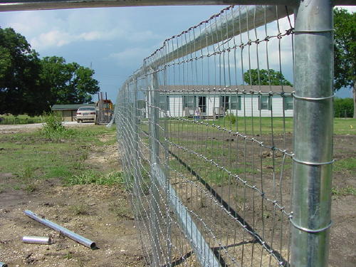

   / Help! Woven wire fence question #28
Here's what it's all about. A fence that's tight'er Richard's hat band and even it it rolls with the ground it does so in an even and attractive manner. I'll go back and put five ties on each post and as many between posts.
It'll stay tight and last for a long long time.
