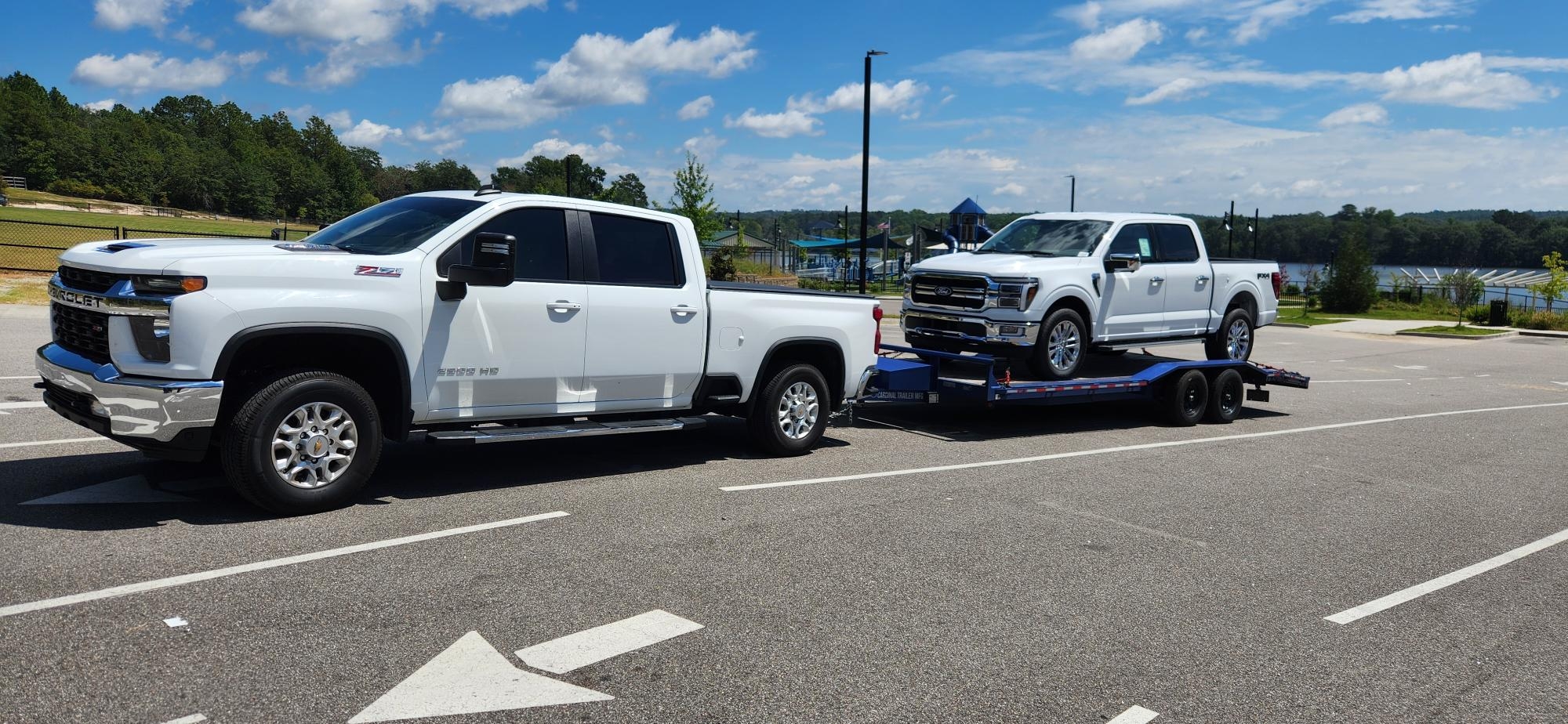

I've been hauling pretty regularly lately. I guess I need to address the squat... Do any of you have experience with anything to help? I've seen air bags, big gigantic bump stops, and some sort of contraption that bolts onto the top of the spring pack. I don't want to spend a ton of money. It still rides just fine but it squats just a couple inches low in the back compared to the front and I blind oncoming traffic at night. The picture with the truck on the trailer I apparently had the camera on the fish eye setting. It was not as bad as the picture makes it look. It basically always squats to the same level, about 2-3 inches low in the back. I guess that's where it picks up the heavyweight spring in the pack.
You should run this load over a scale.
You may find that you have too much tongue weight.
With a 24’ trailer you should be able to balance that load very well.
Air bags may help once you get the load balance correct.
   / Helper springs/ Airbags Etc.
#16
Maybe not a bad idea. I'm probably doing it to myself since I am just gaining experience. Just a small move front to back makes more of a difference that I would have expected on the squat. I've been basically eyeballing the squat to determine how far forward to place it. In my mind it seems like everything should be farther forward and I'm afraid of being too light on the tongue.
I got back after this trip after the local lot closed so my friend took it to the lot for me Monday morning and his 3500 was also squatted more than I expected. Though not as bad as mine.
I have thought about making a stick/ gauge to measure the height of the rear fender to get optimal squat. It's hard for me to make a quick judgement on if I have it right by myself. Also, while I'm not trying to rush getting the cars chained down, I don't want to spend a whole lot of time in the car lot getting in and out looking like a green horn. So I end up going a foot or so farther forward just to make sure I have enough tongue weight.

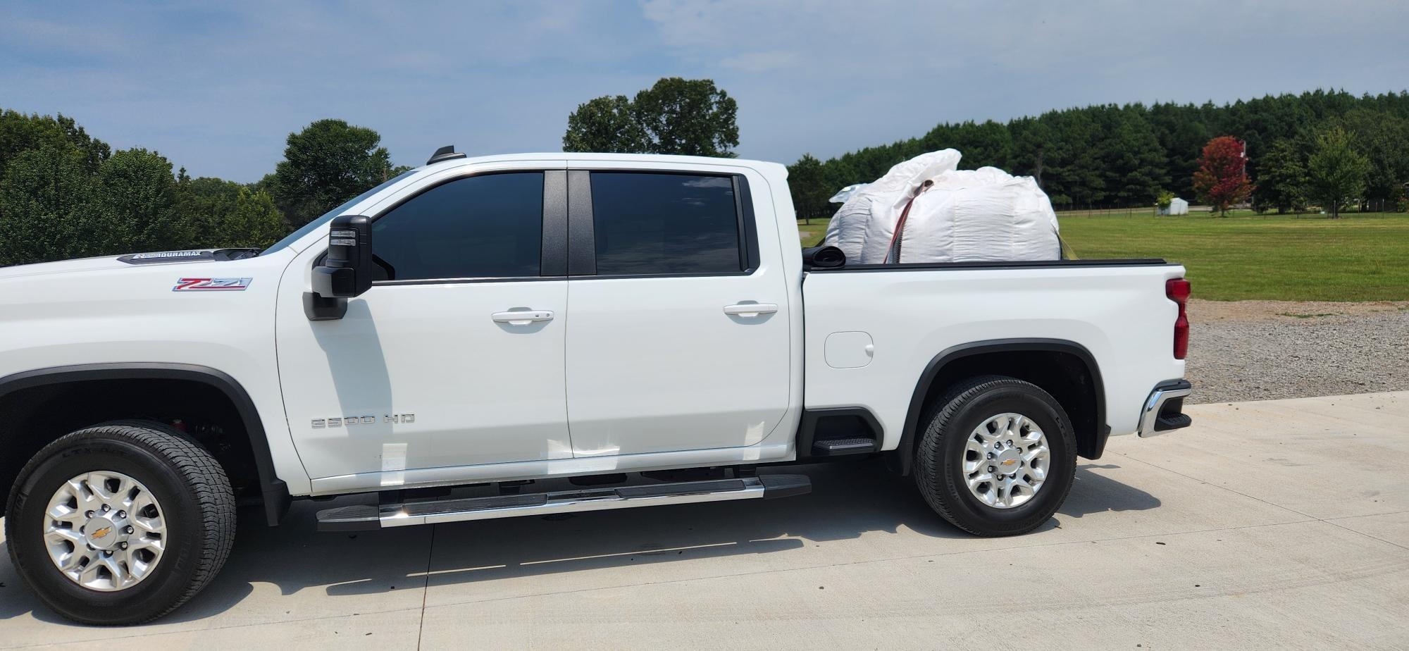

Also this is 2,000 pounds of corn. So maybe I am getting a little too much tongue weight on the trailer. This looks less squatted with that much weight.
