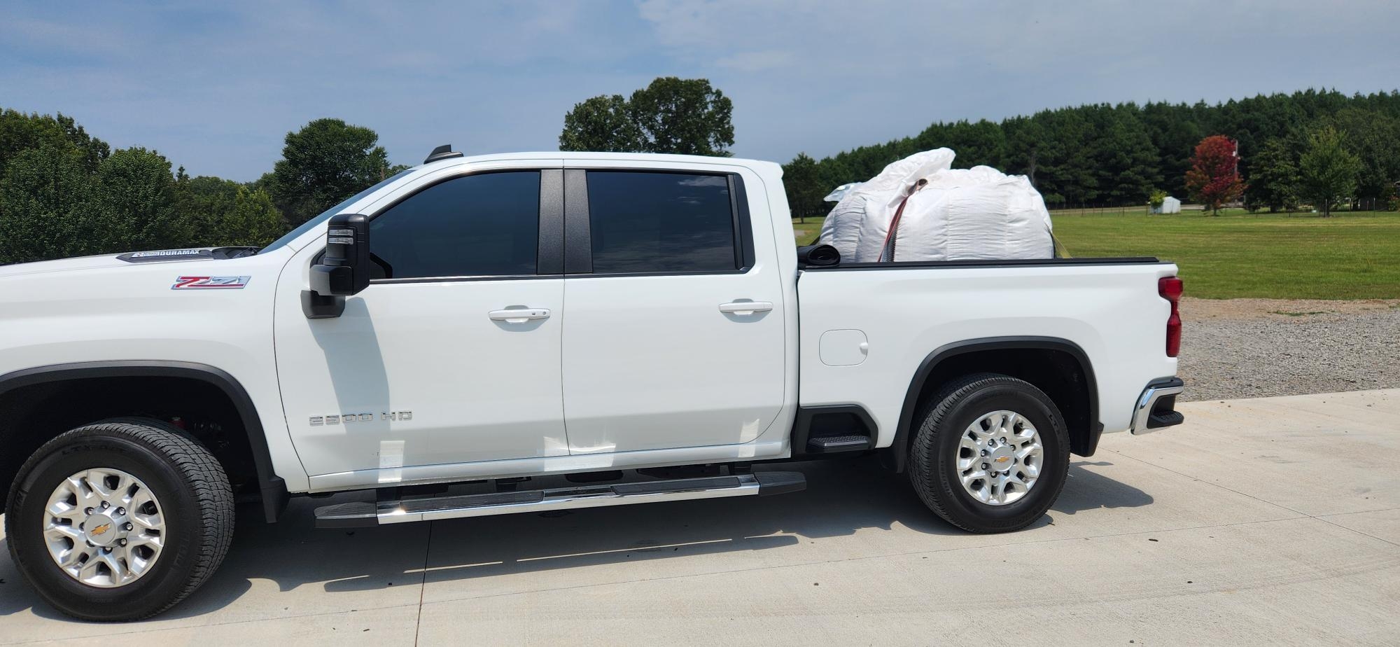

I’d say yes you are. It has a little squat but what I’d call normal and very acceptable.
   / Helper springs/ Airbags Etc. #22
Also this is 2,000 pounds of corn. So maybe I am getting a little too much tongue weight on the trailer. This looks less squatted with that much weight.
Looks good. Keep in mind, the corn is placed different on the truck v/s a bumper hitch. The corn appears to be centered over the axle, so it is not unloading the front axle. Without a W/D hitch, a bumper hitch, will always, unload the front axle, adding to the squat.

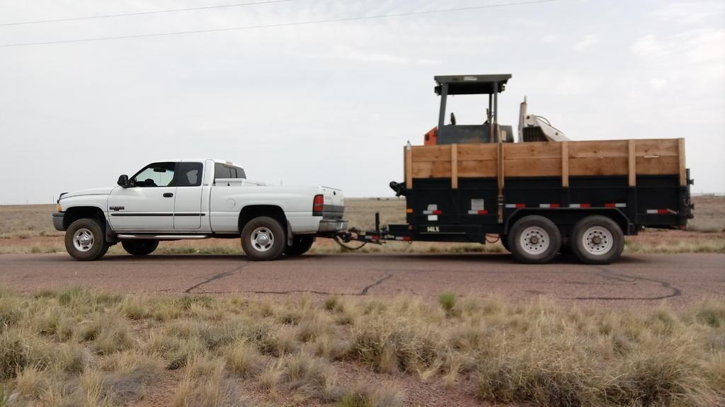

The dump trailer is maxed out, 14k. Note, with W/D hitch, the truck and trailer are level.

I pulled a Ford Lightning E-Truck this weekend. I think they are about 1,000-1,500lbs heavier than a standard F-150. This is the heaviest of the fleet of trailers we have. I wouldn't doubt it weighs 4,500lbs. 24' all steel deck with 7k axles and lots of real estate in front of the axles. I threw a stick and sharpie in the truck before I headed out. (Eyeball estimates) The empty trailer squatted the back end about 2". I loaded the truck pretty far forward of the centerline of the trailer axles and stopped at 1/2" additional squat. So what you see here is about 2-1/2 to 3" of squat in the rear. It rode really good. So I must have just been loading way too far forward. I must have a little less unloaded rake front to back since it looks like the little bit of squat I have is below level. However my headlights were still pointed at the road enough nobody flashed me.
