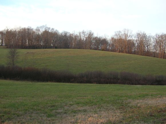

I'm a newbie and a nettering Nellie when it comes to tractoring on slopes, so I always buckle in extra tight, use 4 wheel drive, and I bought two of the TBN tiltmeters, one mounted for "roll" (left/right) angle and the other mounted for "pitch" (up/down) angle. Each has a "redline" starting at 15 degrees, so in roll, I slow to a worm-like crawl at angles approaching 10 degrees and I never exceed 15 degrees; in pitch same except at 20/25 degrees. This gives me a buffer from the above J.D. 20/30 roll/pitch max angles so if I do drop into something, I've got a safety "net". I go up/down on anything over 10 degrees if at all possible. And, I always walk the area before tractoring it and mark or memorize the areas with drop offs. And if I don't like something, I stop, think about it, and back slooooly out of it. And when slope tractoring, I try to quit long before I'm tired, so fatigue doesn't kill me. I think the moral of the story is you need to fear and respect slopes on a tractor. This photo shows I've got a wonderful double wammy: steep slopes and treacherous stream banks. Most of that brush along the stream is now mowed, but boy was it slow and white knuckle, particularly on the uphill side. Thank goodness for hydrostatic transmissions and four wheel drive.

</font><font color="blue" class="small">( <font color="blue"> I'm a newbie and a nettering Nellie when it comes to tractoring on slopes </font> )</font>
Perhaps a very few may think so but not the majority. It's that kind of attitude that ensures you will "live long and prosper".
