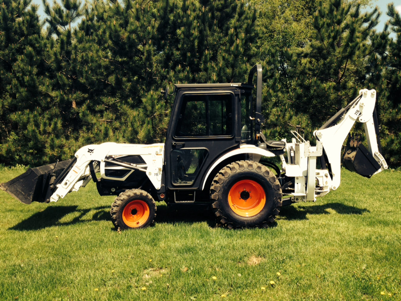

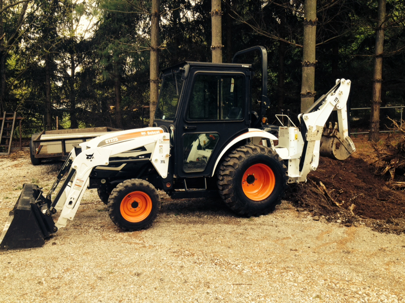

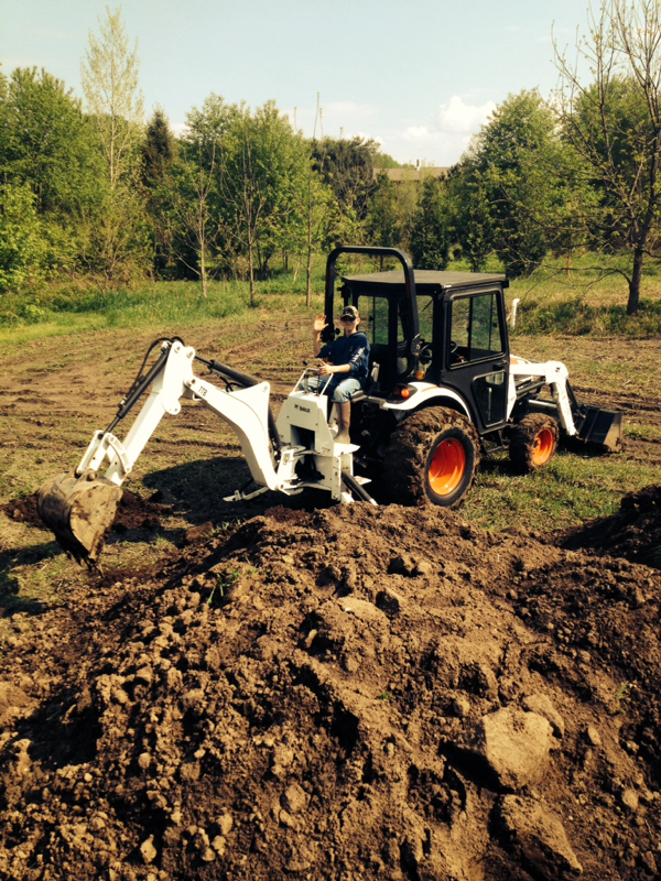

Pics. Pics and more pics. Up and running at last. Thanks to all that helped. Especially u 7.62.

Looks nice! When I read your first post, I was thinking this would be a summer long project. Three days later, boom! You're up and running.
Glad it all worked out.

I think about your radiator every time I push brush into a pile mopops. Did u ever get your forks? They sure come in handy. I spent Saturday finishing the backhoe install in morning then I dug out 6 stumps. This tractor is awesome the only hard part was cleaning off all the mud at the end of the day we had lots of rain here.

Congrats on the installation and the stumps! If I could, I would play on the backhoe all day.
