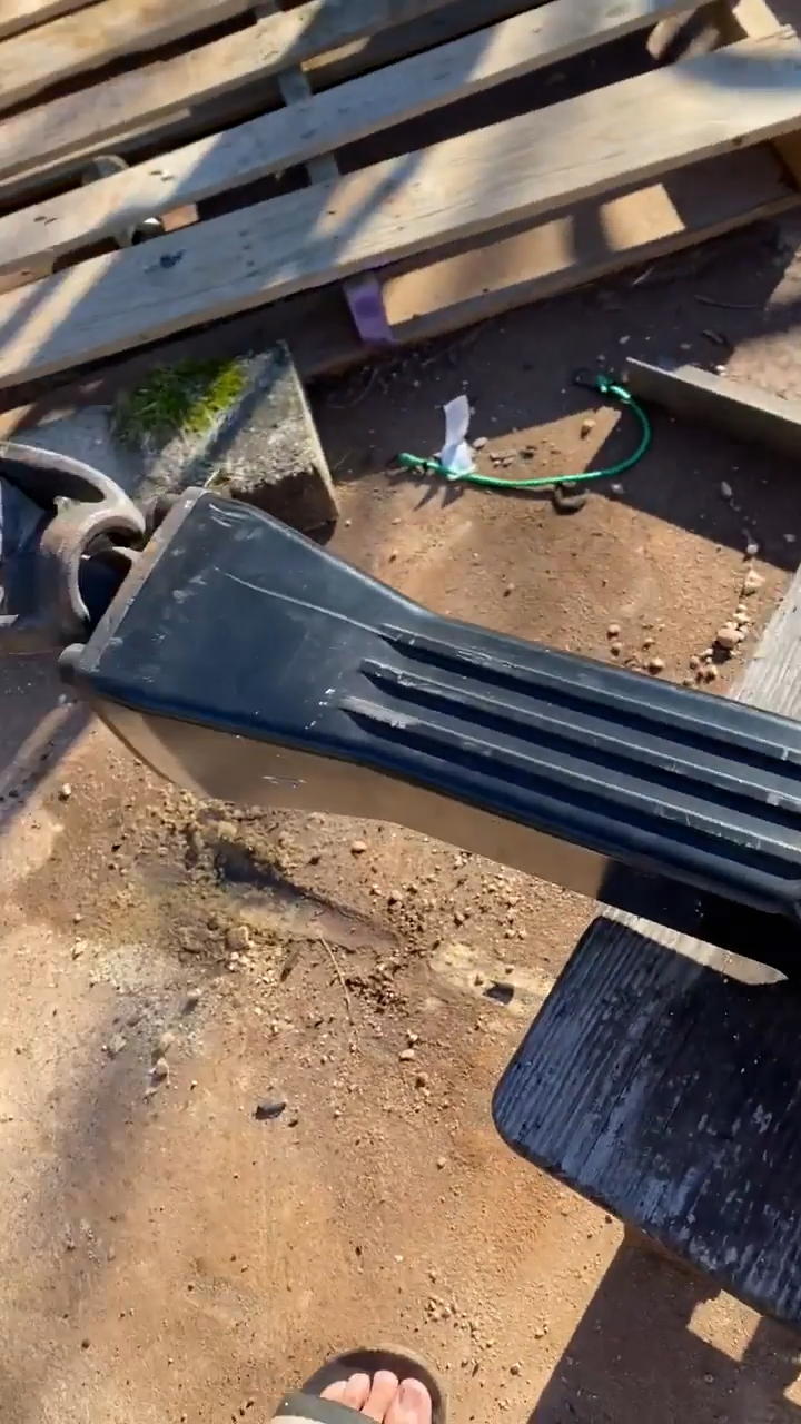

Here's why you grease your loader faithfully.

I think I'll go grease my front end loader. One of the lift pins would clunk every time I changed the direction force was being applied (using the bucket to pull coarse sand arena footing from the piles out into the flat for grading)

On the safety side, make sure you are wearing good leather gloves when you hold the hose. I've seen what a grease wound looks like. The grease pierced a weak spot on the hose and of course, pierced his hand near the thumb. Very ugly wound, for an ugly long time. Almost impossible to get the grease out of the flesh. Lucky to have his hand into his old age.
