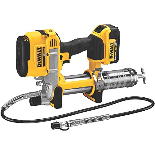

One of these helps keep things greased.
Between the loader and the backhoe it's getting well used.
