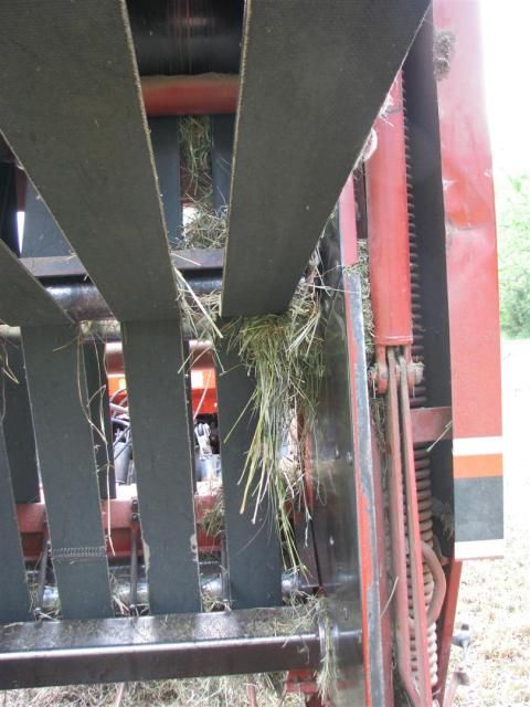

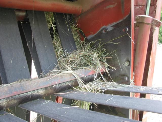

This is my 3rd season with the Hesston. Bought it used, replaced a bunch of teeth, then last year the lower shaft that holds the tooth bars grenaded($600 in parts). Rolled 200ish bales after that without a hitch. I did a preseason tune up, and found two belts(both on the outside) that needed re-lacing and did that. I know it does not like green hay, and we did push it a bit today with weather moving in tonight, but it was 85% dry which is usually not a big problem for it.
But today I could not roll two bales without having to clean out a birds nest of hay jam up on one of the outside belts/rollers. It jammed in the same spot every time and required a manual clean out between each bale. I also had to dump 6 or 7 incomplete bales that just stopped turning.
So my thoughts are:
1. the hay was green enough to cause the problem?
2. cutting off and re-lacing changed something....belt now too short?
4. it's anew unrelated problem an I have no clue
3. it's time to ditch the relic and bite the bullet on a new/newer baler?
So,,,,any suggestions?
Pic's of the nest:

Well I have a cousin baler to yours the Case IH 8430 (4x4 bales) and it jams when the hay is a little tough ... I get a small roll going and then the feeder jams and I get the so called birds nest ... sometimes it will even wrap around the rollers.
I'm betting thats the only cause. I redid all the lace's last year so all my belts would be the same length ... I have repaired them for a few years and finally decided to make them all the same length. It really helped for the bales to be uniform.
My baler does best in 16-18% moisture and feed the little devil like a starving child ... the more hay in the windrow and the more going into the baler the better the bales. Sometimes I wonder how it can take on so much .. I guess it doesn't know its a little guy!!!!!
   / Hesston 530 jamming problems...ideas?
Thanks Blue....the number one suspect(in my mind) is green hay. We rolled really dry hay last year....3 days dry in hot sun and had no problems. Your right occasionally a pick-up feed jam, but that I understand. I don't think belt length is an issue since when I could roll a bale it was pretty even.
But I'm leery of cutting a field now, drying it than not being able to pick it up. So I am going to did around a little more. My neighbor has the exact same baler, so after church I am going to go over and have a palaver with him.
