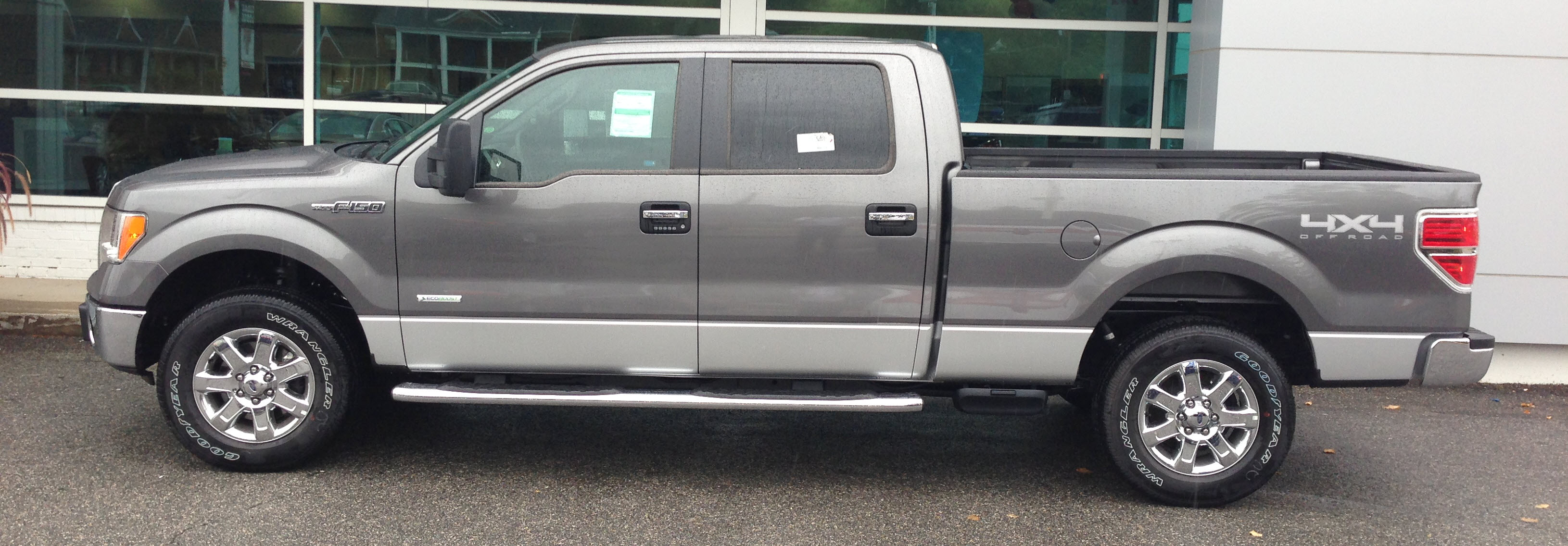

I traded in my 2010 F150 STX a couple of weeks ago for this. 2013 F150 XLT 6.5 bed eco, 3.73, 7700 gvwr and max tow.

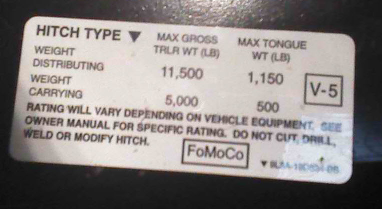

What gets me though is the sticker that's on the hitch. If I read it correctly, towing anything over 5000 .lbs needs a weight distribution hitch.

This is common. My 04 F250 was the same and my 08 Titan requires one at 6000#.
<img src="http://www.tractorbynet.com/forums/attachment.php?attachmentid=336942"/>
This is very common. I have a max tow Eco also and the max tow does have a beefier hitch than the standard tow package.
