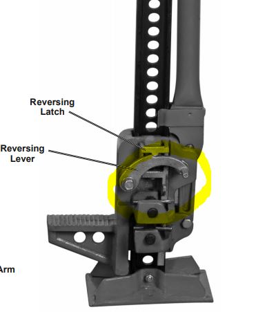

I just bought a farm jack (Motormaster 3-ton) and lifted one axel of my tractor and I can't get it to lower. Does anyone have tips on lowering a stuck farm jack? I can get the handle to move the full range of motion, it just seems like the pin is not entering the lower hole like it is supposed to.
Raise the handle ALL the way up to where it will come in contact with the main I-beam. Keeping ALL your body parts that you want to keep away from the jack and the vehicle, grab the handle loosely and fling it down. The jack should do the rest. It will bang, bang all the way to the bottom, if the pins are not seized.

Lube the reversing lever. Then what I do (which may not be correct) is when I want to let it down lift the handle so it touches the upright then pull the reversing lever down. Sometimes it requires a slight wack with a tire iron. Then crank it down slowly.

Thanks for all of the tips! I first sprayed some oil on the pin that was failing to engage and let it sit for a while. This didn't have an effect. Then I sprayed a bunch of oil on the whole ratcheting mechanism and let it sit and it worked!
I recognize the limitations in using a farm jack over a floor jack, but I think it's the only option for me. My axle is about 30'' off the ground, so I need a jack that gets up pretty high. Is there a better option out there (without spending thousands of dollars)?

Go ALL the way UP with the handle until you hear a Click the down to you hear the Click. That’s the pins locking in place.
If it does get stuck, I’ve had to raise it high enough to get the load off the ground and then let it fall over sideways. The pre shot of oil helps prevent that.

For those that a good cleaning and oiling doesn’t fix, there are repair kits for the pins and springs that make it good as new. Mine was used when I got it 25 years ago and i used it this week.
I kept an old piece of inner tube slid over the mechanism on mine during my jeeping days to keep crud out of the oily pins and gumming it up.
