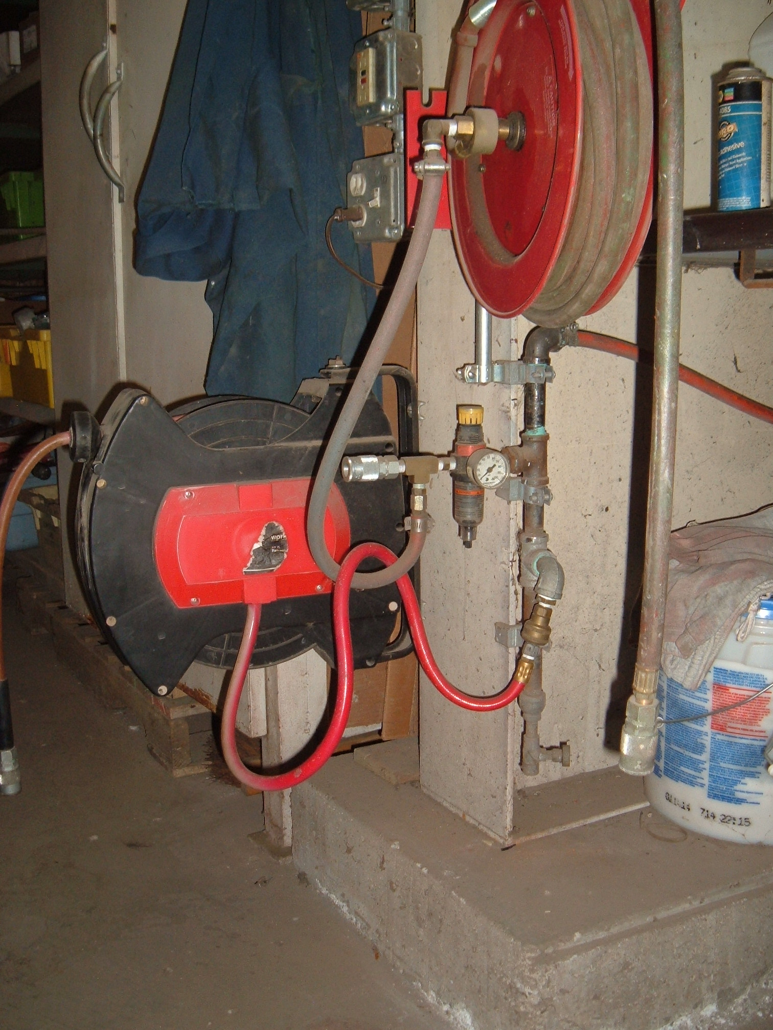

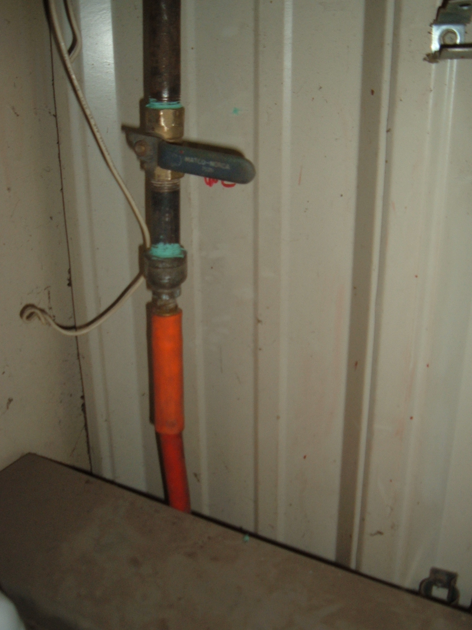

You dont need the reg for air tools at that pressure. Yes, you can put the reg any where you want and in some cases
it may work better.

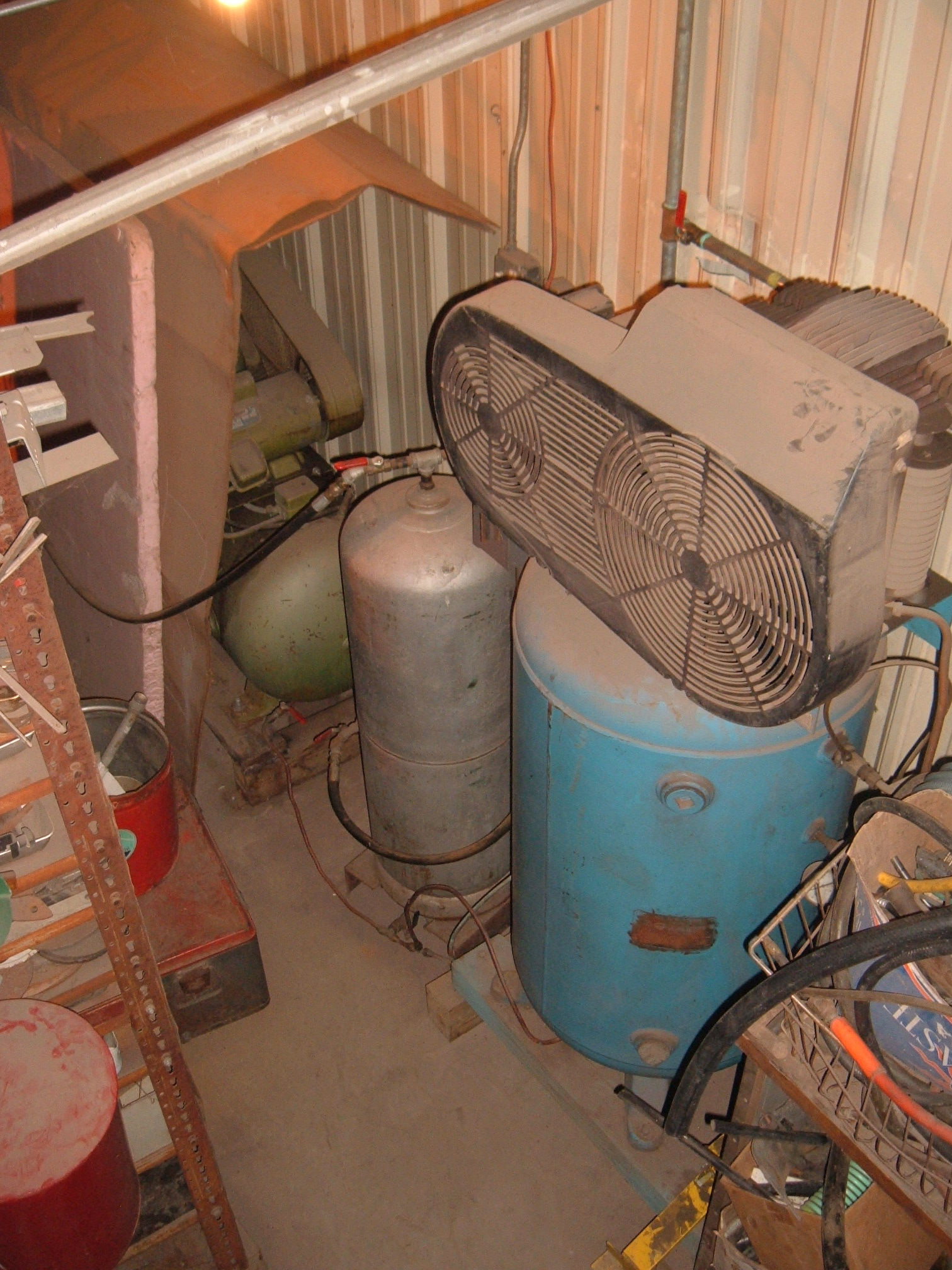

Far as I'm concerned there are only 3 dependable, long lasting reciprocating compressors, Quincy, Champion and IR. They have real lubrication systems, forged cranks, high efficiency unloaders and more than adequate cooling fins for heat dissipation plus they have real Swedish steel valves and intercoolers.
All the rest are basically limited lifetime throwaway junk. I have a Quincy QP 10 horse for my backup and I use it's 100 gallon receiver for an air receiver anyway. The more cubic feet of air storage you have, the less your compressor will cycle on and off.

Above, pic 1, regulated line from the one in pic 3 with a disconnect for that clip in pic 2. You can see additional reg goes to that reel for paint guns.

I'm on rural power as well but I do have 3 phase on the pole out front. Most rural settings only have 220 /1 and limited amperage. I have 400 coming into the mains on the house (industrial panel) and 300 to the shop.
I see you use the same pipe dope I do. It's good stuff but it stinks.
