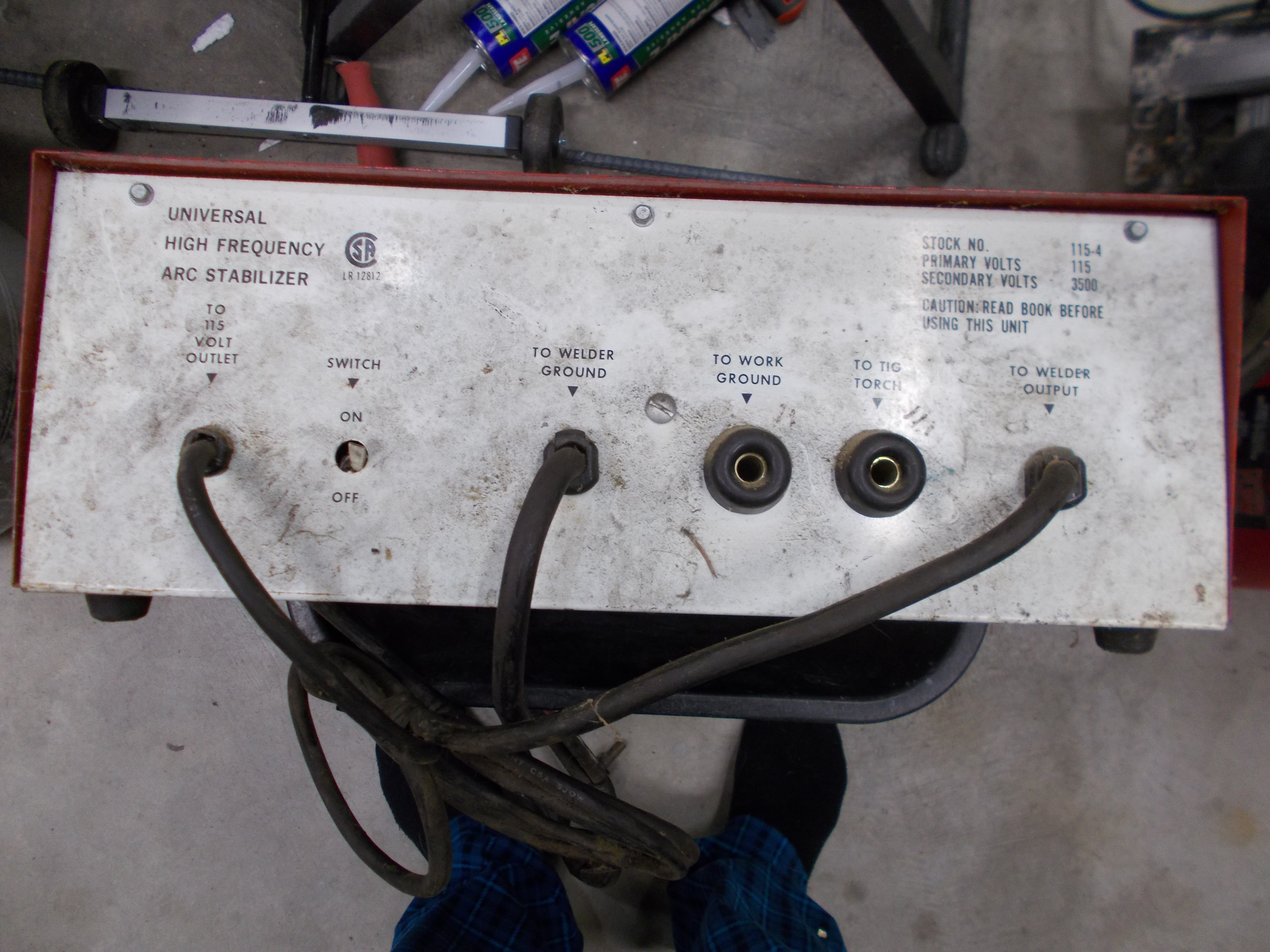

Does anyone recognize this unit? The manufacturers name plate is worn illegible, I need to get a manual for it. Ron

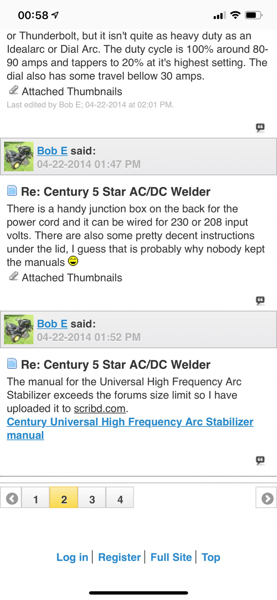

Bob E posted a copy to scribd.

I've used that model before, not really much you would need the manual for. Plug it in, hook it to a welder, turn it on and weld with it.
I wasn't very impressed with the unit I used, it didn't have as much spark as the miller version. I've used 3 of the miller ones and they will light up very reliably.

Mark, I picked the unit up at the auction along with a MW AC/DC 230A welder for 15$. No one else bid on it. Complete with TIG torch and regulator, cables and hose. Hope it works. I don't have a clue on TIG welding. Either learn or sell it after I make sure it works. Might need to see Carl about it.

Thanks for all the help on this. Yes, confirmed as a Century unit. For those who do not know Century is a branch of Lincoln Electric. Have an inquiry to them now to see if there is a better rendition of the manual.
New question, I do not have argon but have CO2. From my ancient pipefitter memory, seems like CO2 can be used for SS and mild steel, is that true? I want to try it out after I get it cleaned up, the arc gap checked/adjusted, and a new power switch installed.

Co2 will not work for tig, you do need Argon.

You really don't want to contaminate your tig torch with CO2. And if you strike an arc it will fry the tungsten. No tig welding without Argon or Helium. Good luck !!
