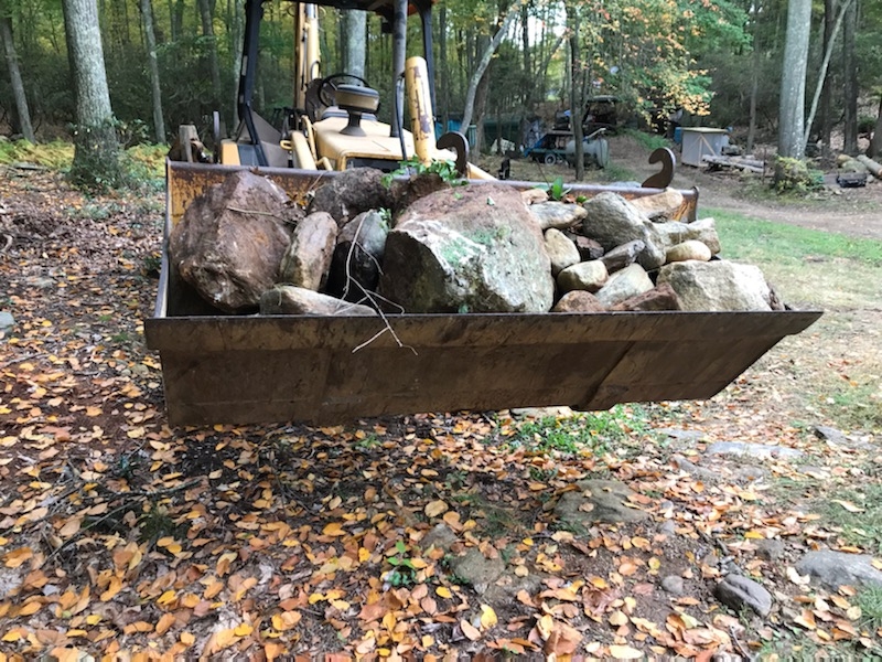

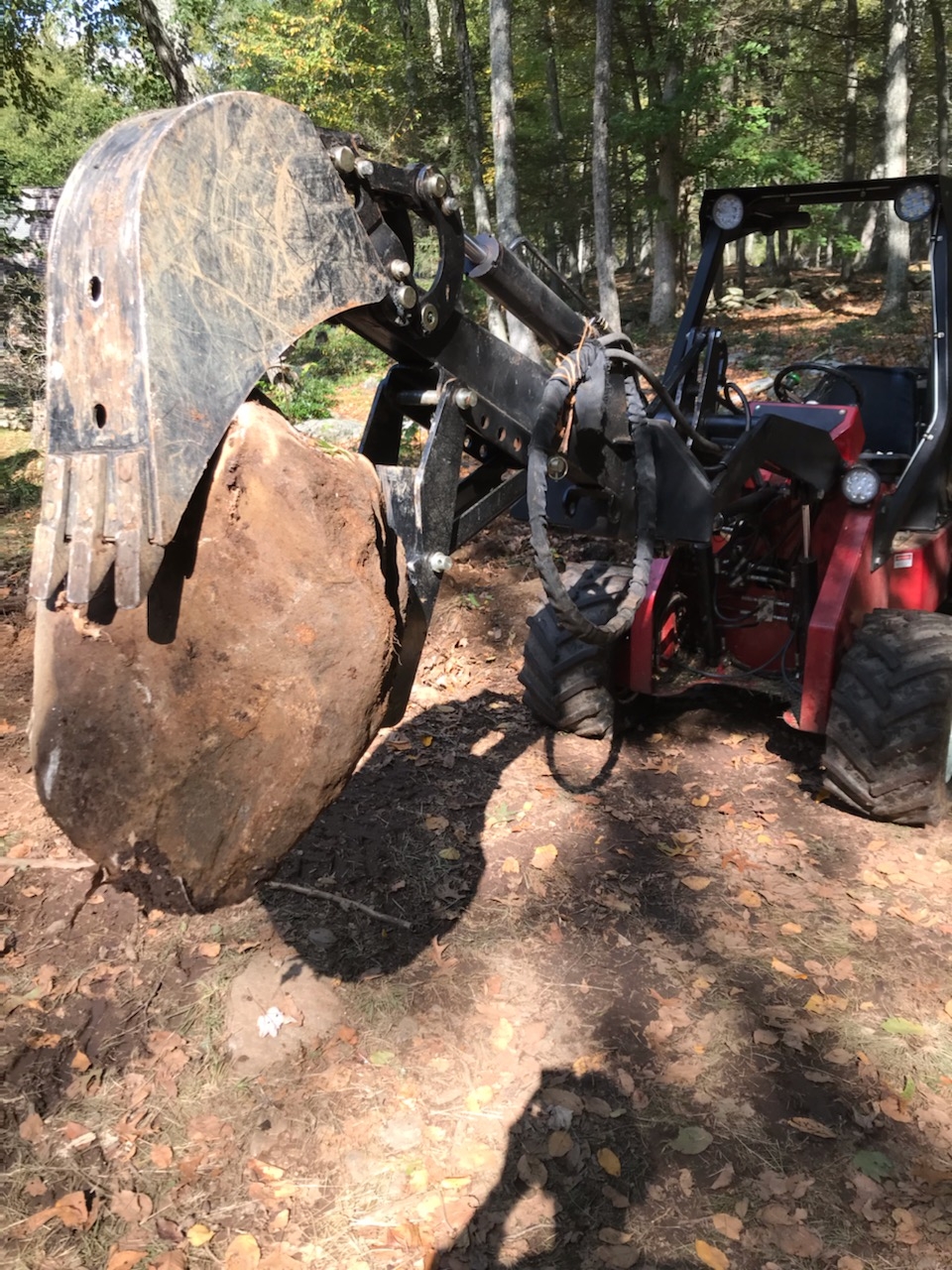

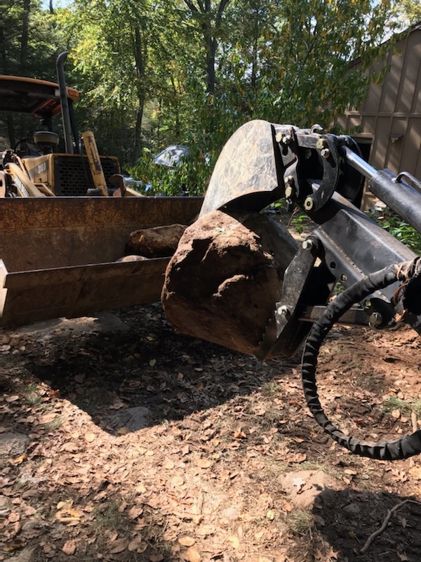

I want to know where are all the rocks????!!!!
   / Hillside brush cutting power and stability 425/1430/1445 #40
Well if your family farmed the same spot for five or six hundred years it gives you lots of time to pick them and move them to build foundations and roads... You are clearly making a great start on yours!
