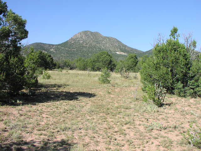

We are planning on building a hillside house also, on this land (attached photo) in New Mexico. The slope faces south, and water runoff will not likely be a problem for us. We hope to build with ICF's but are still in the wishful thinking and trying to figure out what we really want stage.
