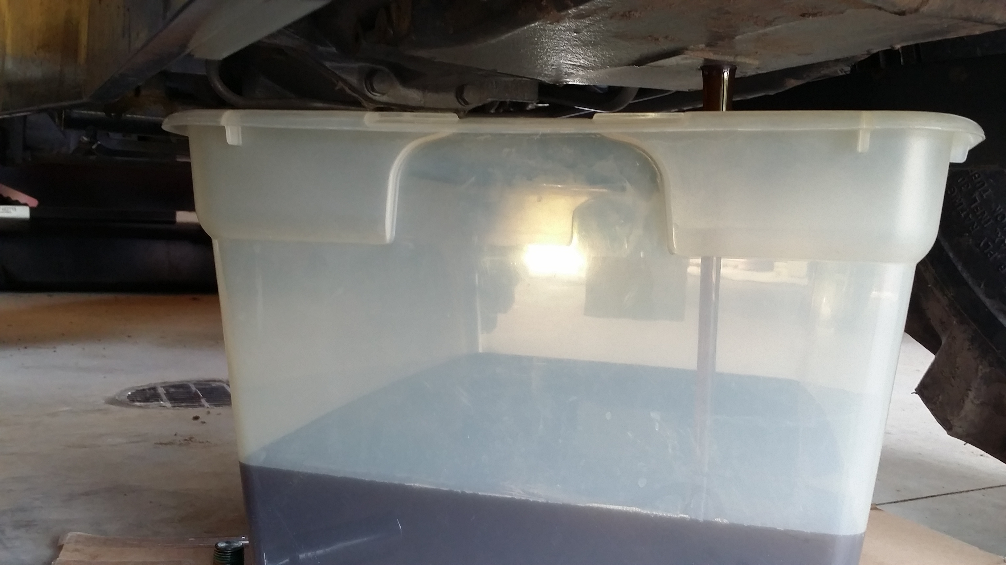

   / Hiow do you change oil and hydraulic fluid without a mess? #34
Any time I come across a big carboard box, I cut the tape seams (for easy flat storage) and put it aside for use during fluid change projects. On the hydrostatic tractor, I use a large plastic storage bin to catch the used fluid.
   / Hiow do you change oil and hydraulic fluid without a mess? #35
The filter, always the filter. That's where I seem to spill the most. I either spill it directly or onto the side of the engine and it drips down later. Only one vehicle has the filter vertical towards the bottom of the engine.
