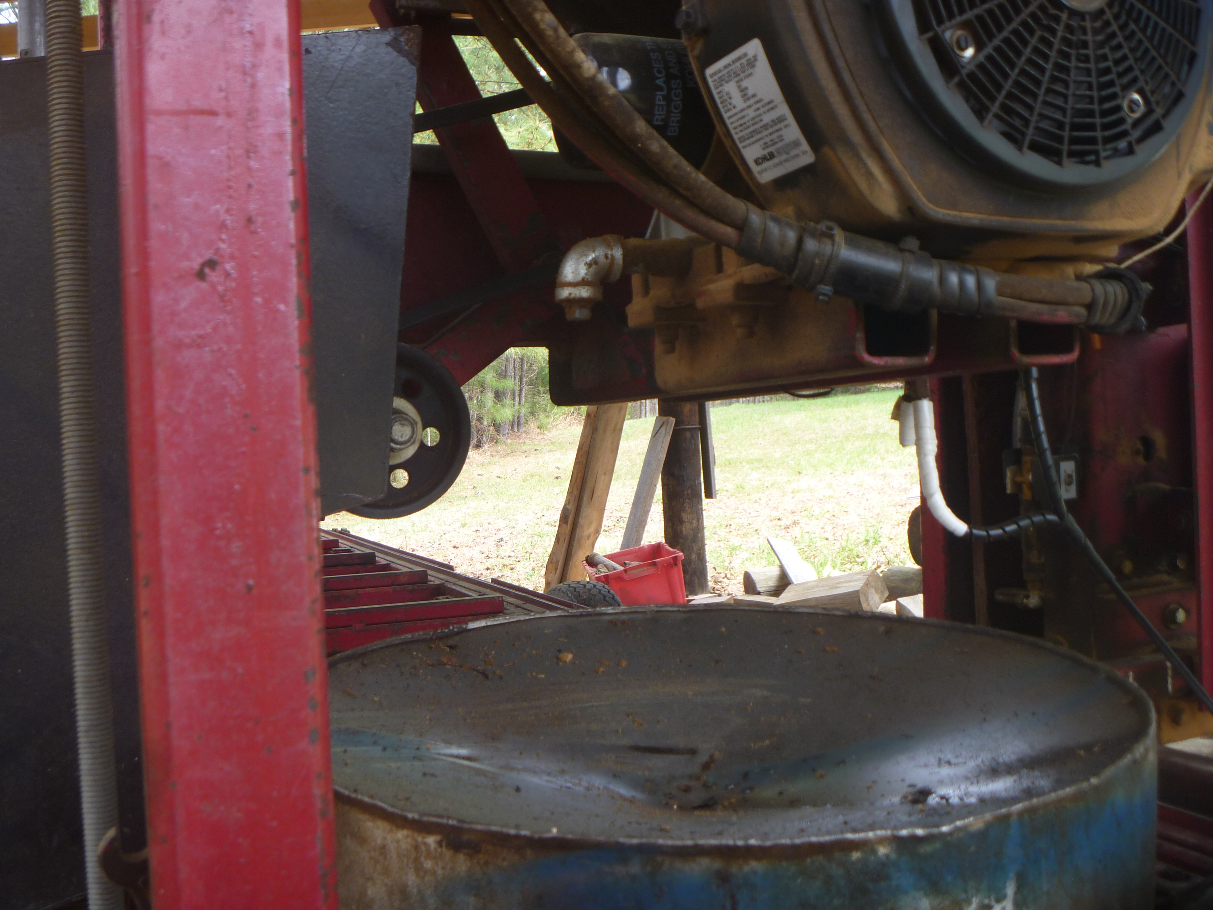

Here's what I do on my sawmill (may or may not be helpful in your situation). I put a right angle elbow in place of the drain plug. It drains the oil into a conical top container.
I have something similar on our mower. I have screwdriver operated ball valve between the elbow and the crankcase.

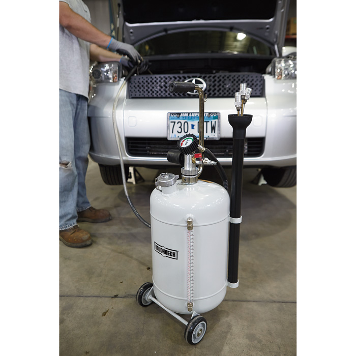

I have been sucking it out then taking the drain plug out for years now. Takes longer, but you just plug the air in and walk away. I have one like this that i use for coolant and a larger one we use for oils.oil ex.jpg
