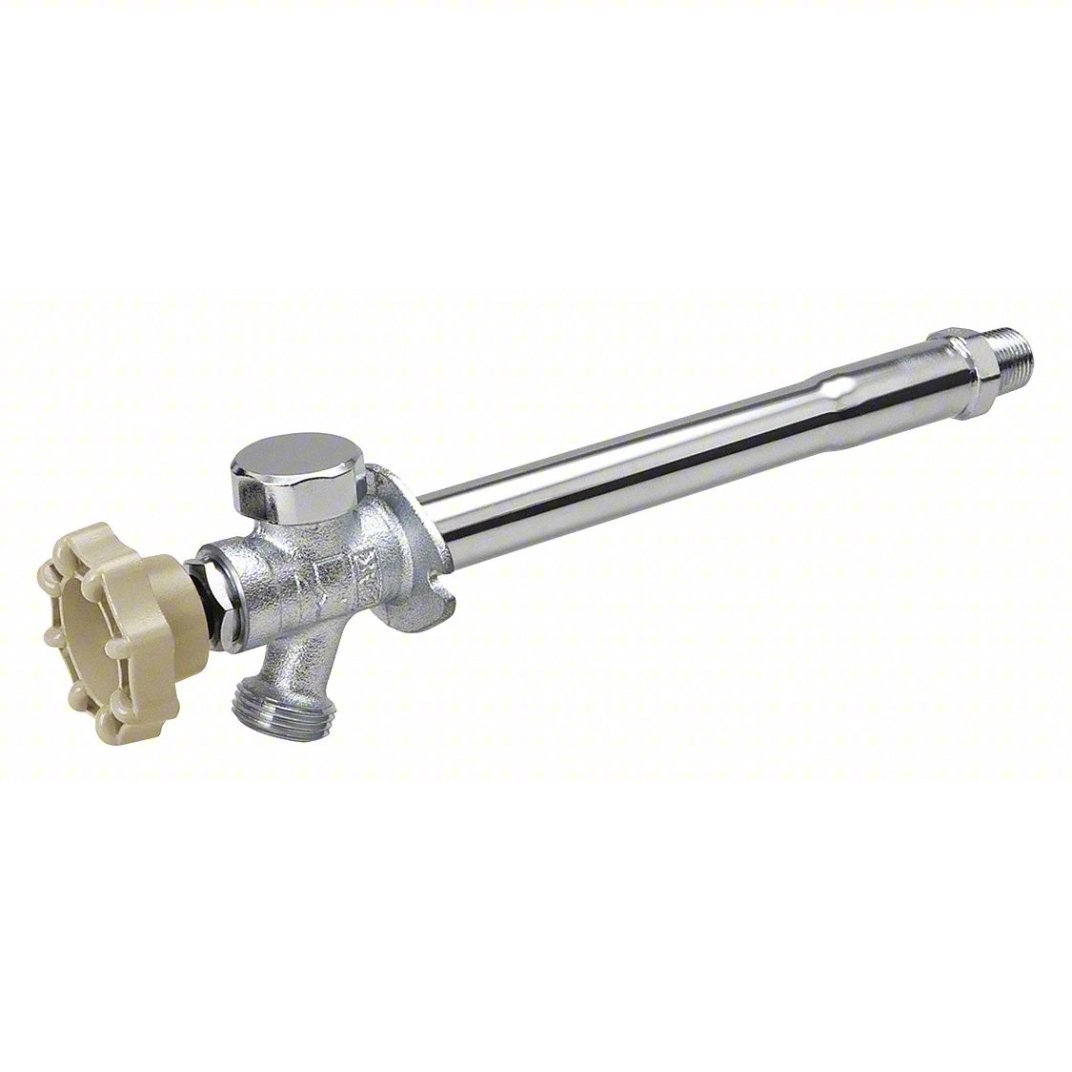

We use these, water is shut off in the heated area of the house.
They are great when the inside end is in a heated space, which might work for some, but isn't likely to work when the inside is in an unheated garage up north.
Speaking from personal experience they also aren't infallible when you get even farther north below -10F or so, as the inner end can get down to below 32F. In one house we had to put on outside styrofoam caps on ours to keep them warm enough to prevent the inside pipe from getting damaged, and another got indoor heat tape.
I prefer to have spigots/faucets like these to have an indoor shutoffs so that they can be completely drained when the outside drops to near or below 32F. That may sound belt and suspenders, but I have experienced these freezing, and the home builder didn't always ensure that inner end is readily accessible.
All the best,
Peter
If you've got a water line in an unheated garage up here, you've got a bigger issue than just what kind of spigot you have. That line needs to be shut off and drained for the winter. We have an internal heater in the line feeding the upstairs room in our garage. It runs inside the pipe from the second floor down to several feet underground. Even with that, we drain the line for the winter. The last thing I want to deal with if we get a power outage in the winter is draining that line, or wasting generator capacity and fuel keeping it heated.
