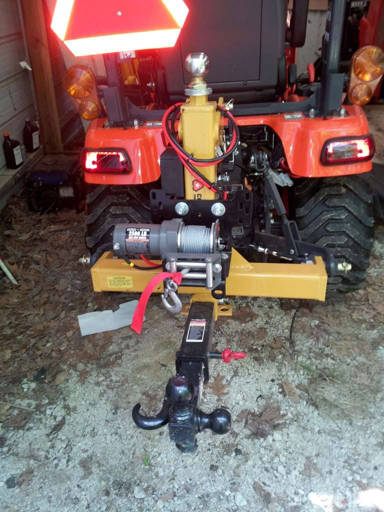

If spending quality time in the mud you may want to add some mods

Check out the “Heavy Hitch “ line of receiver hitch stuff for ideas.
I have one but don’t hardly use it since I welded a receiver hitch tube on my quick hitch.
There is one difference in use to be aware of.
The three point doesn’t have down pressure and will lift easily up.
A car or truck and a tractor drawbar are mounted solidly.
Moving something that is heavy on the other end (tail heavy) can cause the 3 point to fly up.
You can chain it down to prevent that.

Yeah, I made one about 5 years ago. I used it about 2 times to move a trailer. I tried to use it as a low pulling point a few times. That didn't take long to rethink that idea. :oops:
