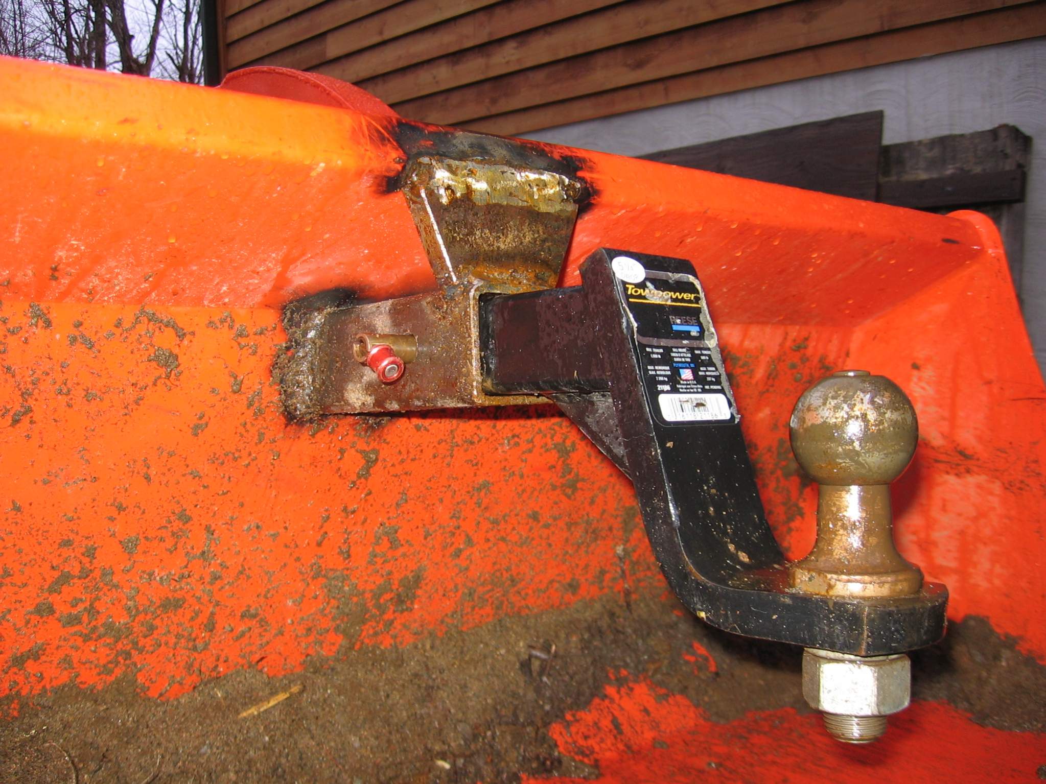

This has worked well for me and does not get in the way of a tooth bar. I very rarely remove this even when loading gravel or dirt. Sitting higher, it is also much easier to see from the seat of the tractor than if it were on the bottom.
Good luck

OK, here are the photos of my new receiver hitch welded onto my BX25 bucket. I just need to paint it now, so my brand new tractor looks pretty again!
