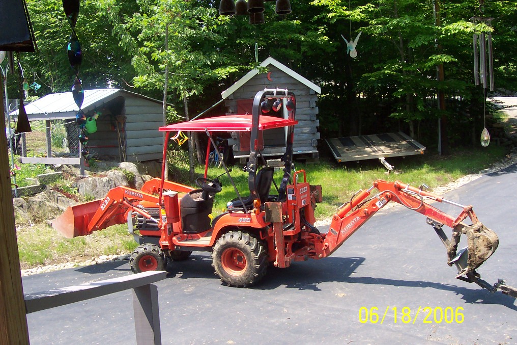

I am still working on a desighn to put one on my trackhoe. I have put one on the front of my Truckster. It is really handy. I have a Reese type on my ZTR also. It is the first machine I can actually back a 4 wheel wagon with.

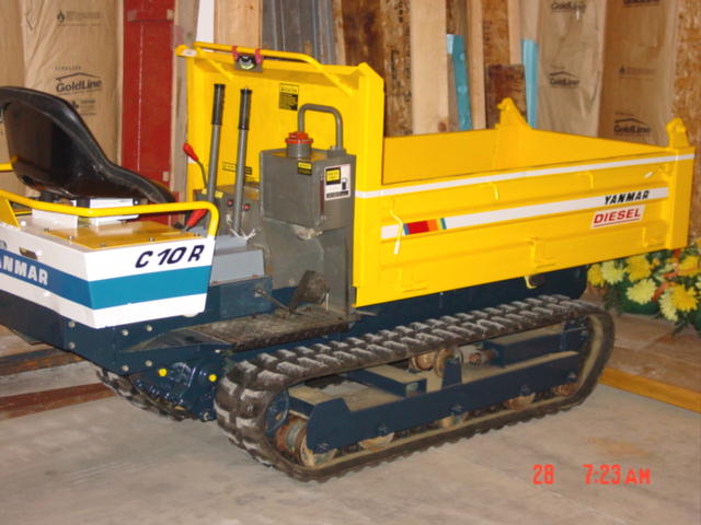

Kays Supply ; What is that called.... a tracked dump box ? Sure looks neat. How much does it haul and is it fairly fast ? Who builds them ?

That is a Yanmar C-10 Dumpster. It is the smallest one they make. It isn't the fastest. I use it to haul dirt out of slabs when I dig in the plumbing. It has worked very well for me. It is slow enough that my hired help don't do much damage to the property. I wish I had a dozen. I have people ask about it almost every time I hit the road. It is also very handy around the house. I keep it here to do yard work.

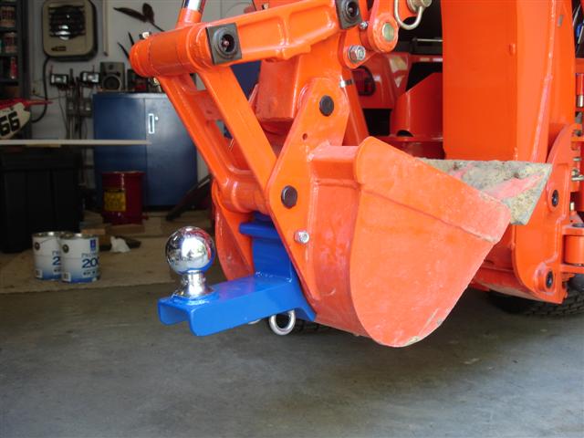

/ Hitch on your backhoe #20
It works well, though when pulling hard with my bx24 the dipper stick will swing out a bit given the play in the whole backhoe assembly - not a big deal. Hitching up is a breeze as you would imagine. It allows me to park the boat in a tough location in our yard - the articulation of the backhoe blows away towing with your fel and towing forward feels more natural (have also made an assembly for the fel which I'll post later). You have to watch the lateral force on the tractor when turning uphill or down though that is remedied by swinging the boom. Hopefully the pictures will attach - I used the two existing 7/16" holes on the sides of the bucket (the port one is used to clamp the lower bucket pin) and the curved blue base plate extends up beyond the bolt keeping the hitch unit clamped against the bucket. The stem is welded to the "c" channel and the ball is interchangable. Very simple design - off and on in a minute - the 6" x 7/16" bolt is reinstalled when the unit is removed, and the unit stores under the backhoe platform. Toughest part was bending the 3/8" backing plate.
