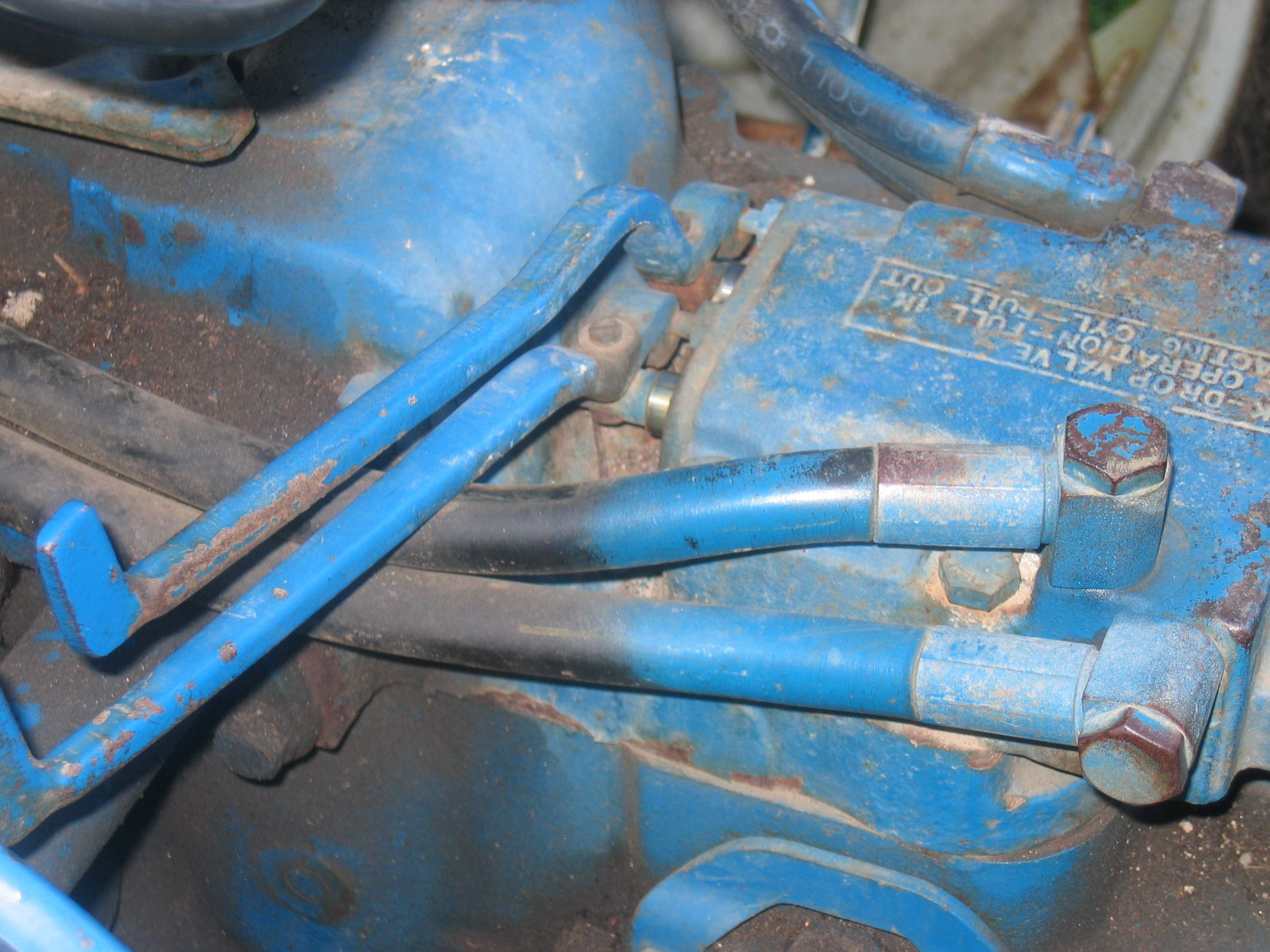

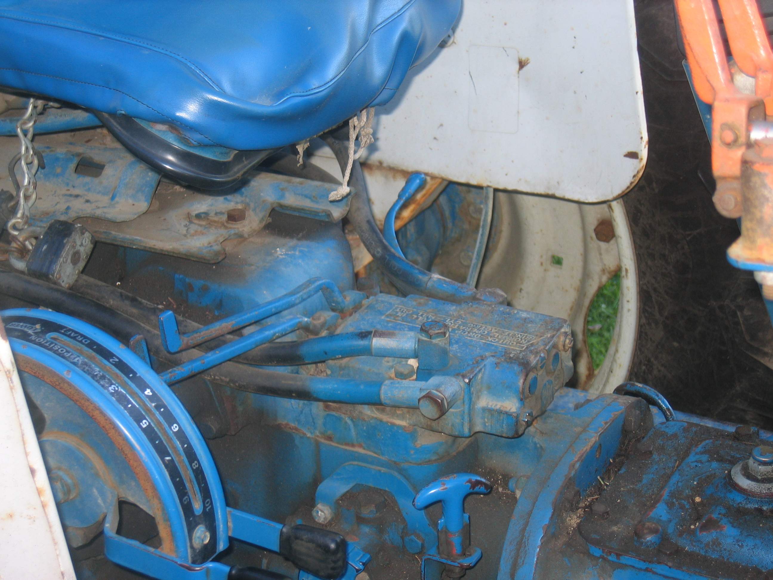

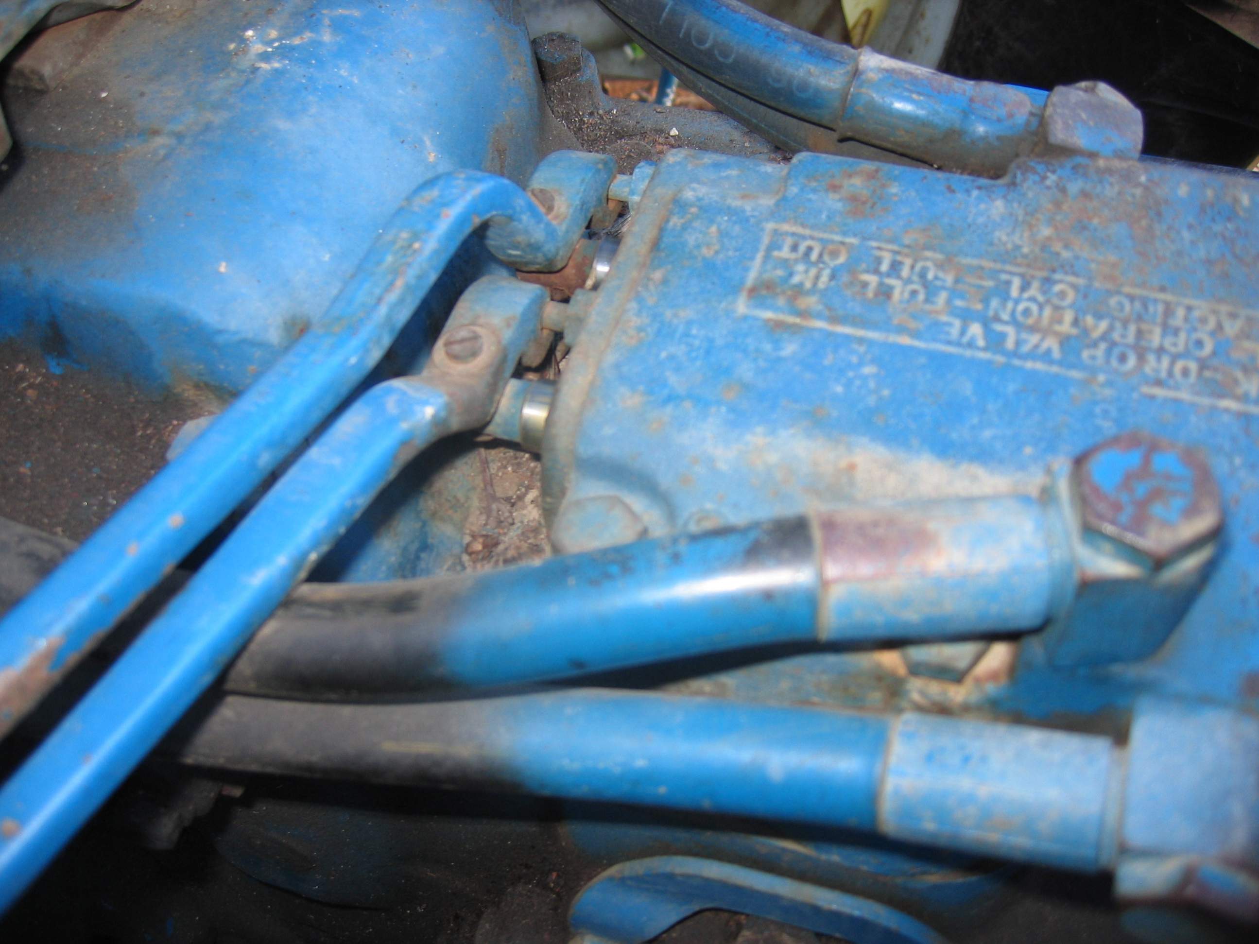

ok everyone. soundguy is the man. there is an asc(i think it is anyway) under the seat of the tractor one valve runs the bucket the other is the hitch!! i had a friend who knows tractors way better than i do look at it and needless to say he called me a few friendly but earned names!! lol (dumba@@ being the main one!!) i have some pictures of the valves under the seat and they must be in the neutral position or the hitch wont work. thank you all for helping another dumba@@ newbie fumble his way around a tractor!!! lol:eek:
