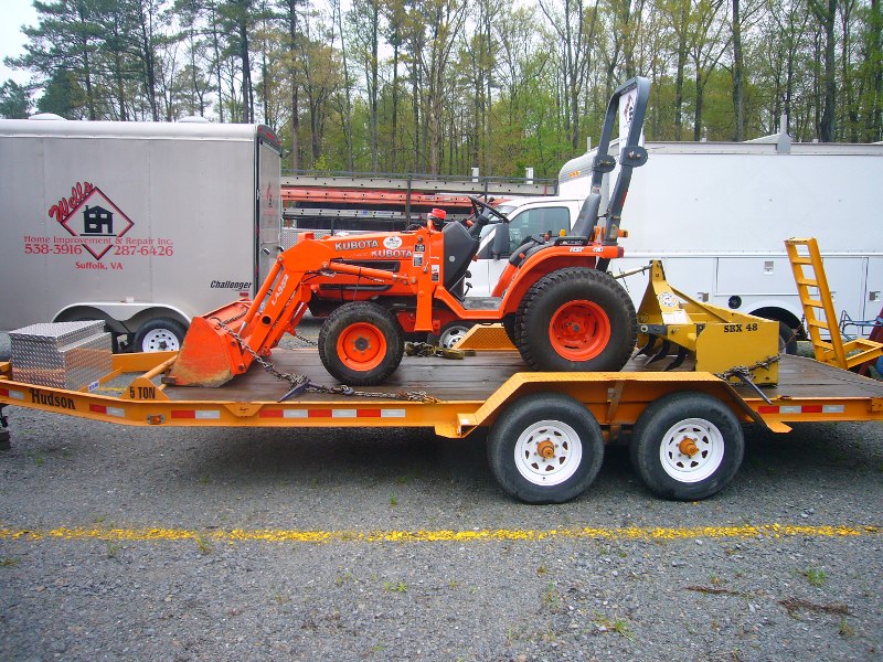

My first tractor was advertised on CL as a Kabota B7610 (in 2009). Which is basically the same size as the 2320.
450824d1450361402-hitch-question-tractor-015small-jpg

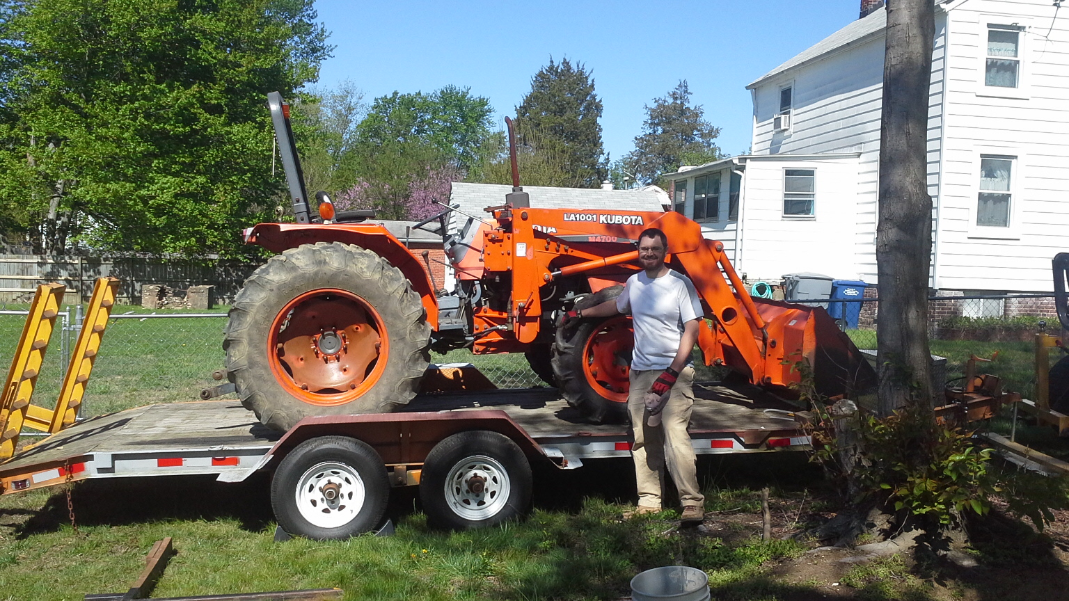

The Kubota B7610 is the size I needed for maintaining narrow trails. To make those trails I needed more lift capacity and got an M4700.
When I bought the B7610 it came with a 12K trailer, 16+2 feet w/ 78 inches between the fenders. When I bought the M4700 it was about 84 inches wide.
Luckily I was able to narrow the wheelbase.
450825d1450361512-hitch-question-20140427_103025-jpg
So since you have not bought the trailer or tractor yet GO BIGGER if you can park it. I can barely squeeze my Hudson trailer, 24' overall, into my 2 car suburban concrete driveway. Fit's fine in my workshops in Mississippi :)

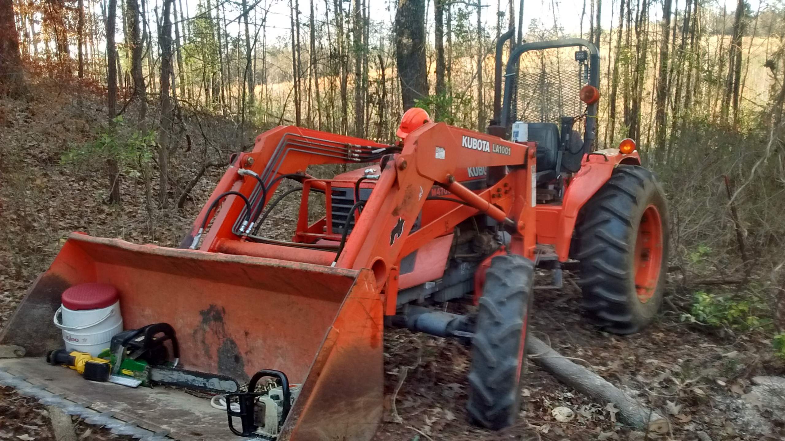

A few feet more for the trailer should be your minimum unless you have parking problems. and a 30HP PTO plus tractor is minimal for a forestry operation.
$2 HP isn't bad either :)
450826d1450361828-hitch-question-img_20151207_150524186_hdr-jpg
more room in the bucket for saws.

That reads a lot like my situation. I've about 73 acres around the house and about 250 acres spread out over 4 parcels in the county. On one of them the hunters have managed to make a fair logging road totally impassable with their ATV's, even to them. Ruts 6 feet deep and 6 feet wide at the top and shaped like a V. I'e got to cut different paths around in order to set up some food plots by water.
The last picture of my M4700 was when I was in the woods two weeks ago "blazing" a path. I had to haul out some small trees of about 6 inches DBH. I could have done it with my B7610 but I would have had to cut them up into short sections, versus dragging the whole tree with just a little delimbing.
And if you are going to use ground engaging equipment for food plots you'll want more HP than the B2320.
