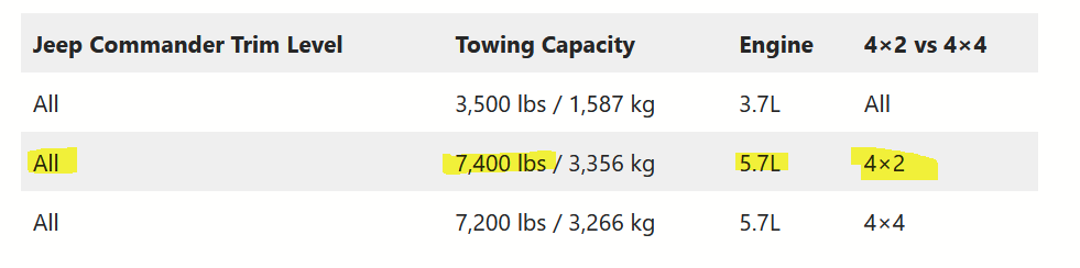

Jeep Commander with the 5.7L HEMI.
You could see fine over the steering wheel and have the muscle to tow like a RAM 2500.
