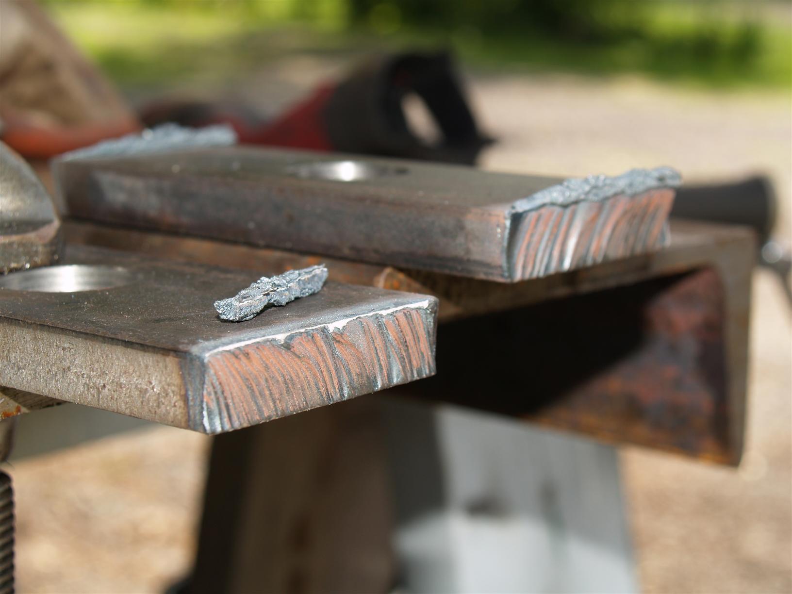

$800 for a $1700 machine that is six months old and you want to talk him down? That is an awesome machine for that price. If it is only 6 months old he probably still has the receipt.
It is in the 40 amp range of plasma cutters. Maybe cut 3/8 in.
You can cut 1", you wont get a nice FLAT cut (it will be concave), but you will get a clean cut. You will breeze through 1/2" no problem. I get pretty good cuts on 3/4" with my Powermax 600 (a 40 AMP machine). Just knock the slag off with a hammer. I still need to grind if I want to remove the torch marks. Finding the right hand speed, and then getting nice smooth movement is key, something I'm not always able to do.
I will say this, I wish I had a bandsaw instead of my plasma. While I have used my plasma to cut angle and tube, you just can't do as nice a cut as a bandsaw will do. The plasma is great for flat bar and sheet, but if you want to cut a lot of tube and angle a bandsaw will be a better purchase.
