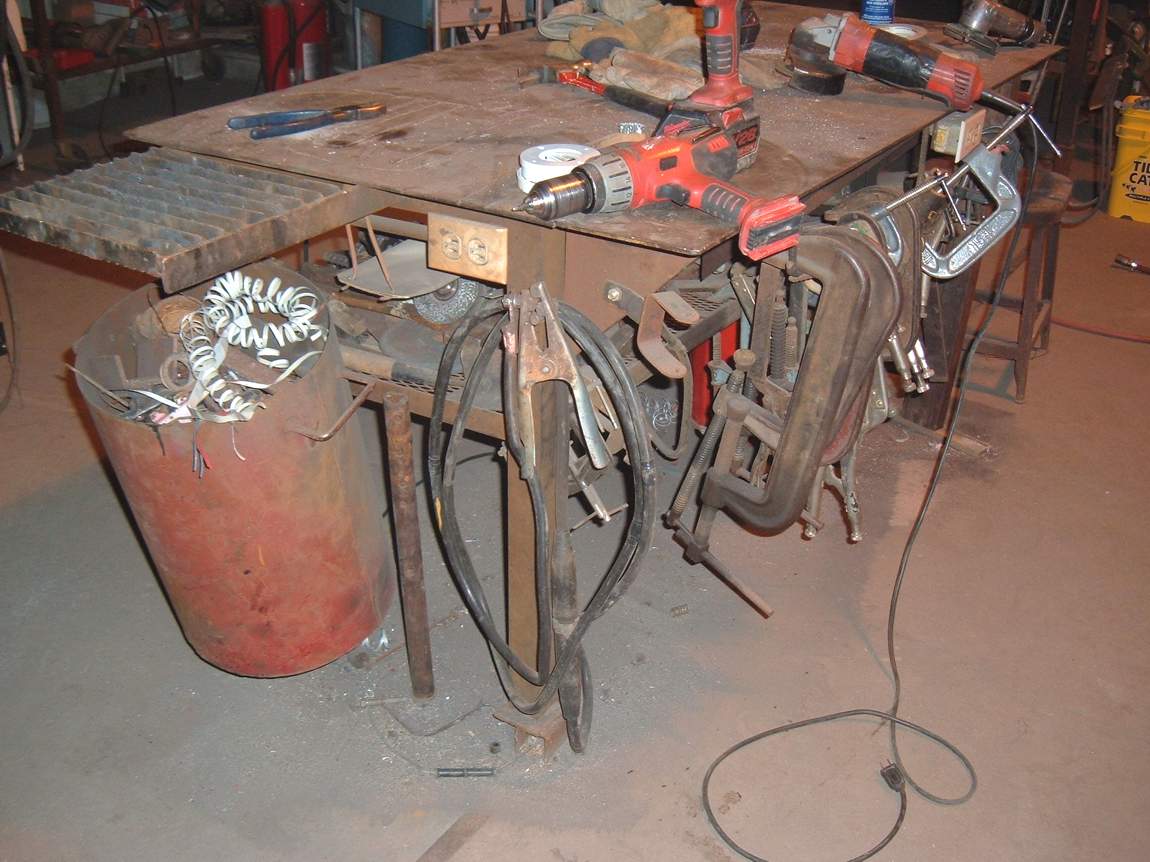

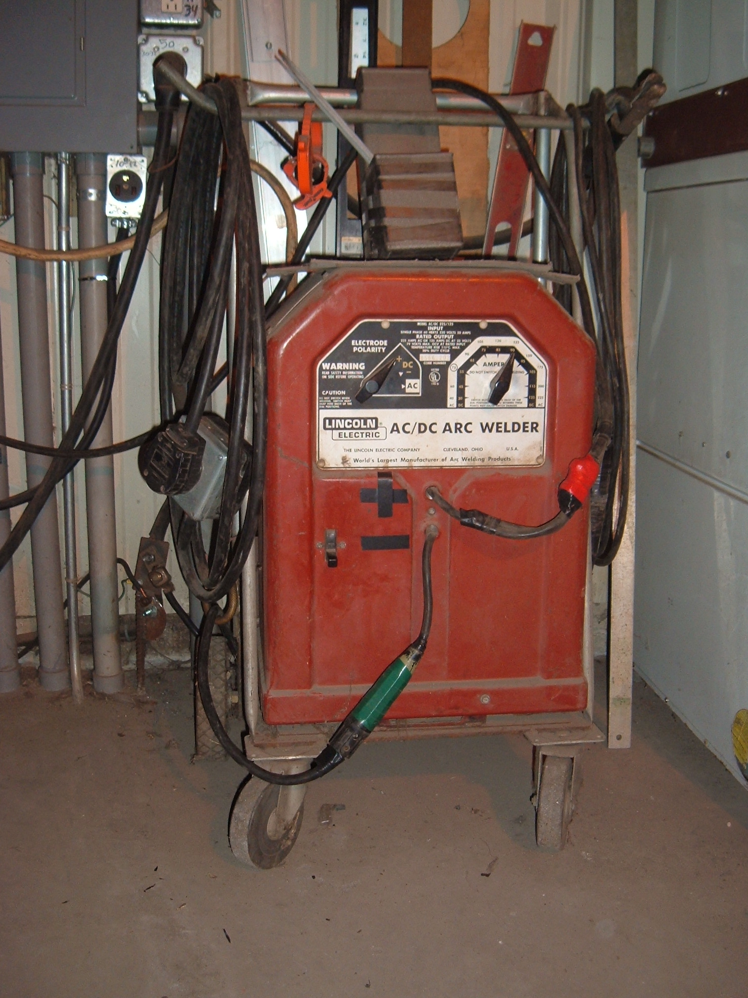

More later.

hey thanks, always a better deal out yonder but given the market & budget, will give stickmate a try.
if i had to make a living arc welding, i'd starve. for now, glad for the upgrade over the old school lincoln best regards
You will find a DC Stickmate a big improvement over an AC buzzer. Get 3 electrodes, 1/8 6011, 3/32 7018 and 1/8 7018. I havnt metered the Hobarts settings, my red one is really hot. But 92A for the 11 and the small 18 and about 115 for the 1/8 7018. I realize there are LOTS of other rods in the world but a guy can do it with these and all we stock anymore.
Something else to consider here is,,, they make bigger machines but not really better. I run mine next to my Maxstar, a Synch and whatever the machines was at a power house I was on at the time I bought it and if you couldnt see or hear it wouldnt be able to tell them apart with the stinger end with general fab work. The Max has a safty start feature makes restarts a bit touchier but I give the buzzer as good or better mark than the Max. They are really really good and run way past their rated duty cycle.
