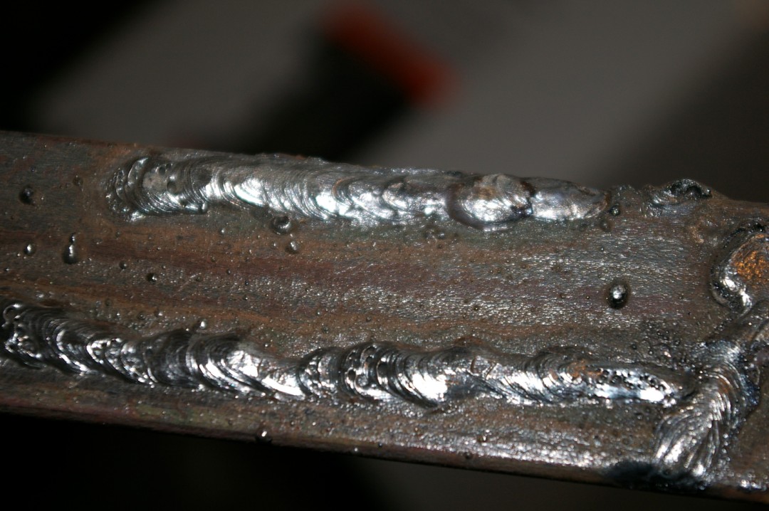

TSC had them on sale and I picked one up for $348.00 because they said they aren't carrying them anymore. So I picked one up and bought some 6011 and 7018 rods. I was welding at about 100 amps dc+. I am open to criticism of these poor welds. Too fast? Not enough juice. Too close?? Too far. I have a 110 lincoln mig and make good welds but it is soooo slow......... I don't think I would hang from these welds where my life was in danger. What are your opinions??

It looks as if your travel speed is not consistent... too fast at some points, and too slow in others.
Watch the puddle, not the arc... the puddle will dictate your travel speed. Keep your puddle "round", about the diameter of the width of your bead... if you see your puddle getting oblong along your path of travel, you're travelling too fast. If it's getting oblong across your path of travel (getting wide), you're going too slow.
/ Hobart stickmate LX #3
I agree with XL.But also,it could be your arc length has something to do with it.
6011 rods are kind of tough to make a real nice looking bead with unless you have a lot of expertise,7018's run smoother.But every rod has its purpose.
Something else....as far as porosity in the weld beads,rusty metal will cause this.6011 will generally cut thru rust and paint with no problem,but if possible the metal should be cleaned as much as possible first.
Just keep practicing guy,you'll get it:D .......Digger2

You are moving too fast and have 0 penetration.It looks like you can not really "see" the weld pool. It's like the old Carnegie hall joke... Practice ,Practice ,practice.and an auto-darkening helmet would probably help a great deal also.

Not horrible...seems my first beads looked worse.Try a little more weaving back and forth and you might try some 6013 rod.They have become my all purpose rod around here and I almost gave up trying to weld until I bought the autodarkening helmet.Just noticed the polarity, make sure that you get DC rods!! The double duty (AC/DC) rods are not the best for DC welding.

Many good replies. Beginner in anything takes practice, along with a little knowledge. I'd suggest going to your local bookstore and buying a Basic Arc Welding handbook.
When I was an instructor the first thing we taught was how to "strike an arc", then progressed to "stringing beads". After theses steps were mastered, then we'd advance to actual weld joints.
One poster mentioned "watching the bead (actually it's called the puddle, not being sarcastic, just attempting to help you with the nomenclature of welding). The puddle is important as it will dictate amperage, arc length, and speed of travel. One poster recommended an auto darkening helmet. I'm recommended a "Gold Plated" lens. Not expensive at all from a local welding house. Eliminates the green glare, and you'd be surprised how well you can see the puddle. I'll never go back to a straight green lens. Been using the gold coated ones for years.
A good rule of thumb on arc length (the distance you hold the rod from the base metal) is rod diameter. 1/8" electrode, hold the arc at about 1/8". Electrode should be tilted about 10-15 degrees toward the direction of travel in the flat position.
Clean, clean, clean. Clean your base metal prior to welding. Not always possible if the weld joint is recessed, in a corner, etc. But, if it can be cleaned by grinding/brushing, do so. Even "new" steel has an oxide layer that should be removed prior to welding.
We used 6010 and 6011 electrodes for the string beads classes. They do require electrode manipulation (whipping back and forth to build up the desired bead height). 7018 rods are great to use. Lots of folks like the 6013. I tend to stay away from them because they are generally used on poor fit up, and have shallow penetration. When practicing, if your are using thin steel, watch for heat build up. If your practice metal gets hot your beads will change dramatically. For practicing purposes, quench after each weld.

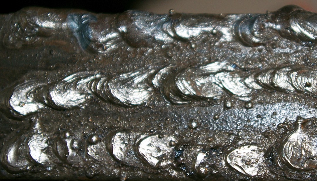

Just got home from work and ran a couple more beads. They look a little better to me. What do the pros have to say? I'm used to criticism...I'm married..

Your beads look much better than mine but all I had to work with were the tiny rods that came with my worthless walmart stick welder that this replaces...

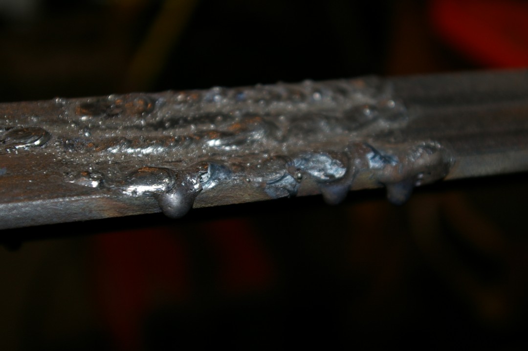

Thanks for all the replies. I have still have some questions as to why i would want to use a deep penetration rod EX 6011 VS a 7018 which is a low penetration rod. I thought deep penetration is good on all welding projects. Why would I want low or med??? Here are some pics of my 3 rd day welding. I 'm sure they would all hold but which weld is the best??? Thanks for your insight....

My problems are holdng a 2-3mm arc gap consistently and moving at a slow, even pace. I'm getting better now. When a pay attention to the edge of the weld puddle to make sure it's tying into the base metal evenly, then my welds are pretty good.
There are many variables depending on the desired end result. I can't recall exactly where I was taught the five basic principles (other than having clean rust free and grease free and paint free material) of:
1: The current setting
2: The length of arc
3: The angle of electrode
4: The approach or manipulation of electrode
5: The speed of travel...
Those are not principles that I can take credit for, but principles taught in classes and in books. As in most things, if you have the core basics down pat, the rest will come easy...or relatively easy. I still hate overhead welding. I've caught too many portions of my body and clothing on fire from doing that than anything else in my life! :eek:
Fortunately, as I mentioned previously, new welders come with charts on them that give pretty darn good advice as to the current setting suggested for different rods on different thicknesses of materials. The other items are just learned through practice to where they come as second nature and you don't ever even think about them.
And, to no surprise, not only are different types of welding a bit different (mig, tig, arc, brazing etc.), but many types of metal weld differently and you have to adjust your procedure to them. Seriously, try some 6013 rods on reverse polarity DC for a bit. The rods aren't that cheap. You will be able to lay down a decent bead easier than with most other electrodes. From there, move to different thicknesses of material with the 6013s. Once you feel you have that mastered, move to a 7018 electrode and practice the same. Then go to a 6010 etc. I just suggest the 6013 to start with because it will be the easiest. Then work your way up. When you can lay down a perfect bead, with good penetration, overhead call me. :D
