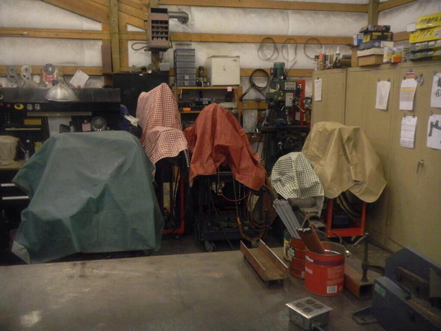

I had a helper like that but someone stole it.
She's bunking down in this guy's shop.
