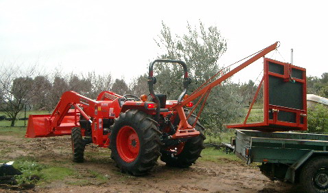

When I started this thread,I never expected so much response. It has all been of interest. The original bent brackets were a result of forces trying to move the lift arms apart. At no time was there any problem with the actual pole part of the project. I have read and noted the comments re stretching and compressing and agree totally.
My modification to the lift brackets was to straighten the brackets and weld a length of angle between the two brackets. Welding the inside of the angle to two sides of the bracket has given it a much greater resistance to bending.
When I originally tried out the pole, I used the end position to pull. On one of the better rooted trees, the lift stopped as the 3ph went into bypass of the hydraulics. Obviously out so far was too much. When I try again, I will be trying the halfway position. I will also try using some of the other ideas such as the v shape to wedge onto the tree and lift via 3ph. When I have a working system I will post pictures.

Actually the bend was caused by the crossbar trying to move forward because of the load on the boom. The lift pins in the flat plate were in shear(bending force) so they bent and the 3PH lift arms accomidated this bend by moving outward easilly.
cityfarma said:
When I originally tried out the pole, I used the end position to pull. On one of the better rooted trees, the lift stopped as the 3ph went into bypass of the hydraulics. Obviously out so far was too much. When I try again, I will be trying the halfway position. I will also try using some of the other ideas such as the v shape to wedge onto the tree and lift via 3ph. When I have a working system I will post pictures.Cityfarma
Even at half boom length, I don't think you will find it too productive. The 3PH lift arms pivot where they attach to the tractor when lifted by the links to the upper lift arms, attached somewhere along their length. This geometry combined with the 3PH piston size and available hydraulic pressure yield a certain lifting force at the end of the lift arms. IF you double the length of the 3PH lift arms, you will half the available lift force(only takes half as much weight to open the 3PH hydraulic safety valve). If you double the arm length again, you will again half the lift force. So an arm 4 times as long yields 1/4 the original lift force. How long is it to the tip of your boom from where the 3PH arms attach to the tractor? Divide this by the length of the lift arms and you will have an idea of the available lift force at the end of your boom pole. Your greatest lift force will be achieved along the bar between the ends of the 3PH lift arms, and in my experience, vertically is the best way to pull out most brush/shrubs/trees.

After an initial failure due to under engineering, I have now finished the pole. The 3ph brackets have been braced and a strap welded along the top.
It was certainly a lot easier unloading the home brew carryall I have also just completed.:) Like most stuff I make, both were mostly recycled material. Work has been having a major equipment upgrade and the steel recycle bin has been a great source of steel. Unfortunately this has just about finished so I may have to buy :( some steel.
I will be building a garage to store the tractor in so I am now working on making some brackets to adapt the pole to the FEL. This will allow me to lift beams and support them while I bolt them in place. I acknowledge the previous posts that mention the reduced load capacity of the FEL with loads way out front. I will only be lifting relatively light loads and supporting them.
Cityfarma
