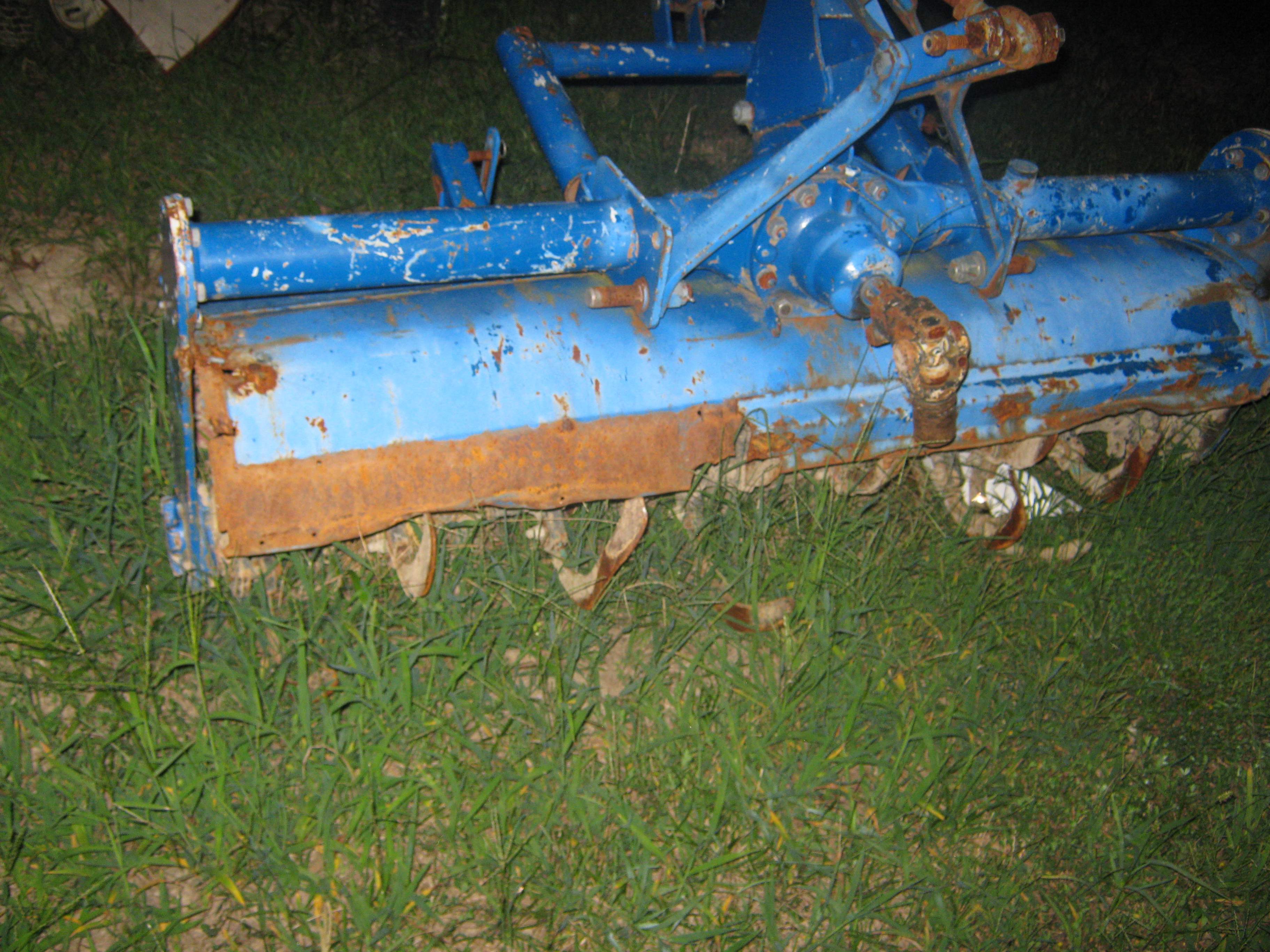

Got a pic? See below...( sorry for the quality, it's kinda late here) That is a $150 47" tiller. I did put tines on it, a dealer in Mo gave me a load of used ones for free! It needs sand blasted and painted but works very well as is. I also have another identicle unit to this one w/ tail wheels.
Never seen a 6' rice tiller. They are usually between 1200-1400MM ( 47-55" approx) but I do know they make larger ones, they just rarely make it over here in containers.
Find a grey market dealer that buys B and c grade tractor. Almost every container tractor comes with a tiller and they are in like condition to the tractor. A seller who is buying the lower grade tractors will have some of these tillers, I guarantee it. There is a seller on ebay that always lists a lot of them in the late winter/spring. He will have some cheap junkers and some nicer units, pretty sure he is located in Calif. I have bought several cheap tillers from Smitty's Tractors in Walnut Hill IL but he has moved into selling heavy equipment almost exclusively so don't know if he could help you or not.
There are 2 grey market dealers down around oxly Mo that used to get some cheap tillers. Can't remember either name off hand..try googling tractor dealers in oxly Mo area. Used to be lots of dealers on the west coast ( heck, everywhere for that matter)...do some searches for them. Hope this helps.
