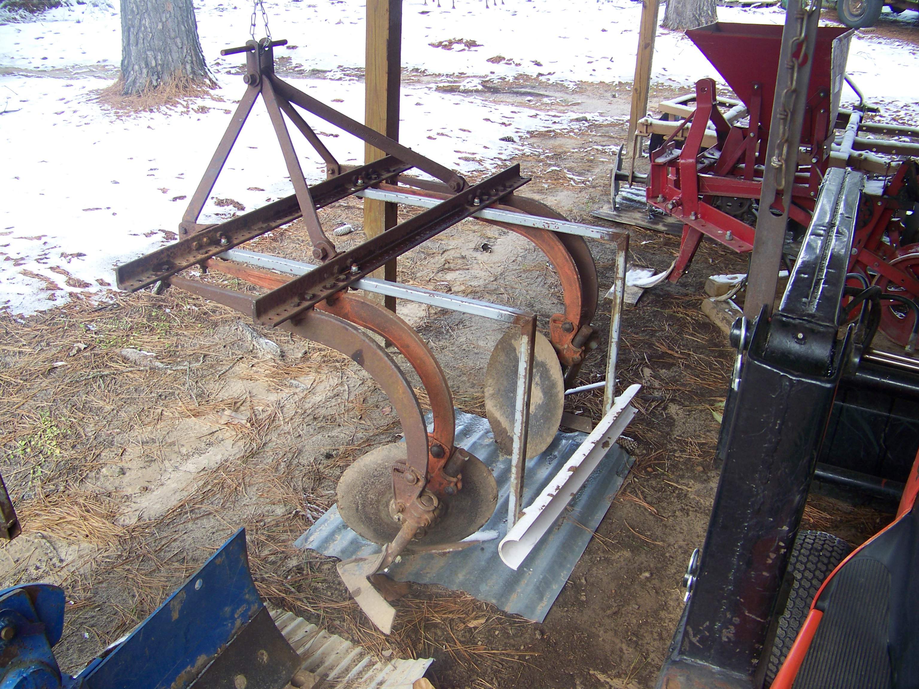

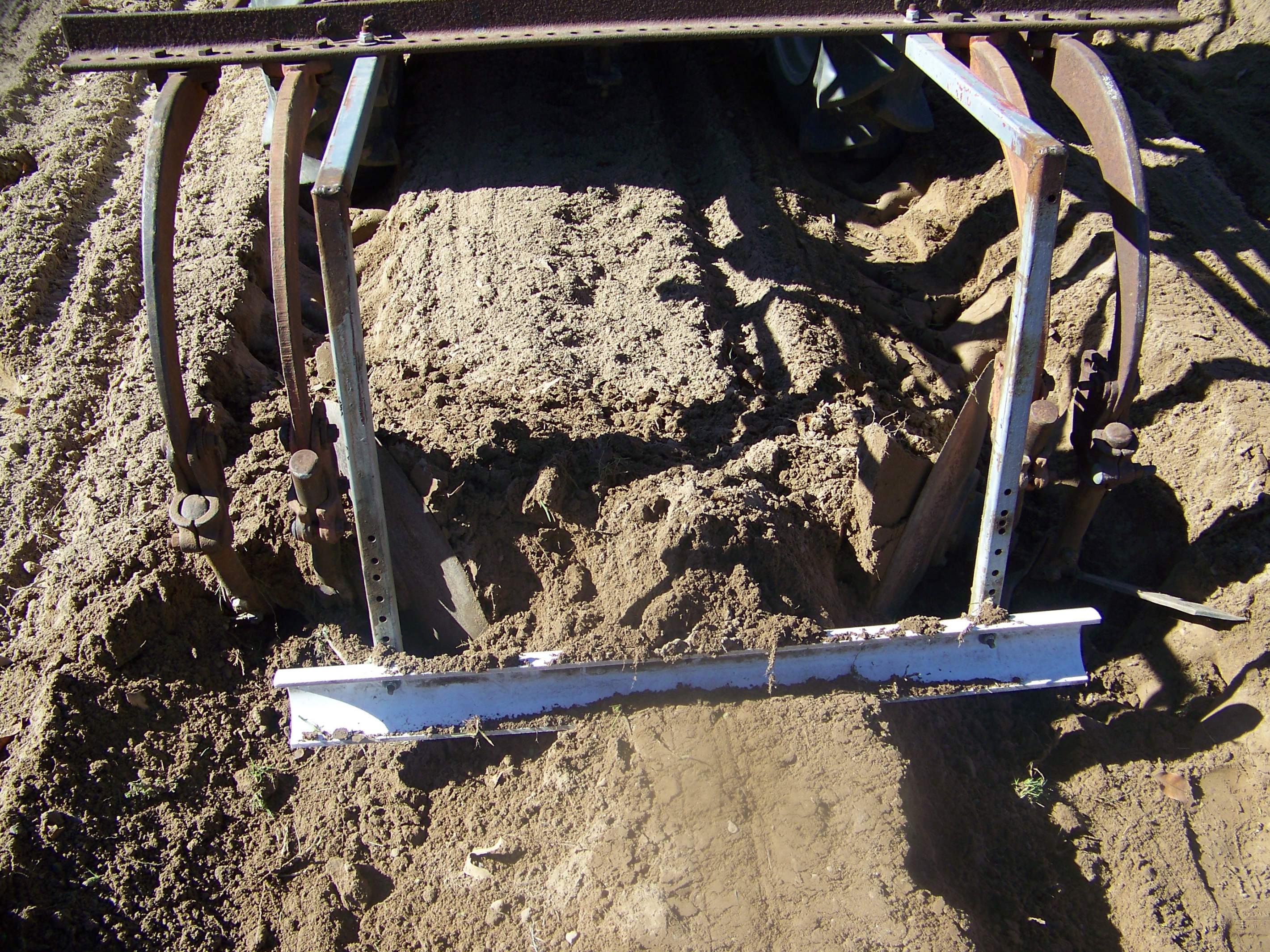

100_5850.jpgHere it is. 100_5752.jpg Split piece of 4" pvc pipe.
Raised beds could definitely have value in irrigating like cardoc does. Also value against flooding if you have that problem. My thinking is they have value with root crops because they make for a deeper bed of loose dirt. Just my thinking. I have planted most any crop in raised beds but really don't think they are necessary with peas, beans, etc, unless irrigating. Just an opinion, I'm sure not the master farmer.

My main goal for the hillers is to mound up two 50' long hills for planting sweet potatoes. That's a big job I won't miss doing by hand! I tried to arrange my garden so that I can use the cultivator to do weeding.
The flattened hills are what farmers call "raised beds" right? What sort of crops do you plant there? I would think carrots would be a great fit.

Thanks Winston glad you chimed in saved me searching for those pics. I like that setup like Ive said before its so simple yet functional I hope I can come close building one! :thumbsup:
