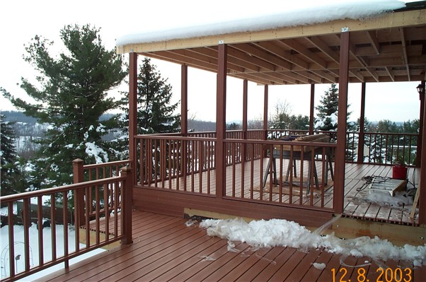

EON is another option. It is a plastic deck that looks like wood and requires no maintenance. I bought my materials at Home Depot and so far I am very satisfied.
The attached picture was taken in December. The deck and porch are now finished. Including the stair area the overall size is 40 foot by 18 foot.
John
