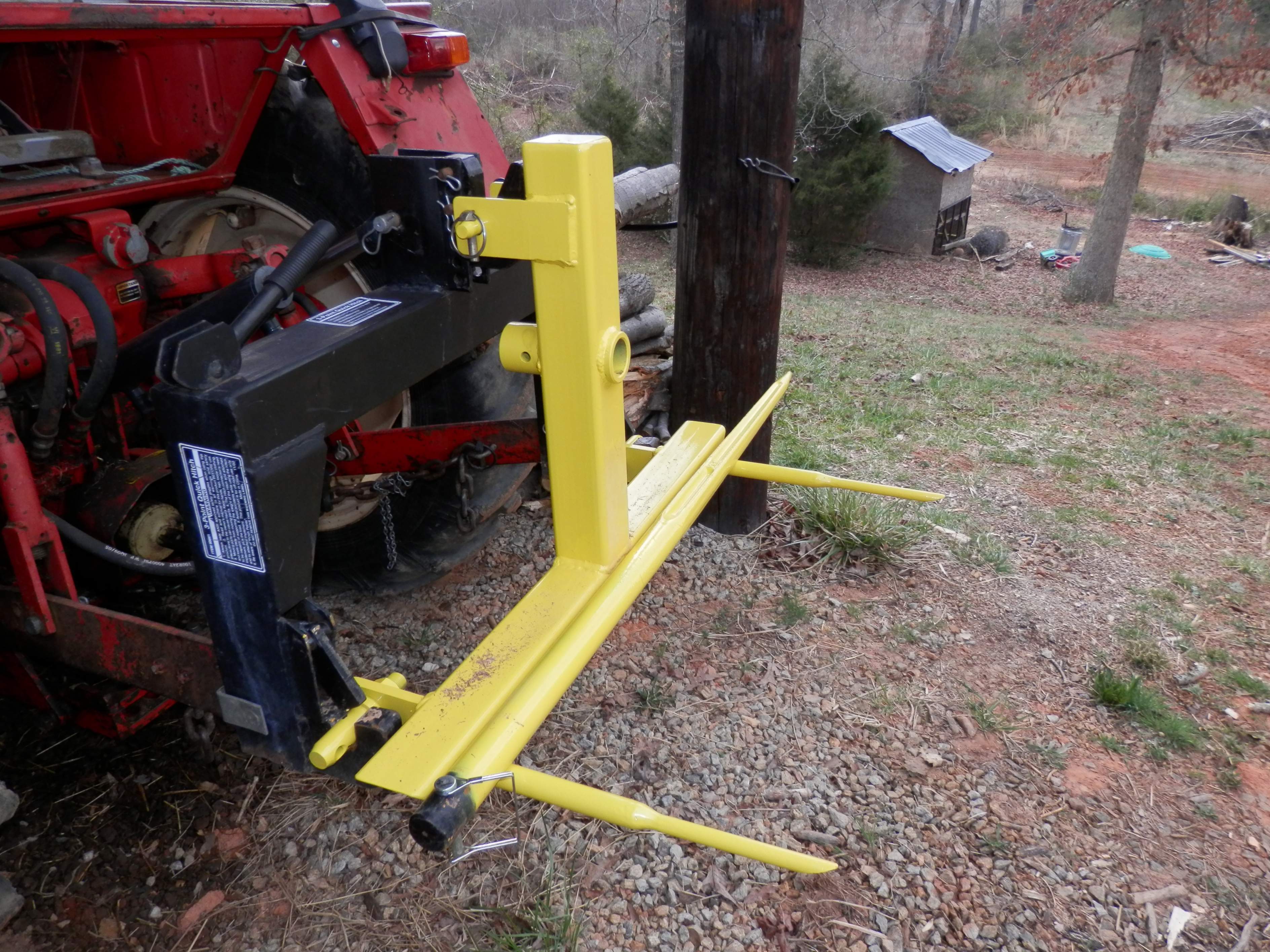

Got a paint job on my pine needle rake.
Looking really nice. :)

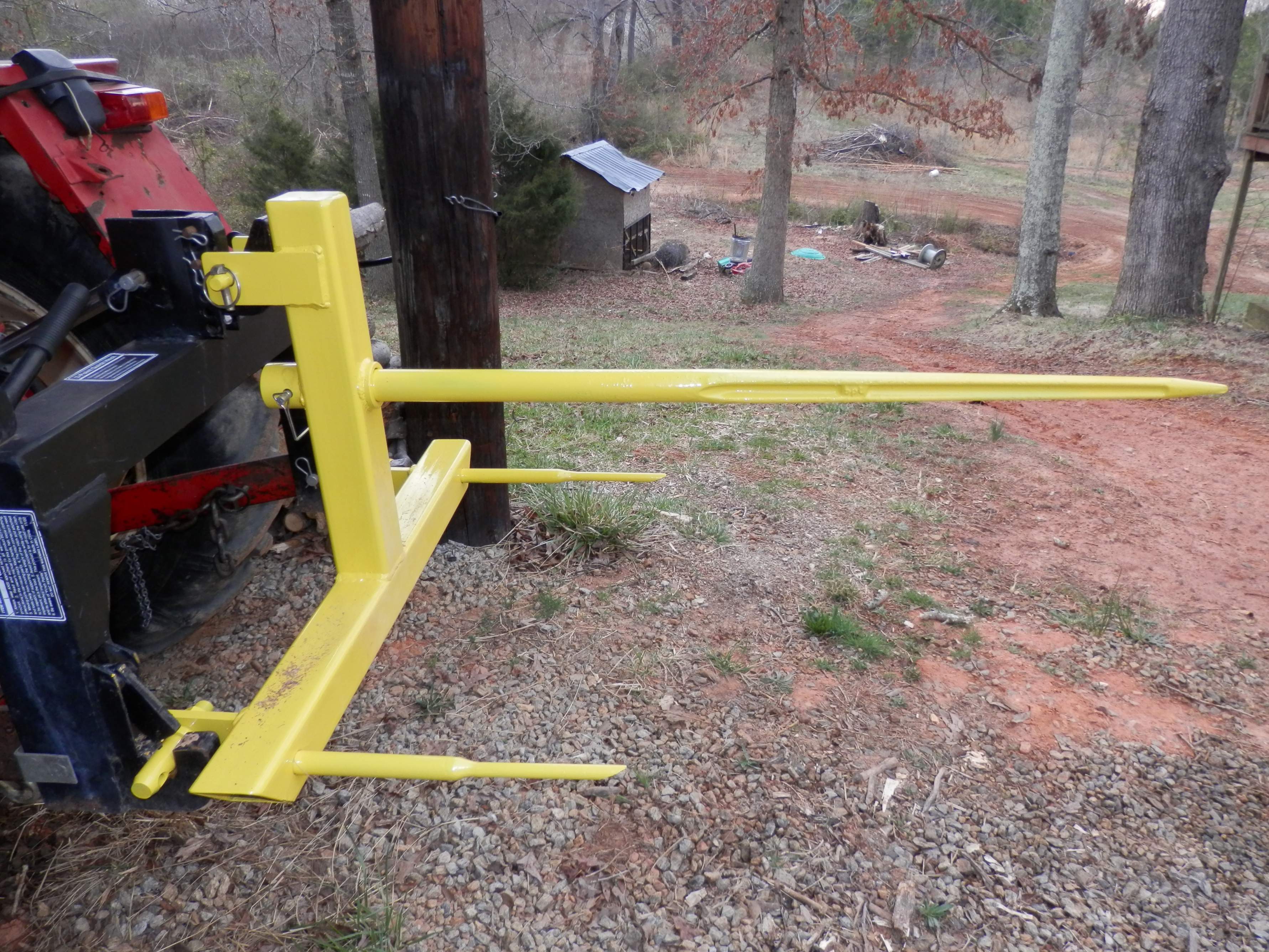

This gives me an idea for a multi-use 3pt tool. I need a hay spear with foldable spears and with the tow receiver on the bottom leg in the middle. This way I can swap in and out the tow ball sizes and have one implement that does TWO things rather than two things in the shed taking up space.

What about a hay spear that fits the 2" receiver? The stabilizer spears are short enough not to likely cause an issue with a center mounted hitch. I would think that having a folding main spear would be difficult to build with enough strength.
Take a look at this Youtube video of the foldable hay spear. Grant it, this tractor model is smaller than mine, but the hay spear attachemnt is a good size. Only two long spears are needed to fork the big round bale.

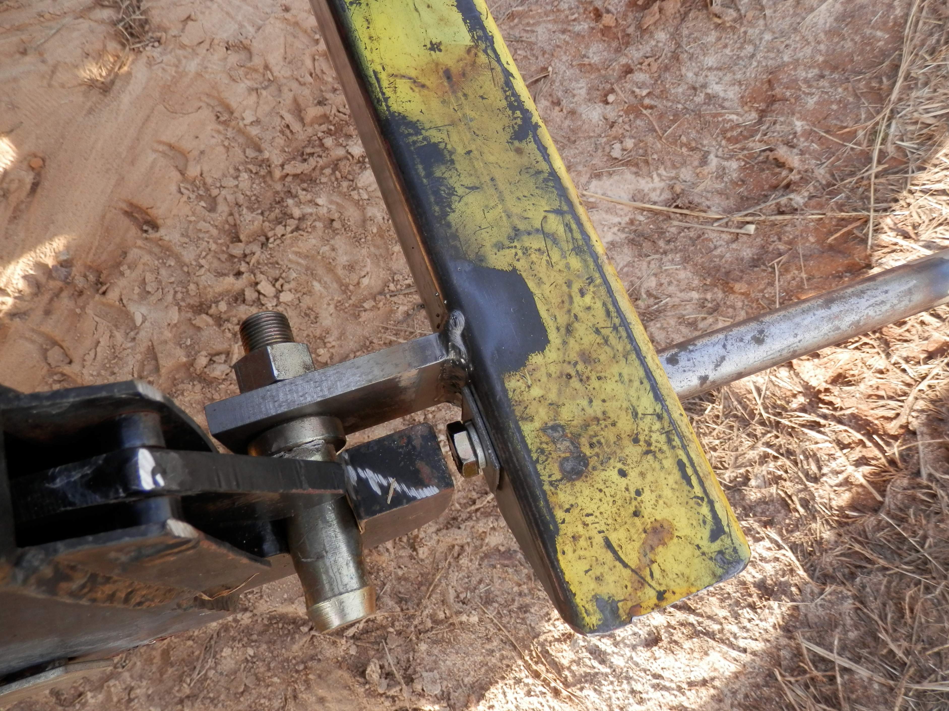

I used the through-bolt spear and sleeve from Agri-supply with a lock pin. It comes right off. My spikes are bolt-on but not so quick to remove. A mini version of the sleeve and pin would work fine to make them removable. Edit: You could just use 2 of the agri-supply spears. This is the spear: http://www.agrisupply.com/replacement-bale-spear/p/49667/&sid=&eid=/

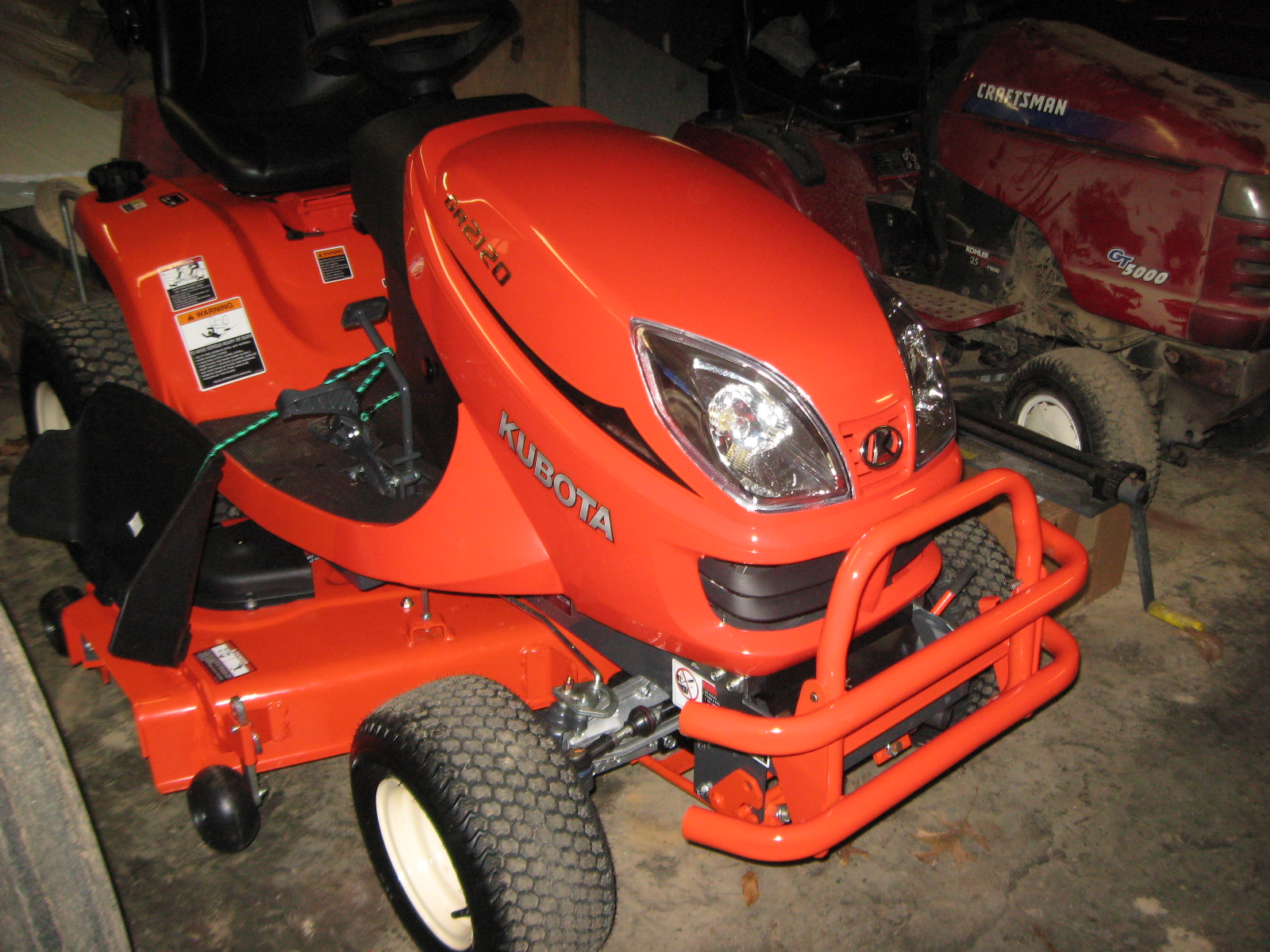

Small item , I wanted a bumper for my new Gr2120 , I have a 8n Ford tractor I blade with , so don't plan to add any attachments to front . Asked Kubota , and was told front bumper isn't available . Took the optional bumper off my Gt5000 and modified it to fit the Kubota. Pull 2 pins and bumper folds down to open hood , doesn't interfere with deck removal . Is held on by 2 bolts thru holes already in mower.

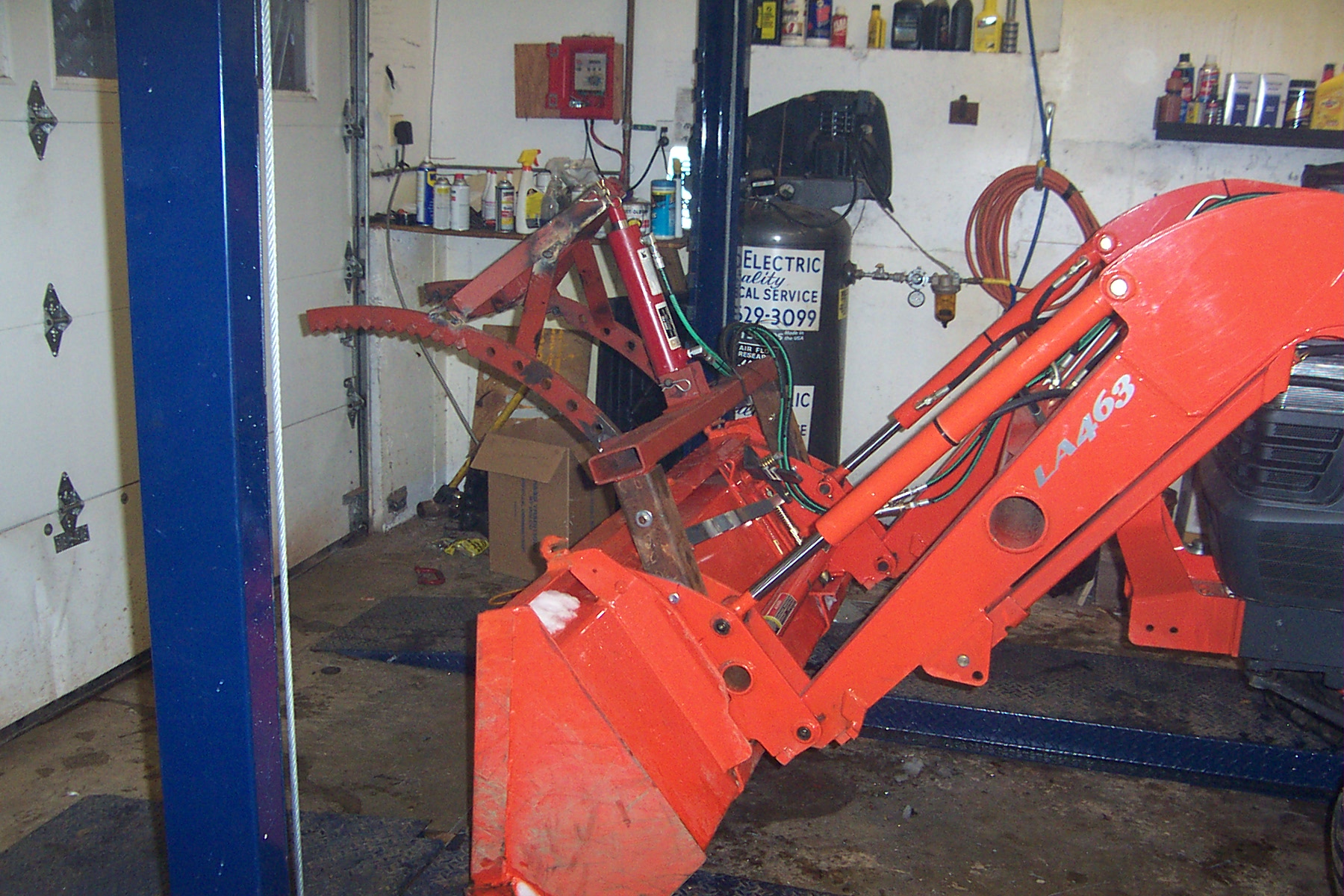

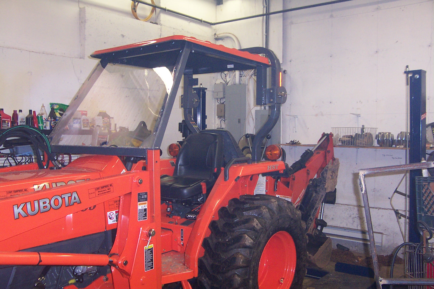

I made a cab for L3400. I made a grapple that mounts on the load arms instead of the bucket. That way I could use it for forks, picking up logs. Or I can use it with the bucket as a thumb.

Pretty clever - great idea :thumbsup:
   / Home-made attachments... #198
Oh! I like that thumb/ grapple idea. When you have the forks on is the grapple out of the way enough to p/u a 42" high pallet of something?

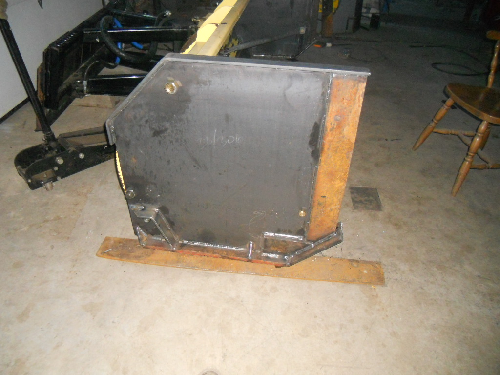

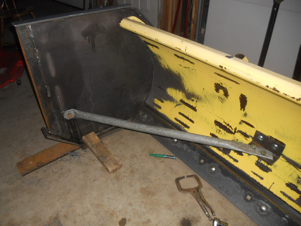

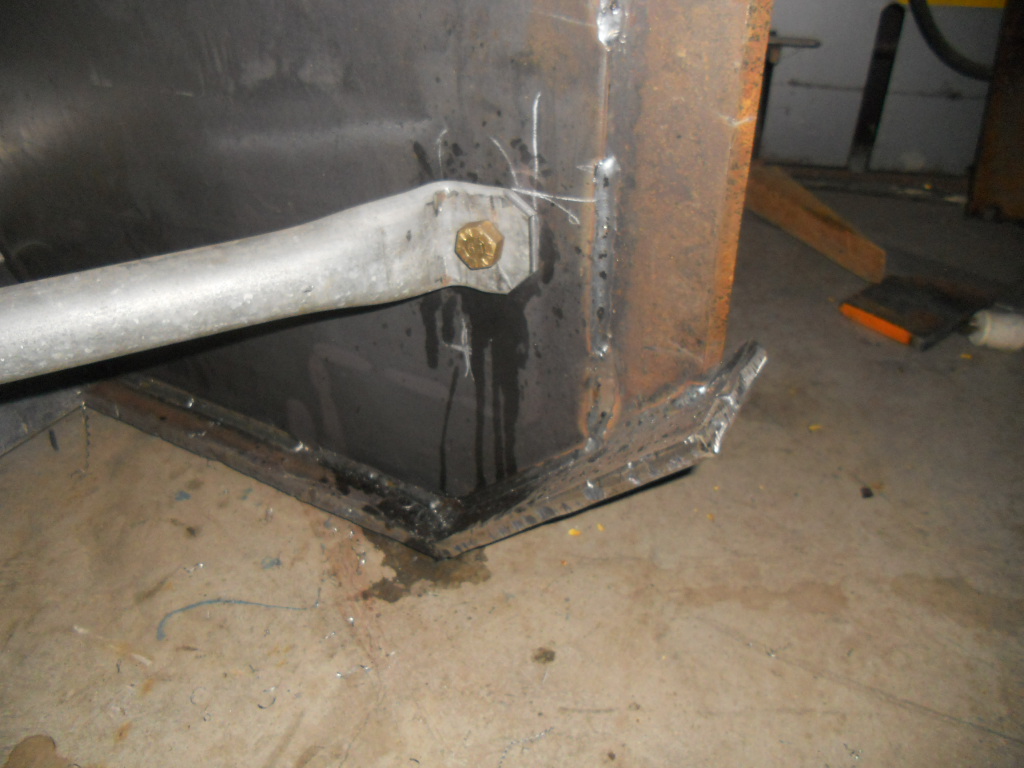

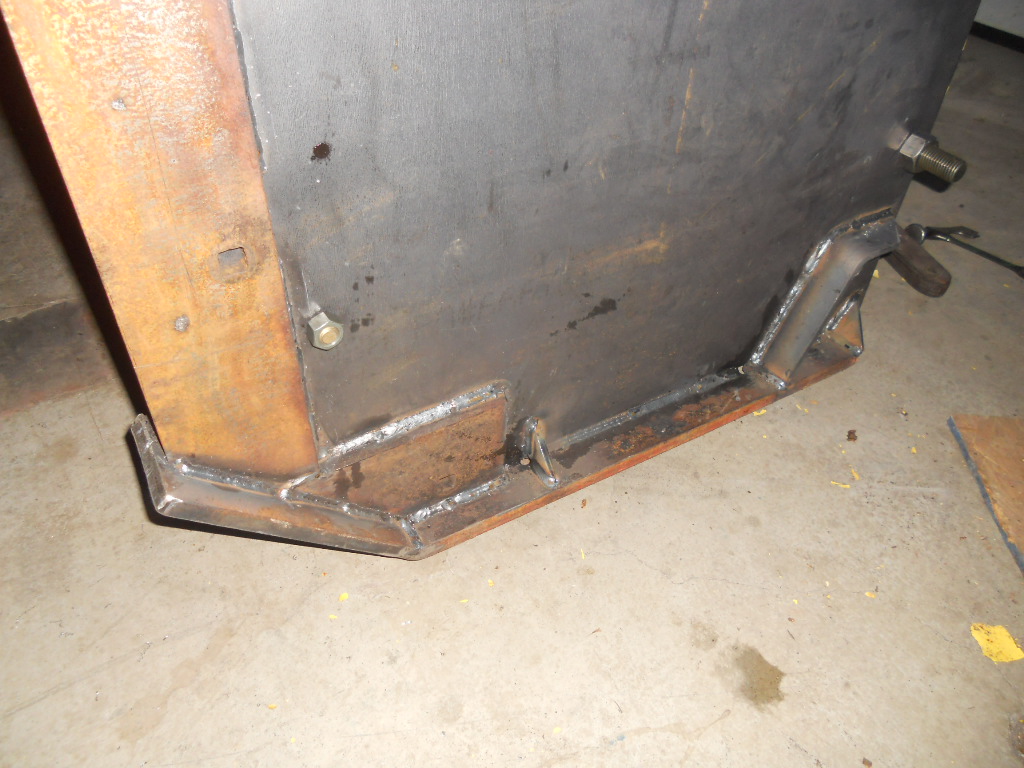

Just made some end panels for my snow plow. Luckily there were provisions for it built onto the blade. I have some open areas that (I hope) this will speed things up. It's about a 20 min. conversion, mostly because of the diag. braces. I still need the angle blade for most of my plowing.

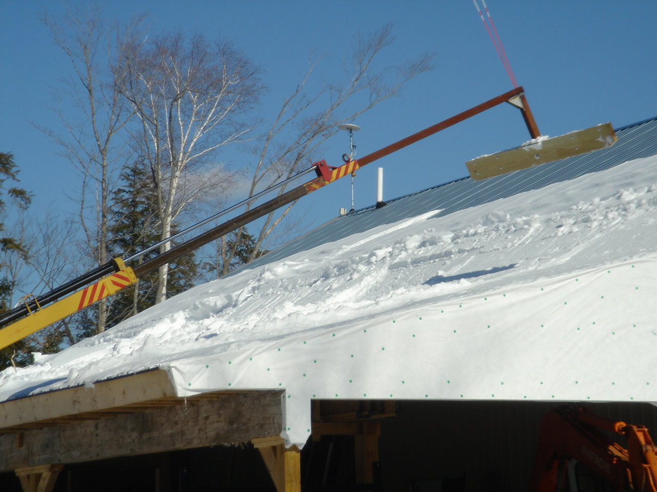

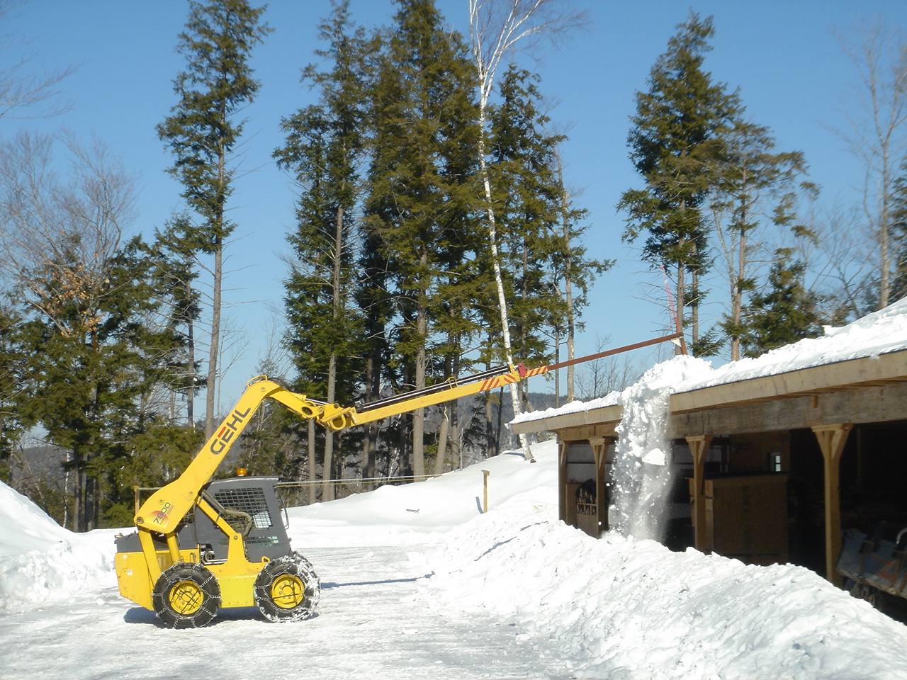

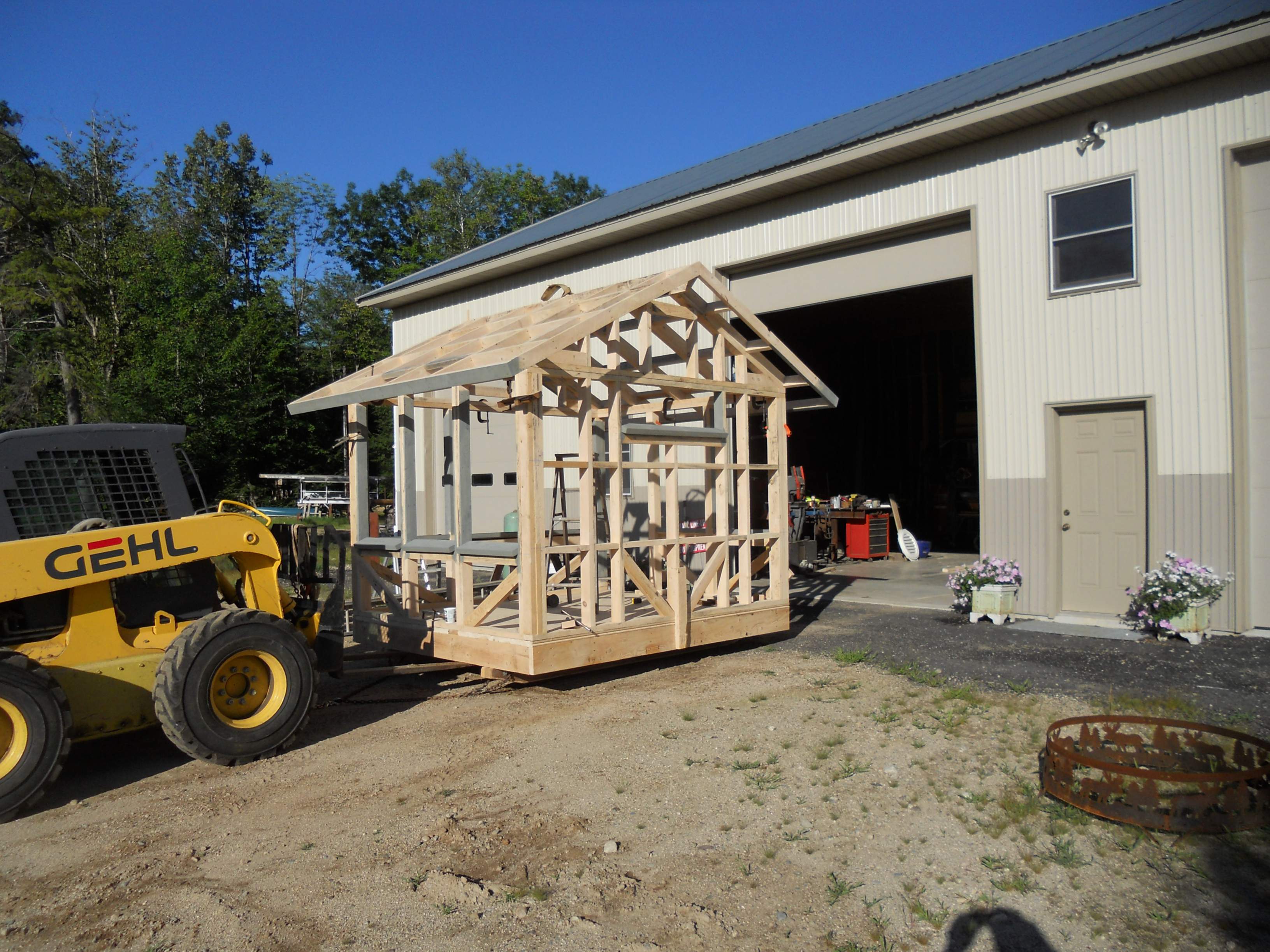

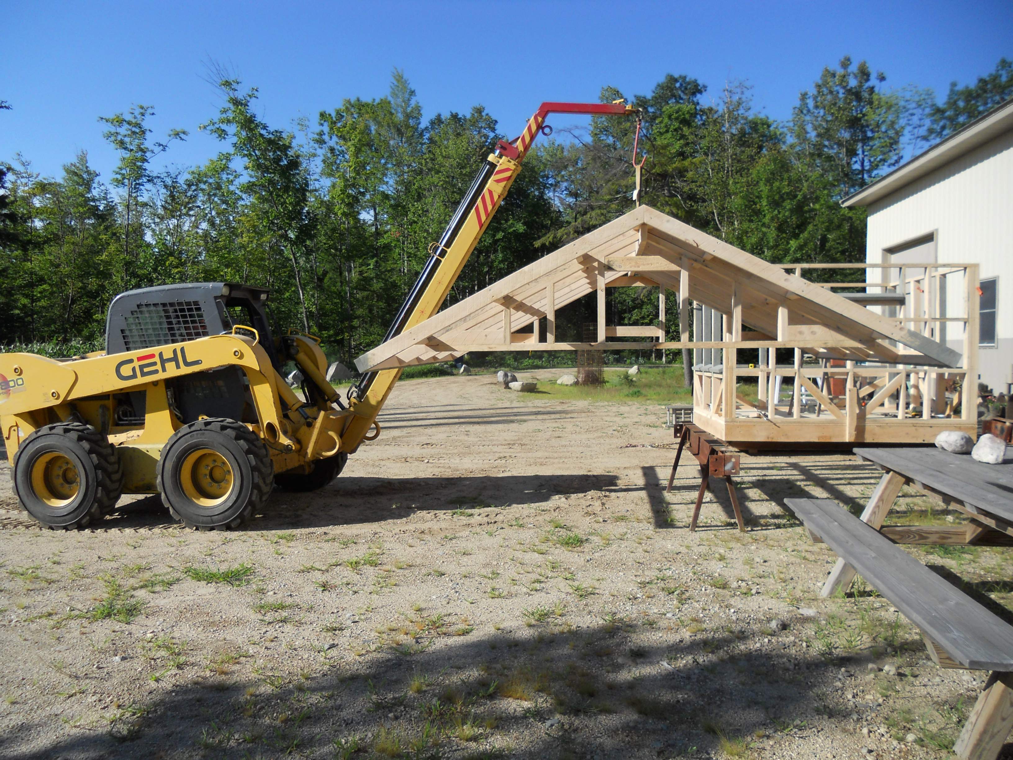

I built this jib pole out of some stuff laying around a few years back. It'll reach about 30' (straight up) on the SS with the arms up. There is about an 8' cly. to make it telescope out. The outside is a 6X6X.25 tupe with a 4X4X.375 inside it with some slides I made up to acommodate the inside dimensions. I did the "snow rake" attachment after I put that "lean to" on the back of the shop. The blade is a 2X10 p.t. on a steel backer and it can swivel some to accommodate the machine not being level with the roof. It does not harm the metal roof, but I am very careful! Snow just will not come off a 3/12! The end of the pole is built like a large (4") reciever hitch, I can slide in & pin different end configurations for lifting. Sorry no pics of it on the tractor.
