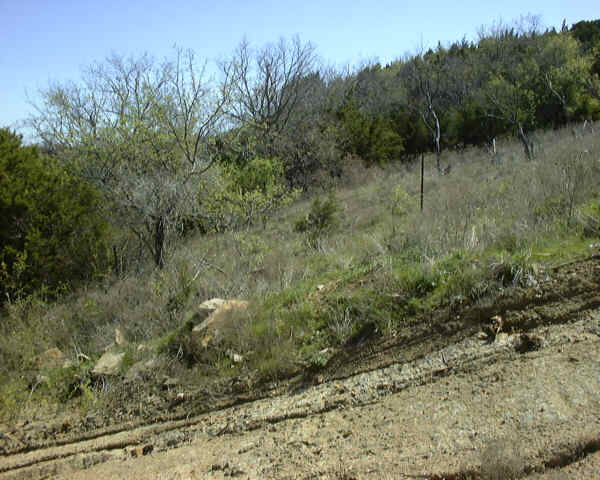

BTW, here are a few more pics (this is the section of road I'm having the most issue with...)

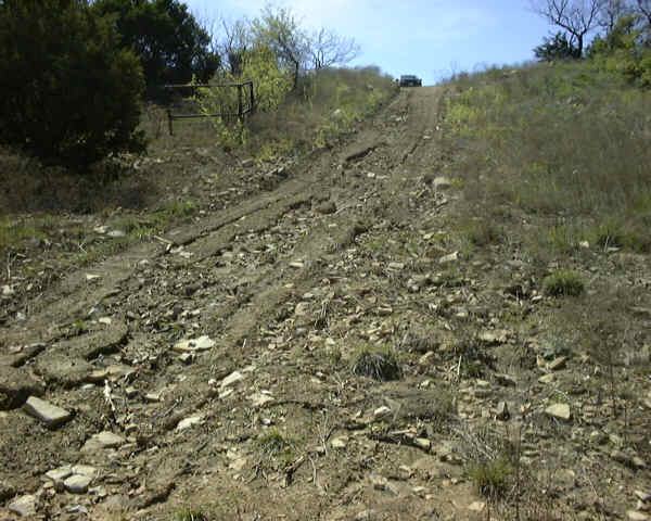

pic 2 of 3...

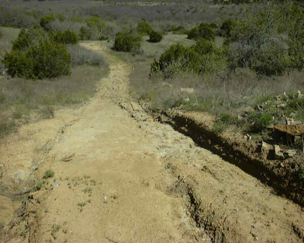

And pic #3...

Once you get it leveled, you'll probably need a full layer of 4"to 6" shot rock as a base. Cover that with 6 to 8 inches of 3/4 minus or recycled asphalt, sometimes you can find asphalt reject matierial pretty cheap. make sure it contains enough fine matierial to lock the aggregate together. Then rent a small pull behind vibatory roller. Add enough water to it that you actually see the water start to pump out of it from the compaction, this really brings the fines up between the crushed aggregate. Stay off of it till it drys, and it should hold for a long time.
An alternative to the shot rock would be a geo-textile fabric but that gets rather expensive.

After years of putting up with the same sort of rutting on my drive (15% grade)I stopped grading it and started to fill the ruts with potato stone. Eventually, the mess stabilized, but it took a lot of stone. If you have much to deal with it could take a lot of material.
As for building your roller... Couldn't tell from the photo what type of soil you have but compacting clay takes a sheeps foot roller. Those are the ones with the knobs that stick out all the way around the drum. Weight helps with clay, but vibration doesn't.
If you have clean sand, then vibration helps and you want to use a smooth faced roller. The comments about using shot (or crushed) rock and recycled asphalt are good suggestions, but the amount of material may be prohibitive.
