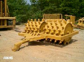

Okay, you guys have peaked my curiosity. Exactly what is a sheeps foot roller? Is it different than just a plain old roller? Does anyone have any photos of one they could post?
   / Home-made Sheep's Foot Roller Ideas? #44
Re: Home-made Sheep\'s Foot Roller Ideas?
Well, I just went to Google and picked the first picture I saw, but there's a pretty good picture at <A target="_blank" HREF=http://sbe.napier.ac.uk/projects/compaction/chapter2d.htm>this site</A>.

   / Home-made Sheep's Foot Roller Ideas? #47
Ahhh so that's what they look like. I've seen those on the side of the highway before but never knew what they were called. Somehow I don't think my 'Bota would pull this one!
Thanks for the link, Bird!

Dan:
I'd use the truck for the packing too.
Those sheeps foot packers are usually filled with water for weight so they may not be as heavy as they look and if you vary the amount of water in them it could make it feasable to pull with something a little smaller.
Egon
