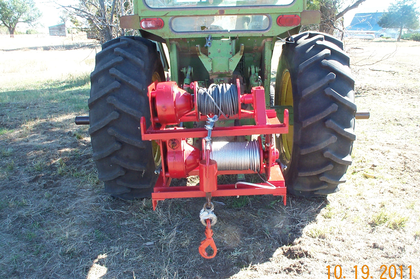

these winches are made out of old wheel gear boxes off of a center pivot sprinkler, I think these are Lockwood boxes, and I have made them out of valley boxes, and even new boxes are not that badly priced, there 50 to 52 to one, in reduction, some have a shaft that extends the wheel disk, and that makes it easy to slip a piece of tube I used a pieces of DMO (I think that is the name, expensive but very good fit, and I took a second box that was damaged and took the Axel and reversed it and use that for my drum,
the draw back of this is no free wheeling, I have made them with a extended shaft and then a tube over the top, and used a hitch pin so the drum could free wheel,
I currently power these with a 1/2 electric drill so I would feel the pull, my son has one I made with a Hydraulic motor and I had one PTO driven off a truck both of these have pulled a 1/2 steel cable into into, in a odd situation, but any way they can make a good winch, and plan to add some Hydraulic motors on this set. (they can be separated, there just bolted together I had a situation I needed two cables that were independent,)

Thx For the ideas. If I do this project I'm going to look at useing a Hyd motor driveing a transmission. Which would drive a differential. Chain drive to the drum. I would probably make the drum out of a pipe with flanges at each end. Still in the planning stage. With hydraulics driving the input it would make it easy to free wheel and change gears for power or speed.
