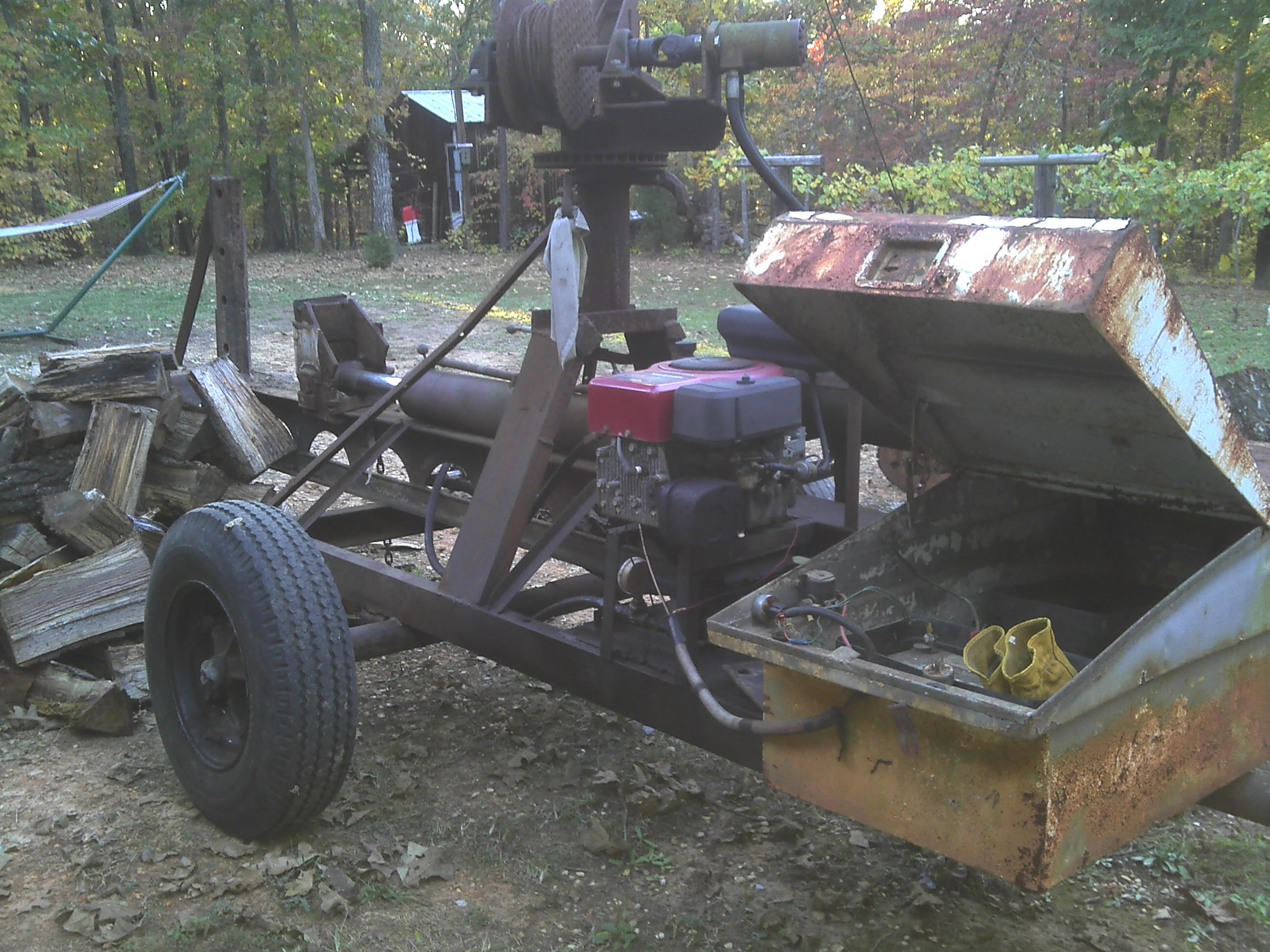

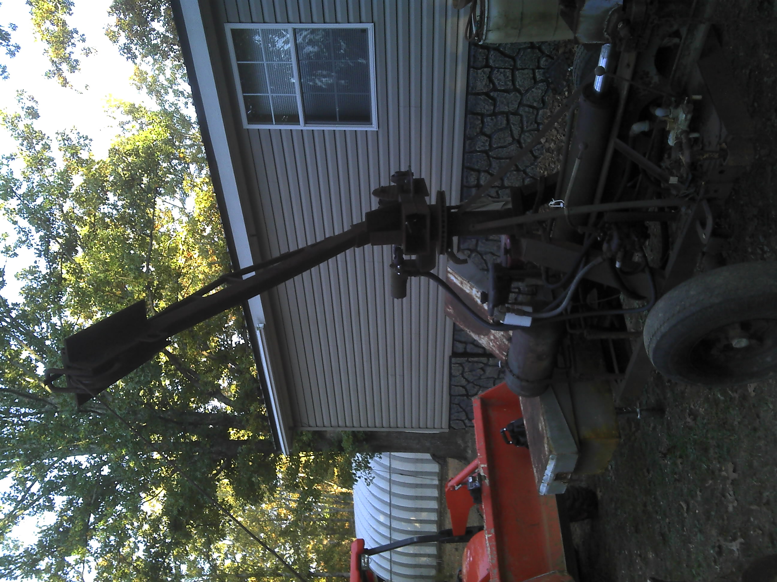

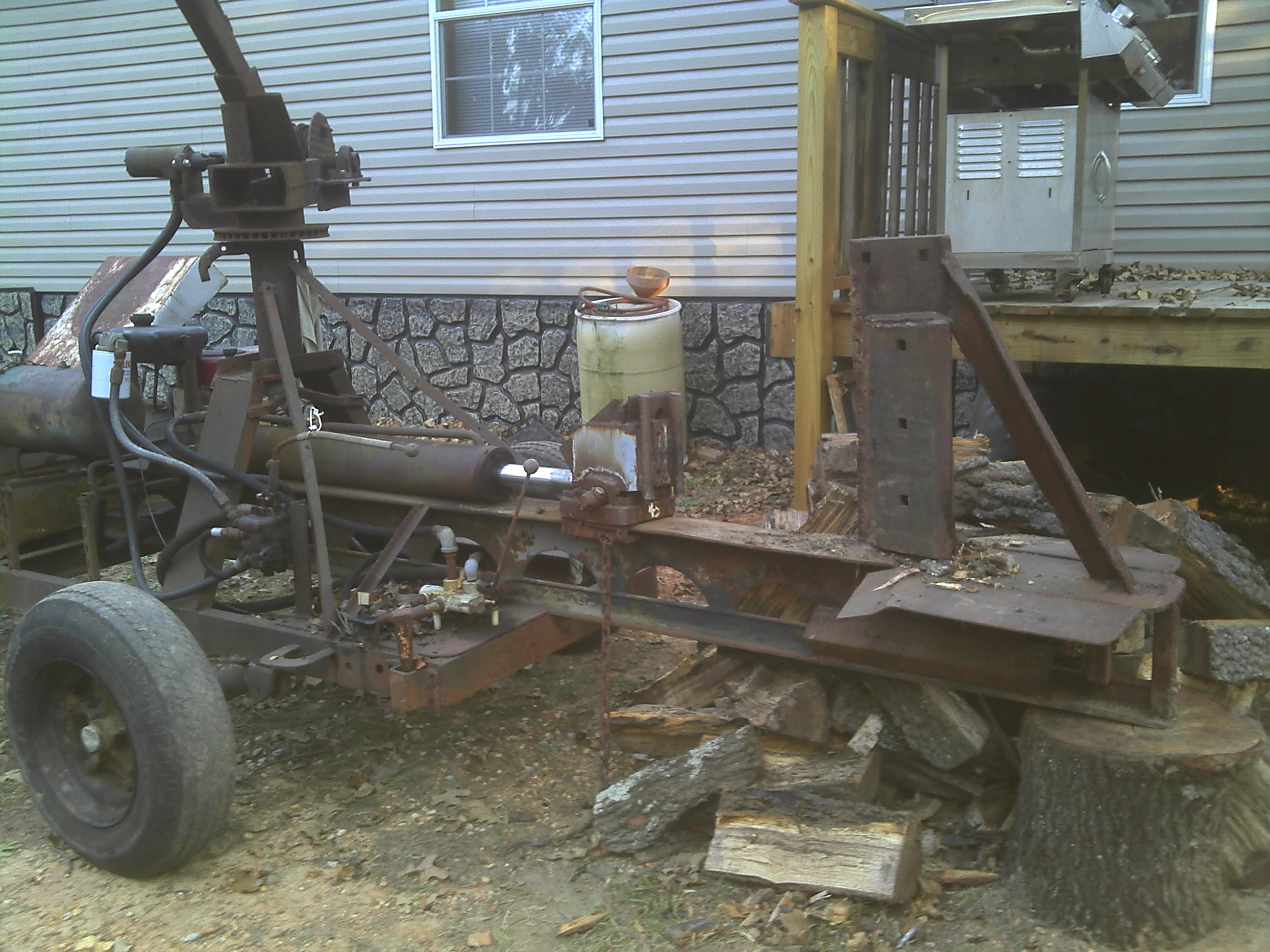

Toxic, this one is about 25 years old and still going strong.
   / Home made wood splitter #23
That sir is an awesome splitter.. I like the log lift that incorporates the truck rotor and i am assuming bearing, for its swing..:thumbsup:
built once and keep for a life time..
   / Home made wood splitter #24
that rotor came off of a Lincoln continental, shoot that is high dollar junk. got it from a neighbor way back then. the car had been hit by lightning and burned in his front yard.
