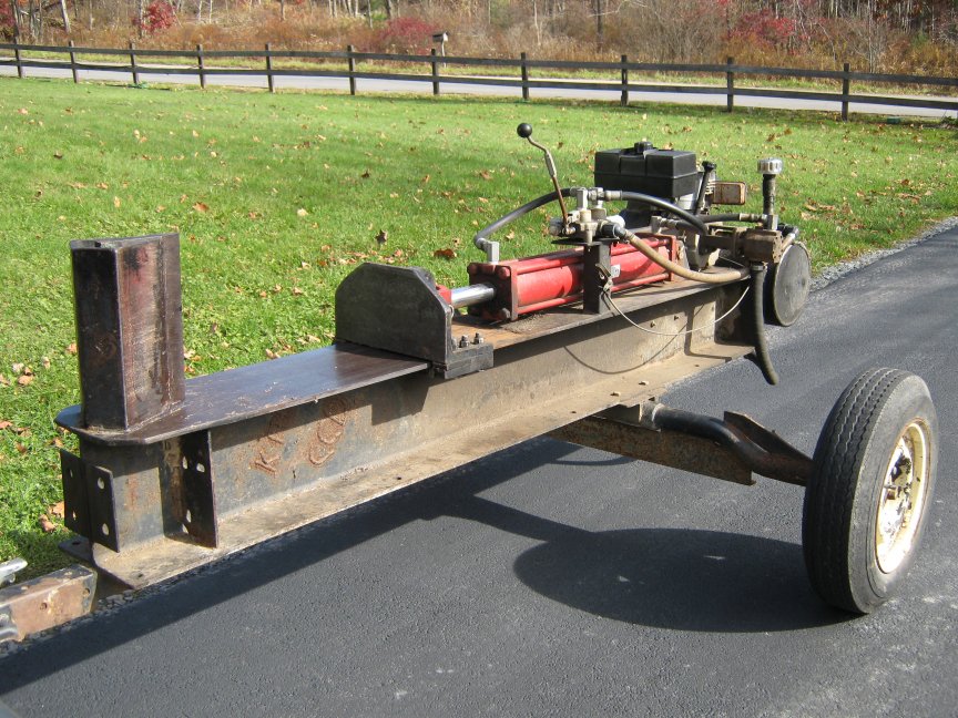

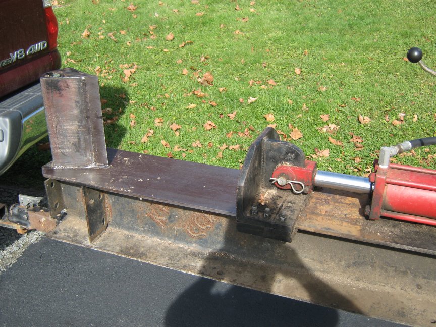

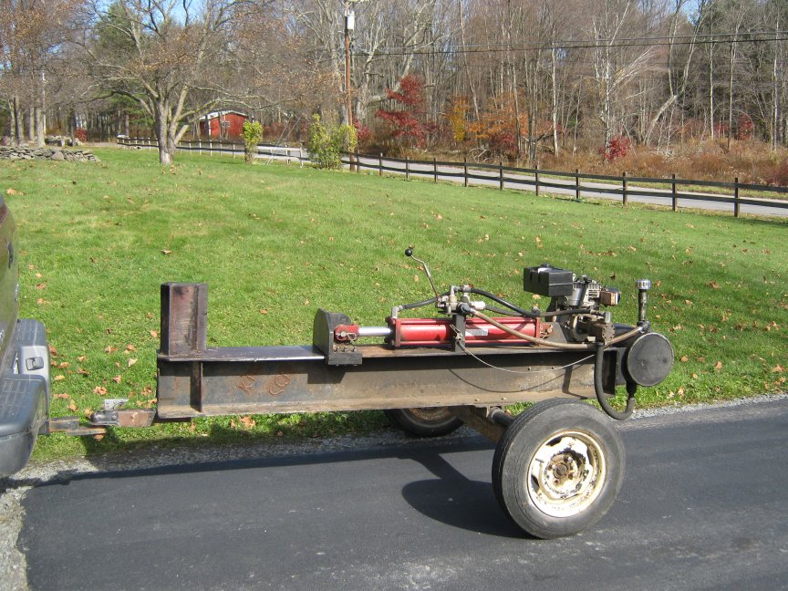

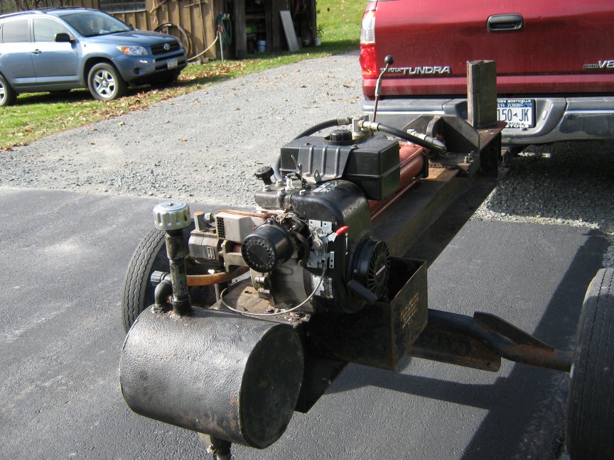

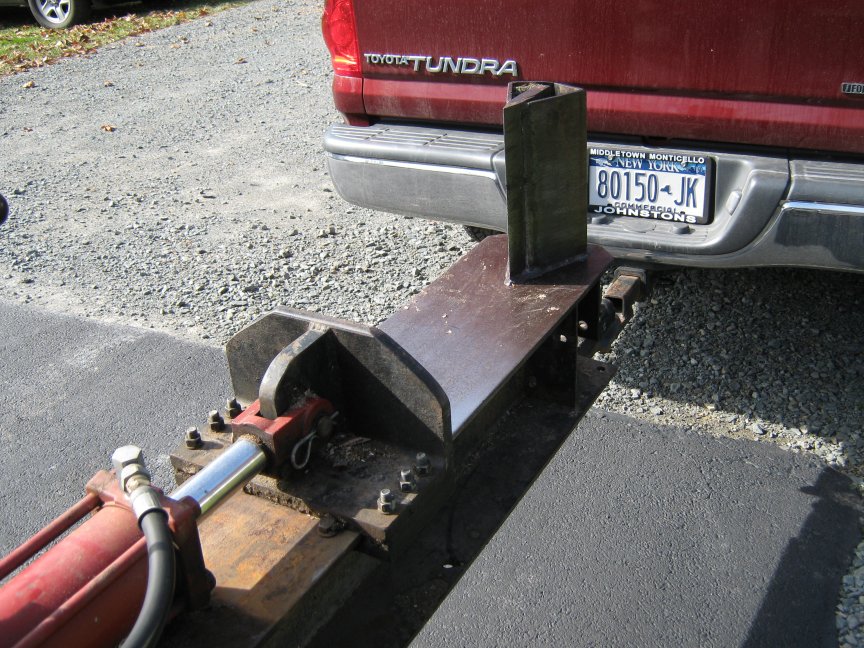

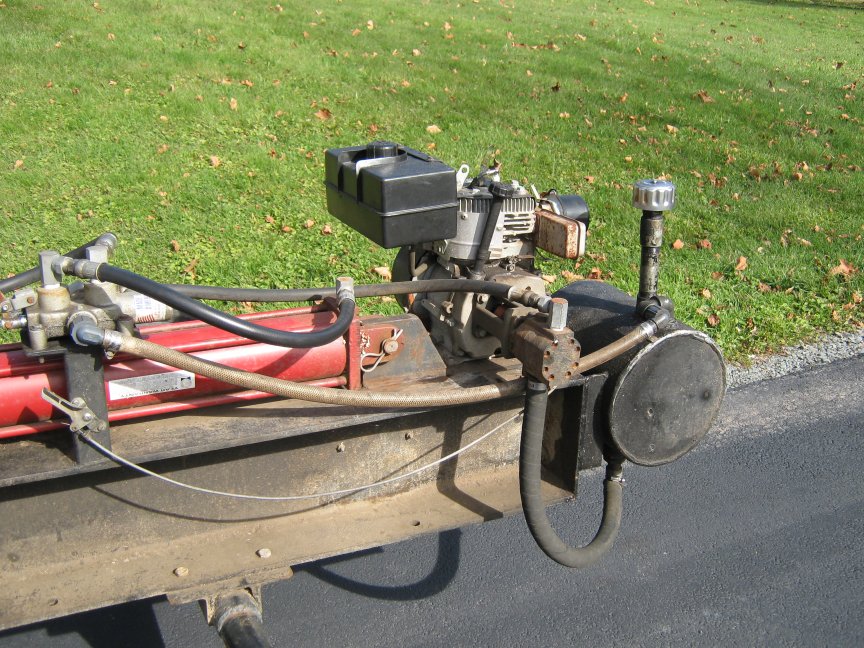

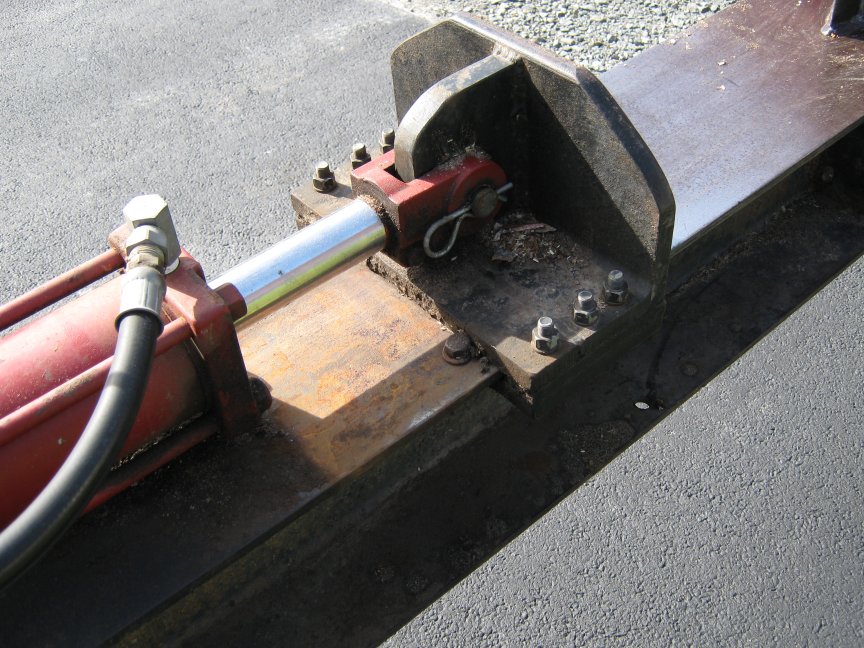

Made this one about 18 years ago.
The oil tank was the biggest challenge, 10" pipe I think. I also made allowances for shorter length wood by using bolts to be placed behind the ram in the platform so to stop the ram from having to go all the way back in order to detent. The first test drive out the axle bent from bouncing hence the 5 1/2" channel.

Hey Gizmo..Your splitter looks exactly like what i want to make..lots of room to work withour getting into the tire..What are your pump spec and eng HP..also what size is that beam..looks like what i need to run a 15 HP 16 gpm pump with a 3.5 inch 24 inch long cylinder..hopeing for a high 6 low 7 sec cycle time..
   / Home made wood splitter #19
Wow, sold the splitter about 10 years ago and don't recall some of the requested information. What I do know is the beam, I think was 10", 5-HP motor, 2-speed pump. Besides the axle needing to be braced I also needed to add bracing to the beam under the wedge as the unit was twisting the top of the beam. I will add, if I may, your 15-HP engine and 16-gpm pump requirements seem to be a lot. Others on here will correct me if I am wrong.
   / Home made wood splitter #20
Thanks Gizno..Sorry i didnt realize the thread was that old till now..I am in the process of looking for a beam now..Have a line on a 6 x6 x 8 but that just seem too small..my only reason for wanting to build over buy is cause the stuff on the market seem cheaply made and slow as snot for the 2ooo+ price tag..The pump i plan on using with the 15 hp is 16gpm on the low pressure side and 4 gpm on the high pressure side..I could get away with a smaller motor but the 15 hp is pretty cheap knock-off motor and has an electric start :thumbsup:
