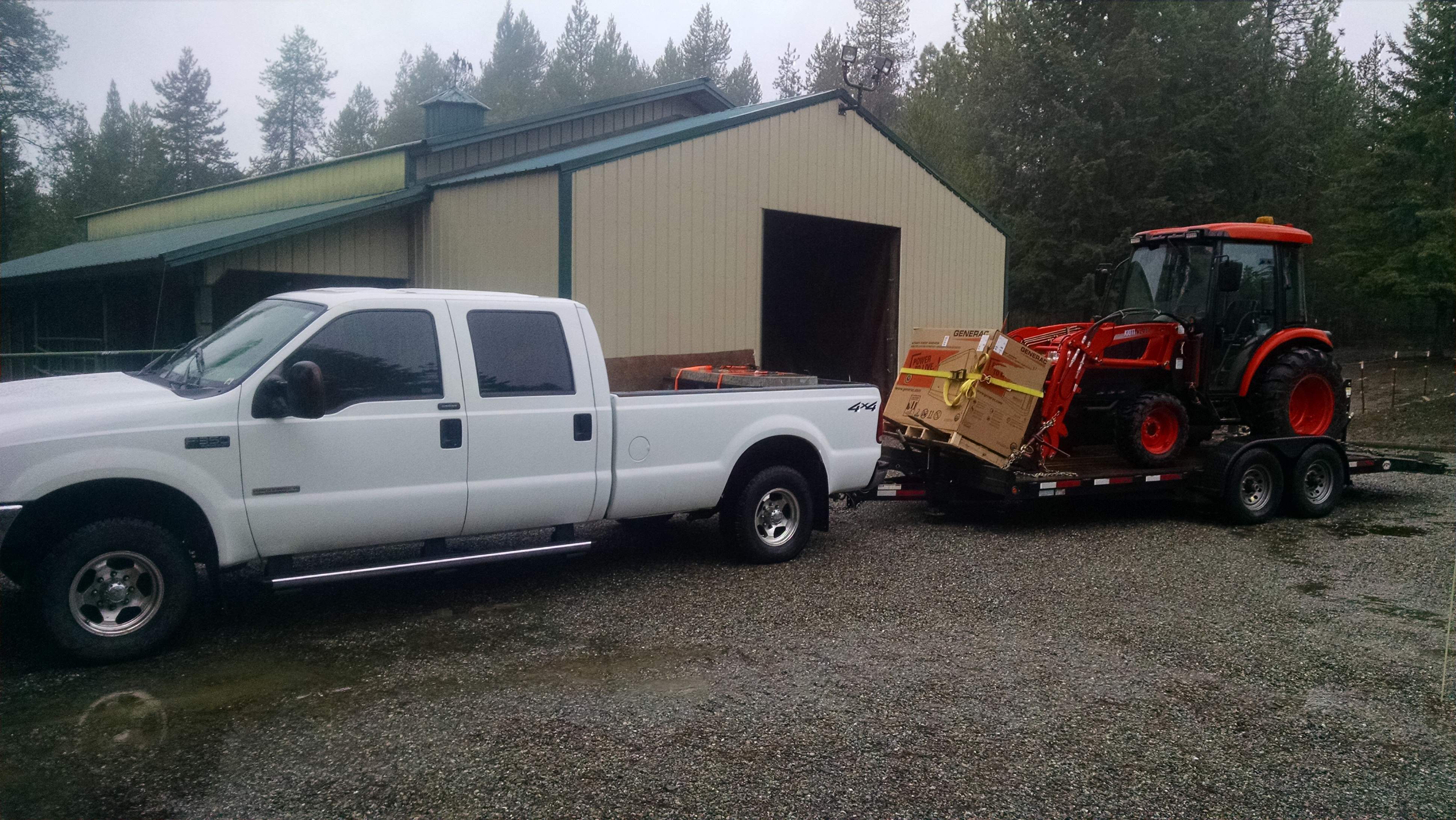

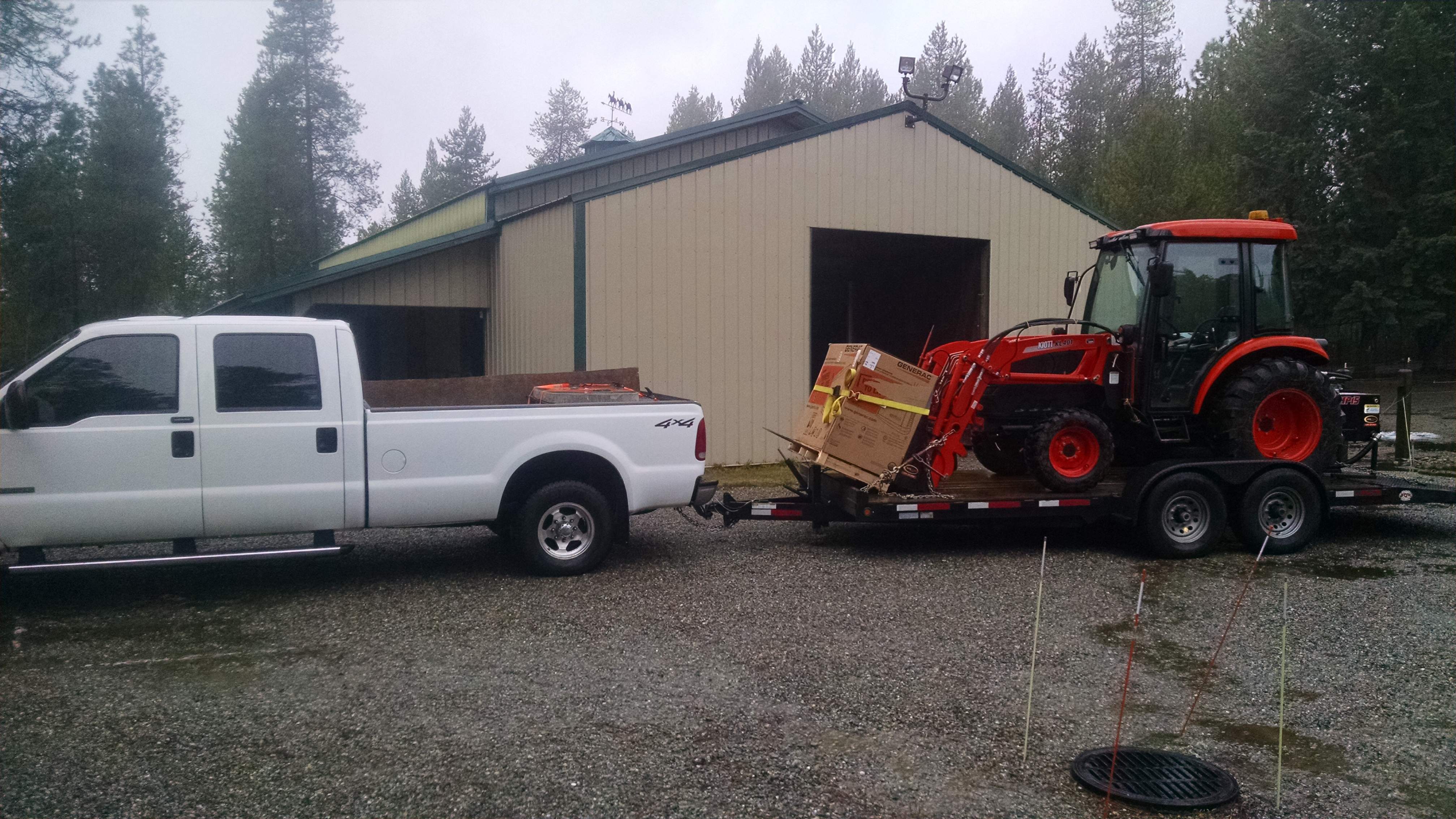

Off to install another 22kw Generac this rainy morning. Have another in shop for next weeks install. So many people are buying generac units its taking me up to 3 weeks to get them in anymore. image.jpgimage.jpg

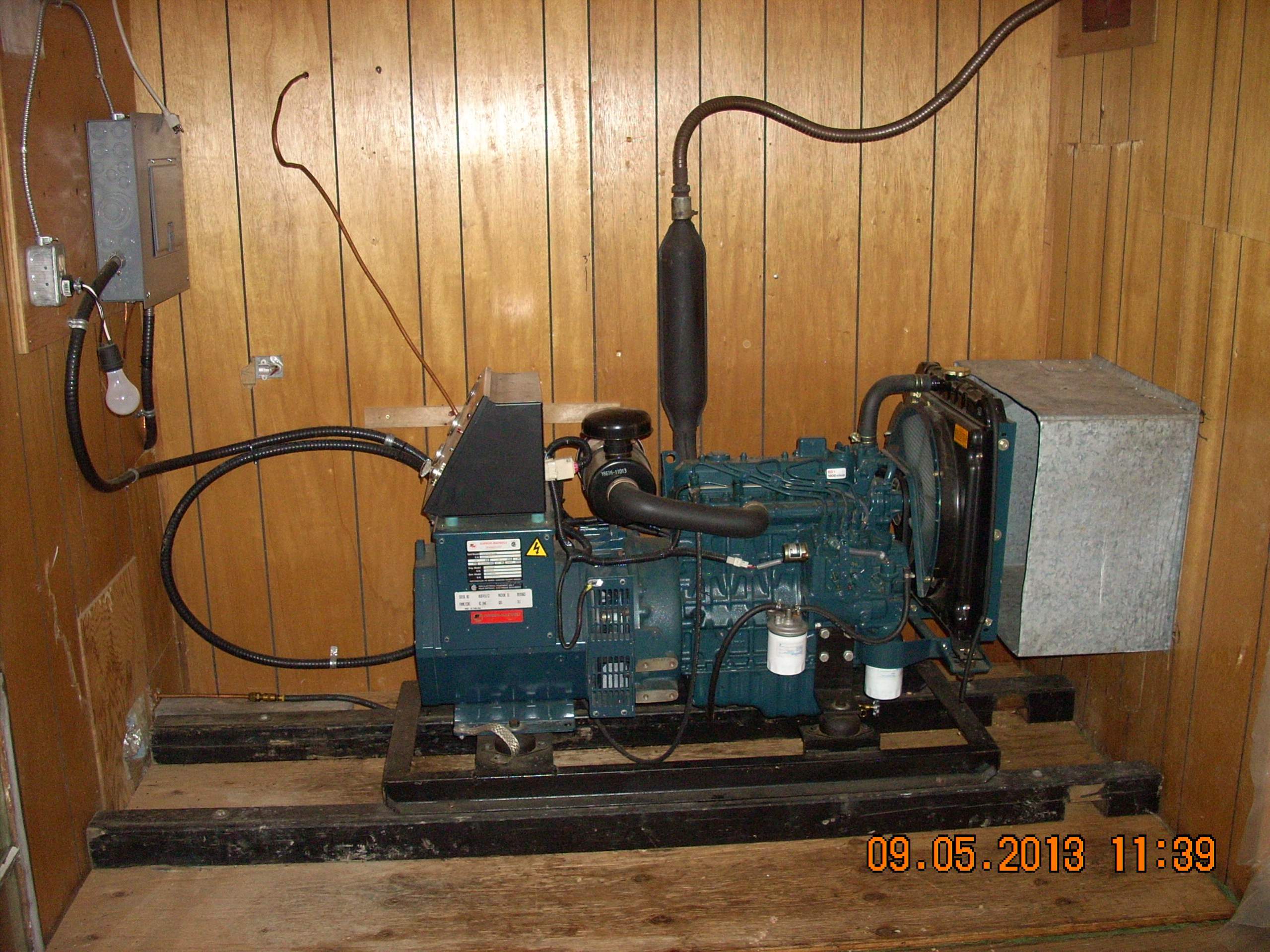

Anyone have Kubota standby power, looking at SQ33. HS
HS,
I have the Kubota V1505 12kw diesel generator for backup. It runs at 1800 rpm and is reasonably quiet - though we have it housed in a wooden shed about 50ft from the house. My setup is manual start and the change over switch is manual as well. I don't mind this at all as I am able to see what is happening and how the machine performs while there and can fix any problems with it if need be.
Where I live it can get very cold and I have had trouble starting it in very cold weather so now I have an extra battery by the machine. When the generator runs the second battery is charged with the plug in battery charger and gives a load to the generator if not connected to the house (ie test run).
When I bought my place, this generator was already installed but had not been used as intended. I had to set it up properly and re-run the fuel supply to give proper performance. I could improve the very cold weather starting by running a dedicated power source from the house to supply block heater, oil heater and battery warmer etc.
Diesel fuel source easier to deal with on our rural property (no propane or NG).
HTH
jim.

HS, I have the Kubota V1505 12kw diesel generator for backup. It runs at 1800 rpm and is reasonably quiet - though we have it housed in a wooden shed about 50ft from the house. My setup is manual start and the change over switch is manual as well. I don't mind this at all as I am able to see what is happening and how the machine performs while there and can fix any problems with it if need be. Where I live it can get very cold and I have had trouble starting it in very cold weather so now I have an extra battery by the machine. When the generator runs the second battery is charged with the plug in battery charger and gives a load to the generator if not connected to the house (ie test run). When I bought my place, this generator was already installed but had not been used as intended. I had to set it up properly and re-run the fuel supply to give proper performance. I could improve the very cold weather starting by running a dedicated power source from the house to supply block heater, oil heater and battery warmer etc. Diesel fuel source easier to deal with on our rural property (no propane or NG). HTH jim.
Nice, I think a company in Maine makes units. I'm looking at them, very reasonably priced. I wouldn't mind manual switch over too. I actually don't want to start up when I'm not home. Thanks. HS
