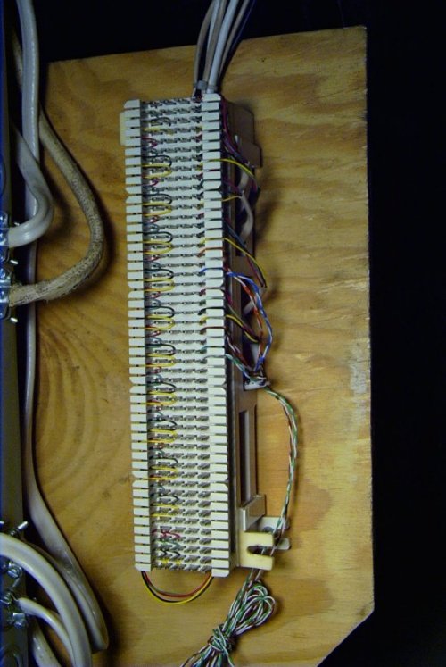

Paul, I would love to see some pics of what you are talking about. I think I can visualize it, but like you said a picture is worth a lot of words. Is the 110 punchdown hardware and tool available at a home center or is it more of an electical supply house item? Get that cameral fixed /w3tcompact/icons/smile.gif
   / Home wiring (non-electrical) #28
Here's my punch down block. We have two lines. Notice that there are 50 rows of four stabs each. On most blocks, the left two stabs are connected and the right two stabs are connected. On this particular block, all 4 stabs are connected in each row. At the very top on the left notice that the first wire is red, the second green, the third black, the fourth yellow. Then notice that the wires loop through and alternate in color all the way down the block on the left side. What this does is make the first two rows line one, the second two rows line two, the third two rows line one again, the fourth two rows line two again and so on all the way to the bottom. This gives me the potential for 25 lines. I have mine set up for 11 possible locations for line one and 11 possible locations for line 2. Then there are two rows skipped and the last four rows are where the lines actually attach from the phone company box, as you can see hanging under the block at the left. I should have started from the top, but I didn't. Anyway, now look at the right side of the block from the top. These wires come from the phone locations throughout the house. Most of the old locations have 4 wire, but I have started using 8 wire CAT5 cable, just because I had it. The unused wires just hang around for future use. I have both lines available at every location in the house, which makes it very easy to use either line anywhere in the house.
Now, if I want to add a location, all I have to do is home run a cable from the location to this punch down block, terminate it at the location in an RJ11 jack or two, and punch down the pairs that I need on this block using the punch down tool.

Very slick MR. I'm sold, at least for the phone lines. Where did you get the block and tool?

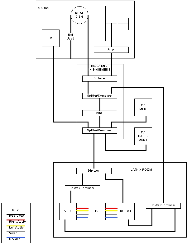

Is there an equivalent for video/coax? I can hold off on the network for now, I'll run the wires but let them hang. I have seen some "all in one" boxes at the home centers, but they are pretty pricey /w3tcompact/icons/smile.gif

I've picked up several of these 66 blocks over the years in construction demolition. I have the one like in the picture and the ones that are split down the center, which cuts the number of stabs per line down to 2, but increases the capacity to 100. The split one is more common.
I can't remember where I picked up the punch down tool, I've had it so long. You can get them anywhere for about $69.00. It has a two level impact spring and the blades are interchangeable for common phone equipment. The blades that I have are for the 66 block. One end has a blade for terminating and cutting, the other end is for looping through like on the left side of the picture. It will punch down, but not cut the wire.
I took some pictures of the punch down tool, but my camera batteries died last night and I couldn't download them. /w3tcompact/icons/mad.gif I'll try to get some batteries tonight and post them.
There is nothing similar for video, as of yet. I have a diagram of my video system attached. I just used high quality RG6 and bought the connectors and a crimping tool. Practiced on a couple of jumpers for the entertainment center and off I went. Not too hard at all.
