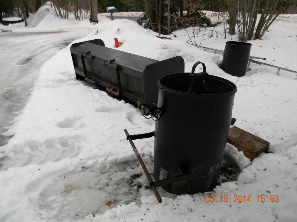

So I'm looking into making a ballast box for my ck35. I pretty much got it narrowed down that I will make some forms and pour cement. I'm just looking for ideas here but, is everyone using a drawbar for the side links? What is everyone using for the top link? I know there are many options. Like I said, I'm just looking for ideas. Do I need to add rebar or will it be ok with no rebar. Thanks.

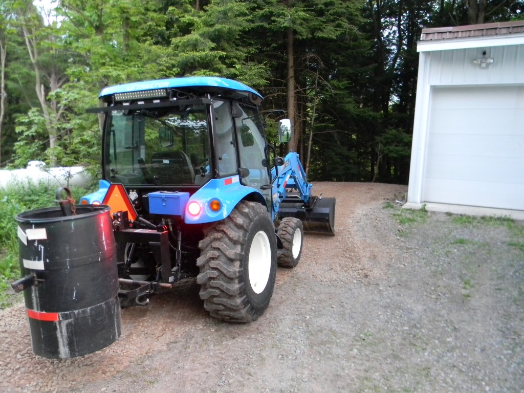

I'm going to use a 55 gallon barrel, a drawbar, and otherwise scrap steel and rebar. Then fill 'er up with concrete.

Here;s another made from a 55 gallon drum. Weighs about 850-900 lb.

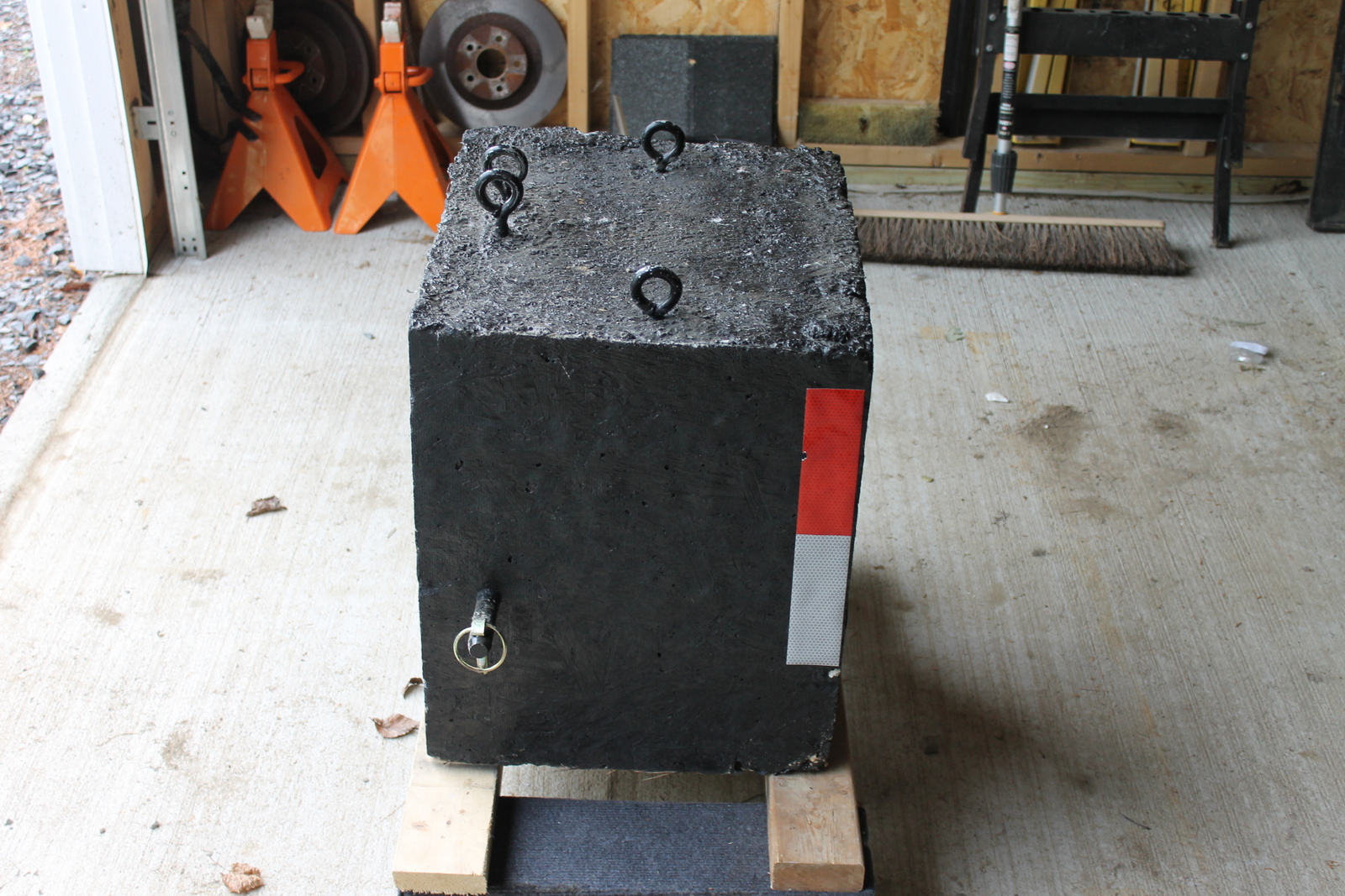

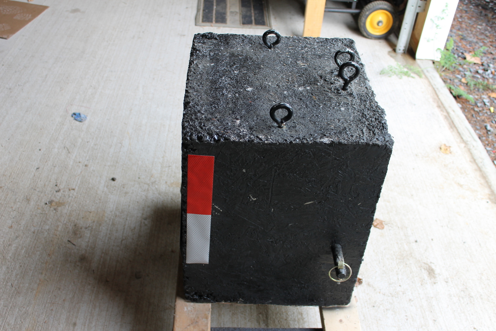

Here is what I made, Has a draw bar inside for the 3 point arms and threaded eye bolts that are welded. also welded in some rebar.

Thanks for all the replies and pictures. MSB 1766 what did you weld your eye bolts too? Did you weld it to the drawbar? What size drawbar is everyone using? 20", 26", 31"? Thanks
/ Homemade Ballast Box #8

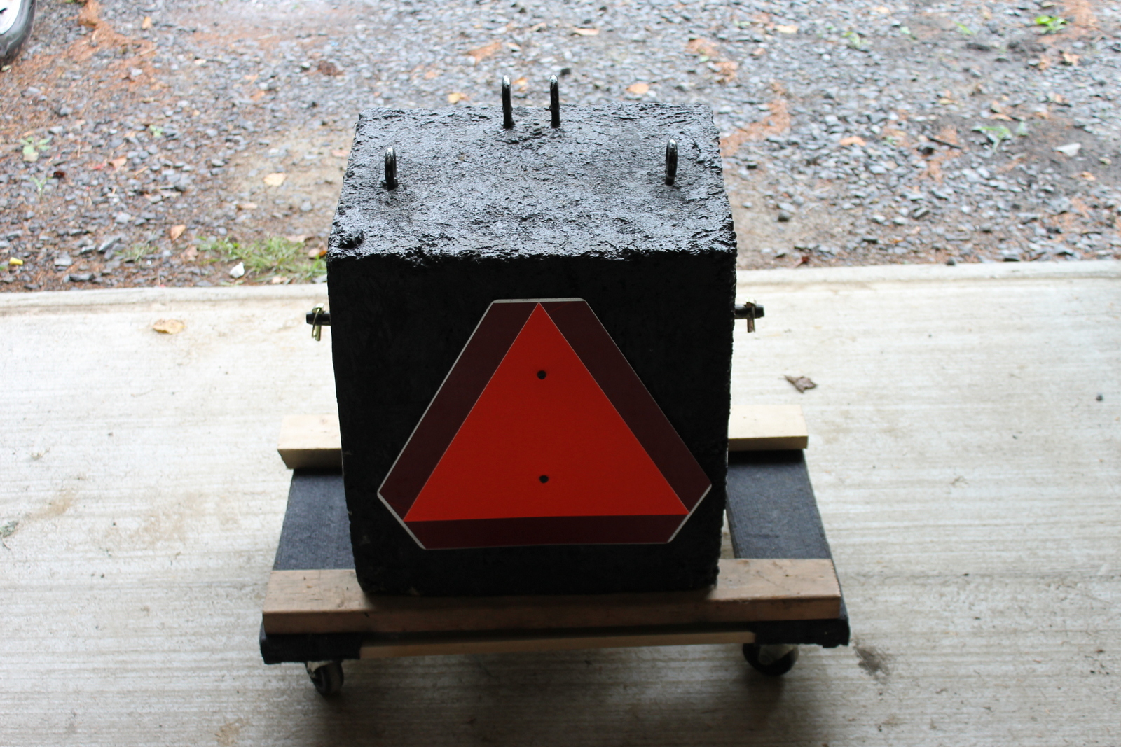

Yes I welded the eye bolts to some rebar inside, just cut to fit and tie everything together. The front eye bolts are for the top link and the other two are in the center so I can lift and move it with the front end loader.
I built it to be set on the dolly so I can just push it around the garage.
The draw is 20" (I think it is a Cat-0) got it from Tractor Supply.
The reason I used the 20" draw bar is that is the same width a my back blade is so I would not have to adjust the side links to swap between the back blade and the weight box.

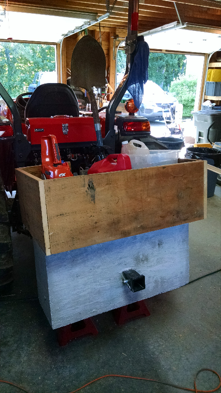

Use a cat 1 tow bar and be sure your top link pin is the correct height in case you ever want to use a Quick Hitch. I added a chain saw scabbard, 4" pipe, 2" receiver hitch, and a box on top. 1000lbs. Form pic is prior to adding rebar.

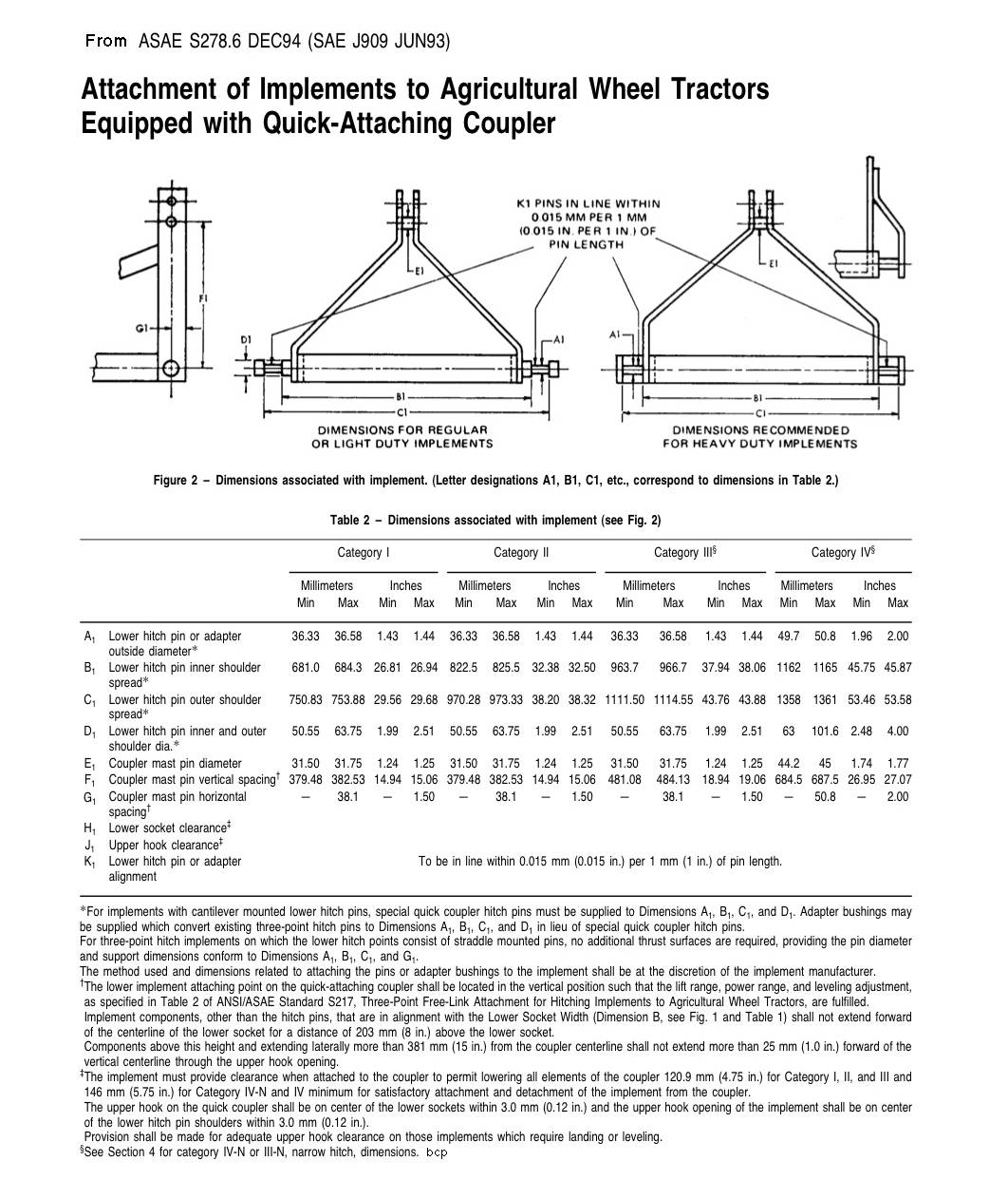

If you have (or will ever want) a QH, make it QH compatible....
#12
Thanks for all the responses. You guys are great. I do have another question about something. When you say make it QH compatible, what is the proper height for this? Does it depend on the tractor? Also I'm trying to figure out the correct height to mount the drawbar. I read that it should not be less than 12" high. Another question I have is do I mount the top link right directly above and inline with the side links????? Or do I have to have it offset a bit. Thanks

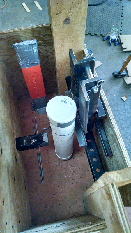

I took the dimensions from my back blade, draw bar width and from the center of the draw bar to the center of the top link.
I set the draw bar height by making the plywood box set the box on the dolly, marking where the lift arms at there low point and there high point and found a happy medium.
Took one side of the plywood box off drilled the holes for the draw bar lift points put box back together, welded the rebar and draw bar and eye bolts all together then filled the box with concrete, let it setup for a week took plywood off.
If you are going to be setting the box on the ground you have to have enough space from the draw bar to the ground to get back the lift arms under the draw bar.

Quick hitch implement specifications.
Bruce

OK so I made out to get some pictures tonight.
Dad filled this with "leftover" concrete from a garage floor pour last week. I still need to wire brush off the overflow and paint it. I wasn't really ready to fill it otherwise I would have added a couple PVC tubes for tool handles but I can always add them on the exterior later.
