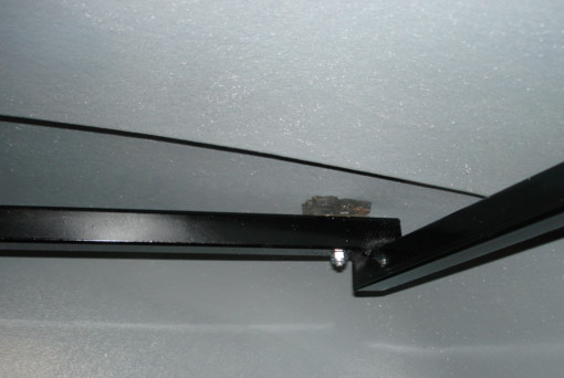

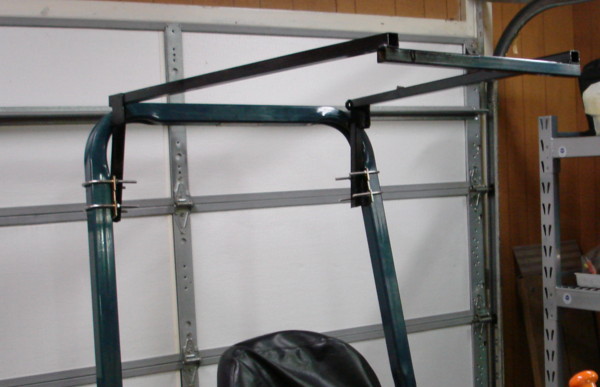

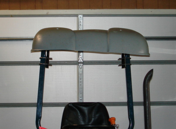

This roof probably weighs in at around 10-12 lbs, so the weight is not nearly what a metal one would be. On a smaller tractor like this one, space is at a premium for me at 6'2" and 275lb, so I solved the support factor by triangulating the rear corners. As in any fab project, I'll check it out with use, and add any changes down the road as needed.;)
   / Homemade Canopy #32
Some more pics I took for those wanting ideas.:cool:

Hey you guys, sorry I have not been around in awhile. I guess I just got lost somewhere with too many projects around the house and a new job since I lost mine old one after 29 years with the same company. Anyway I'm back - but as nh15201 since I couldn't get any reponse from the admins after I lost my password (old age I guess).
My homemade canopy has been giving me excellent service with no attention to it since I installed it. The wing gussets clamped to the ROPS and welded to the frame has stood the test of time with no undue vibration or cracking. At the time I thought I may have overdone the gussets size wise - but now I'm glad I did. I do get some vibration once in a while - but nothing real annoying. The steel canopy has really saved my noggin' a couple times from limbs. The AL diamond plate from an earlier post would also be an excellent choice for a canopy - lighter than the 1/8" steel I used and ever needs painted.
