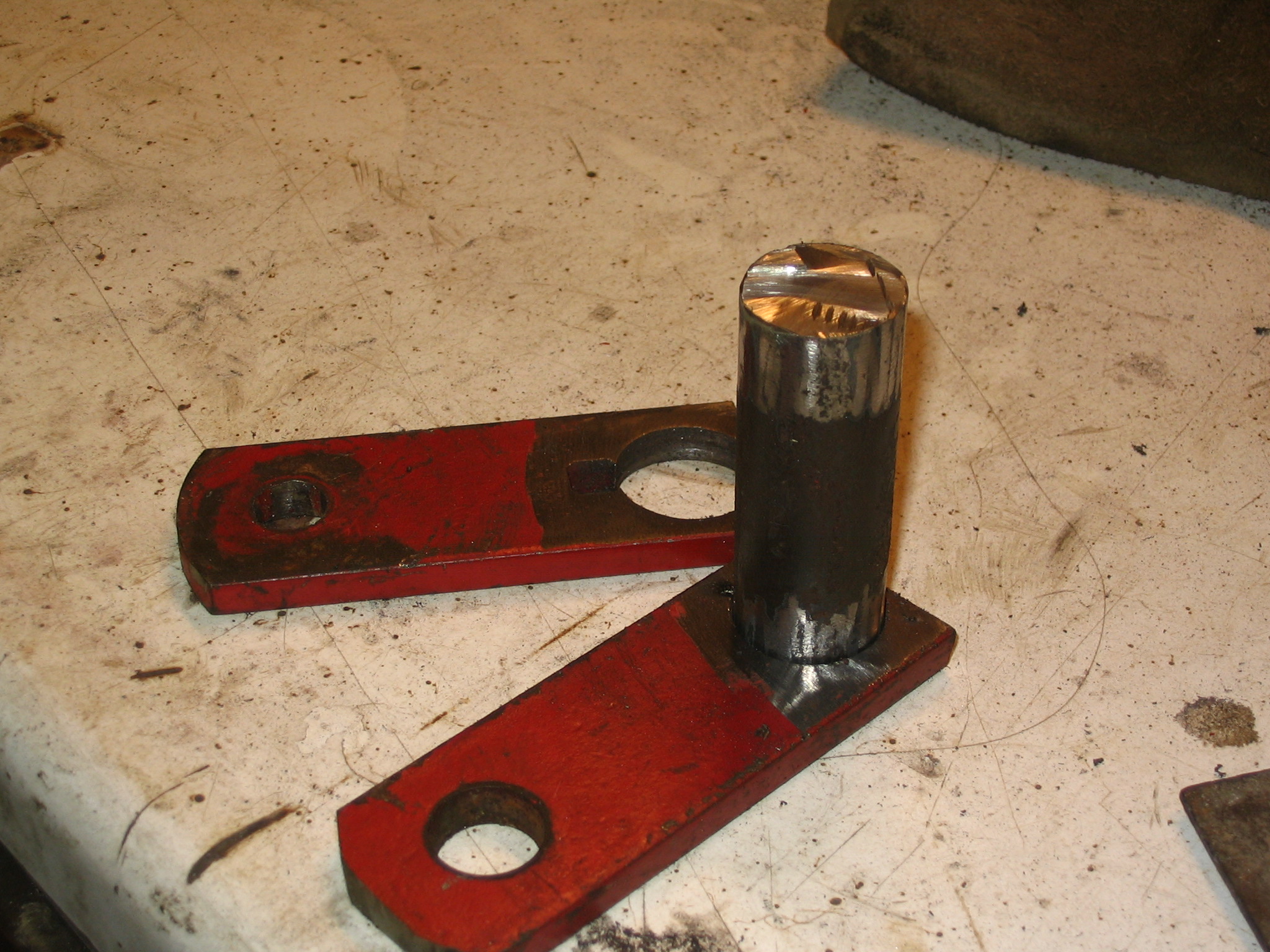

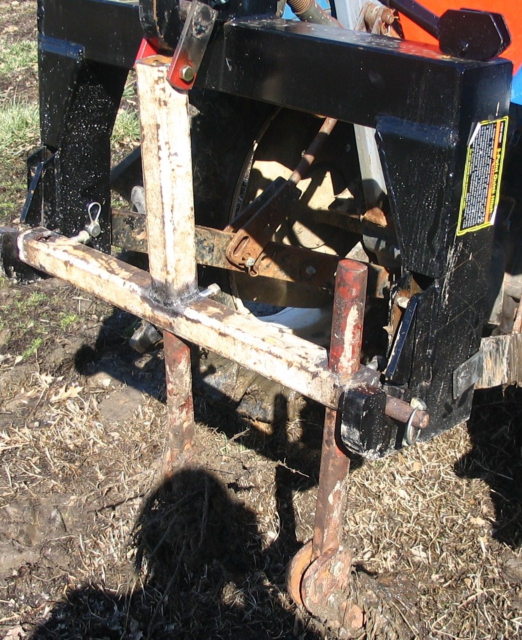

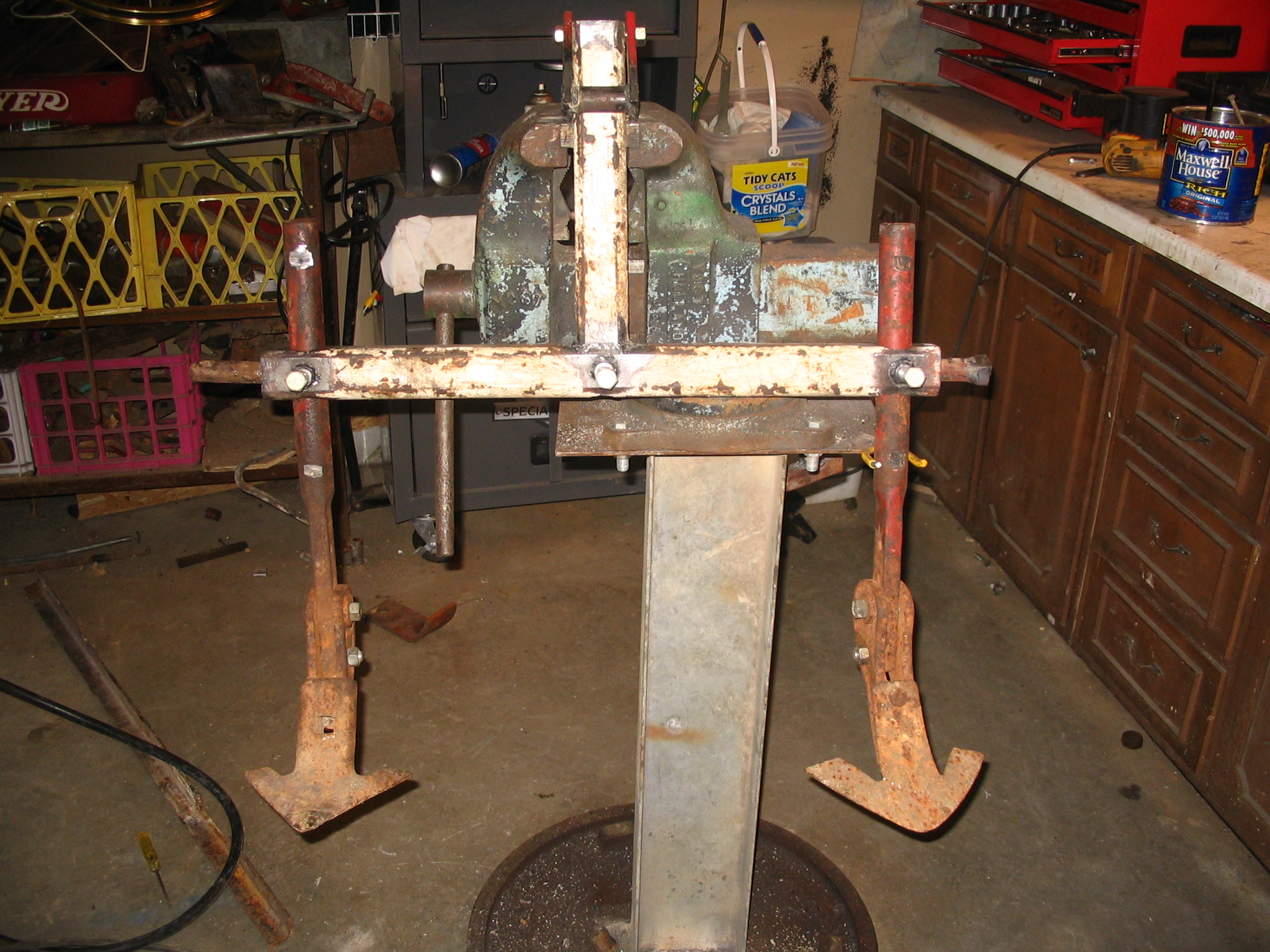

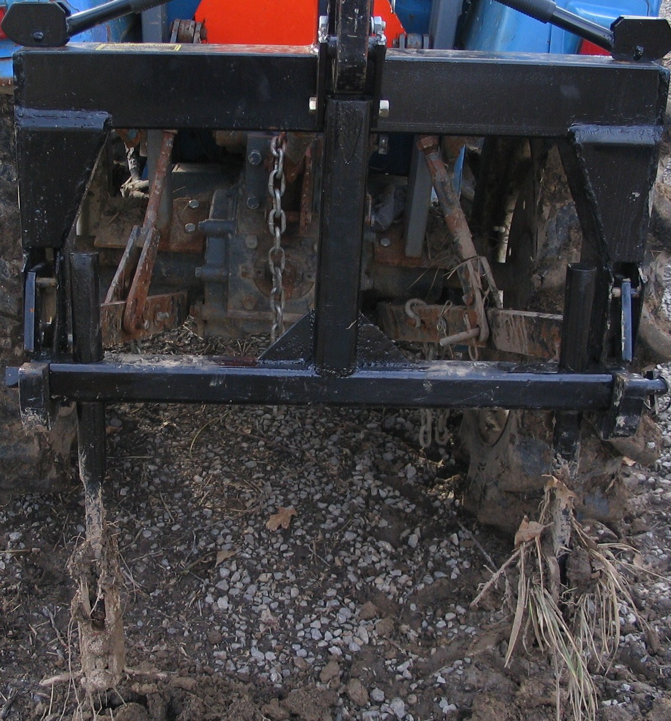

With garden season coming up soon I had started thinking about tilling. It seems every year I get a new caller asking about getting their garden spot tilled. (Usually goes something like this); " Hey Darryl, this is "so and so"....remember, we were in 1st grade together.....uh, I saw a tractor in your yard yesterday and was wondering if you would like to come by my place and till my garden for me? I'll buy the {beer,soda, cold water,etc}....waddaya say! Well, I get over there and their "garden spot" is an area of compacted clay resembling concrete that is so compacted and hard it won't grow weeds.

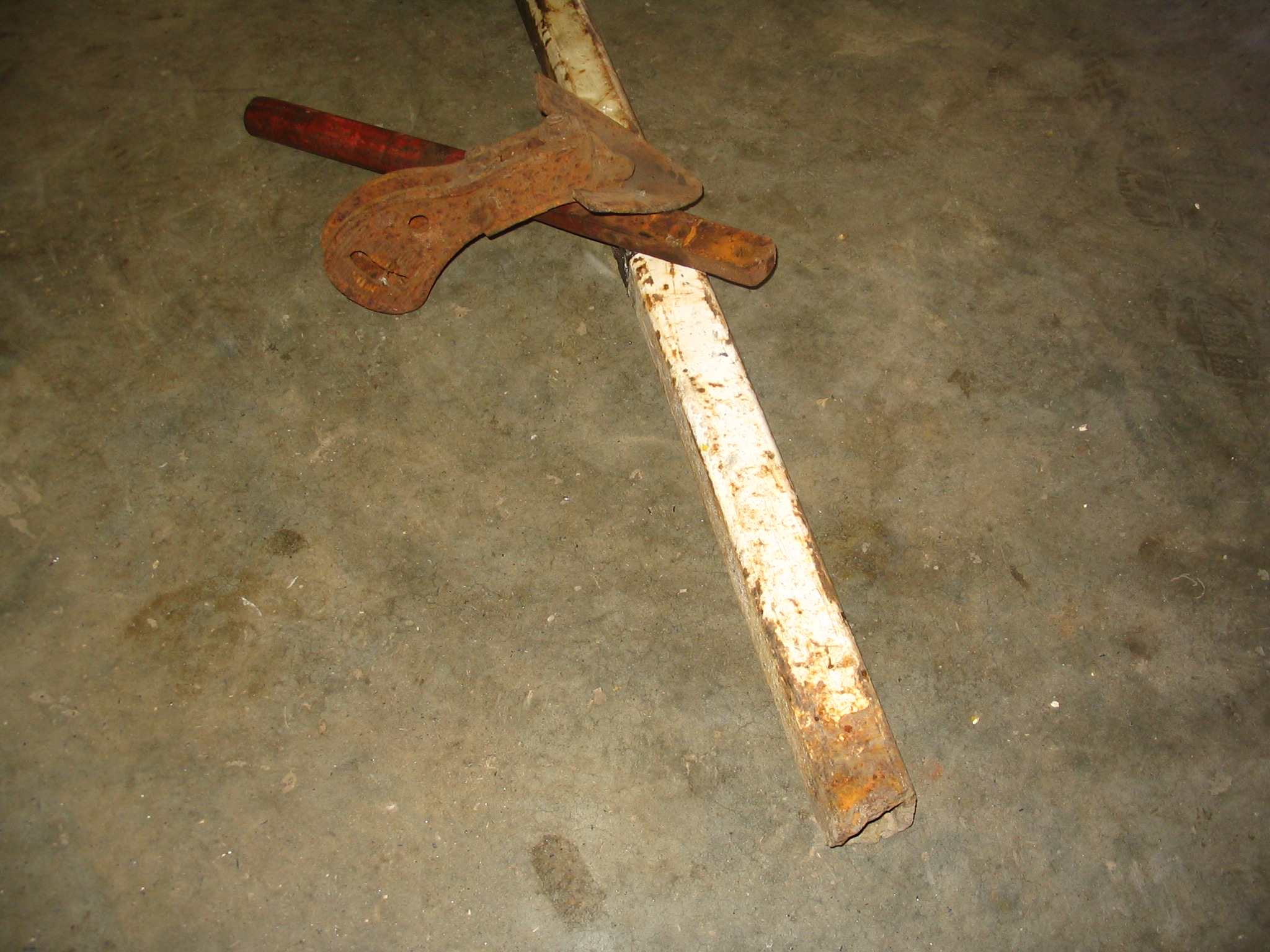

I have scarifiers on my box blade that I can use to break things up with before making passes with my tiller but then I'm faced with how to get the box blade and the tiller over there in one trip on the tractor. Sooo, I started looking through my scrap with the intention of building something relatively light and portable to make the initial ground breaking with. This is what I ended up with.
The first photo is some 2 1/8" OD- 1 7/8" ID square tube and some sweeps I had taken off a cultivator at the scrap yard a couple of years ago.

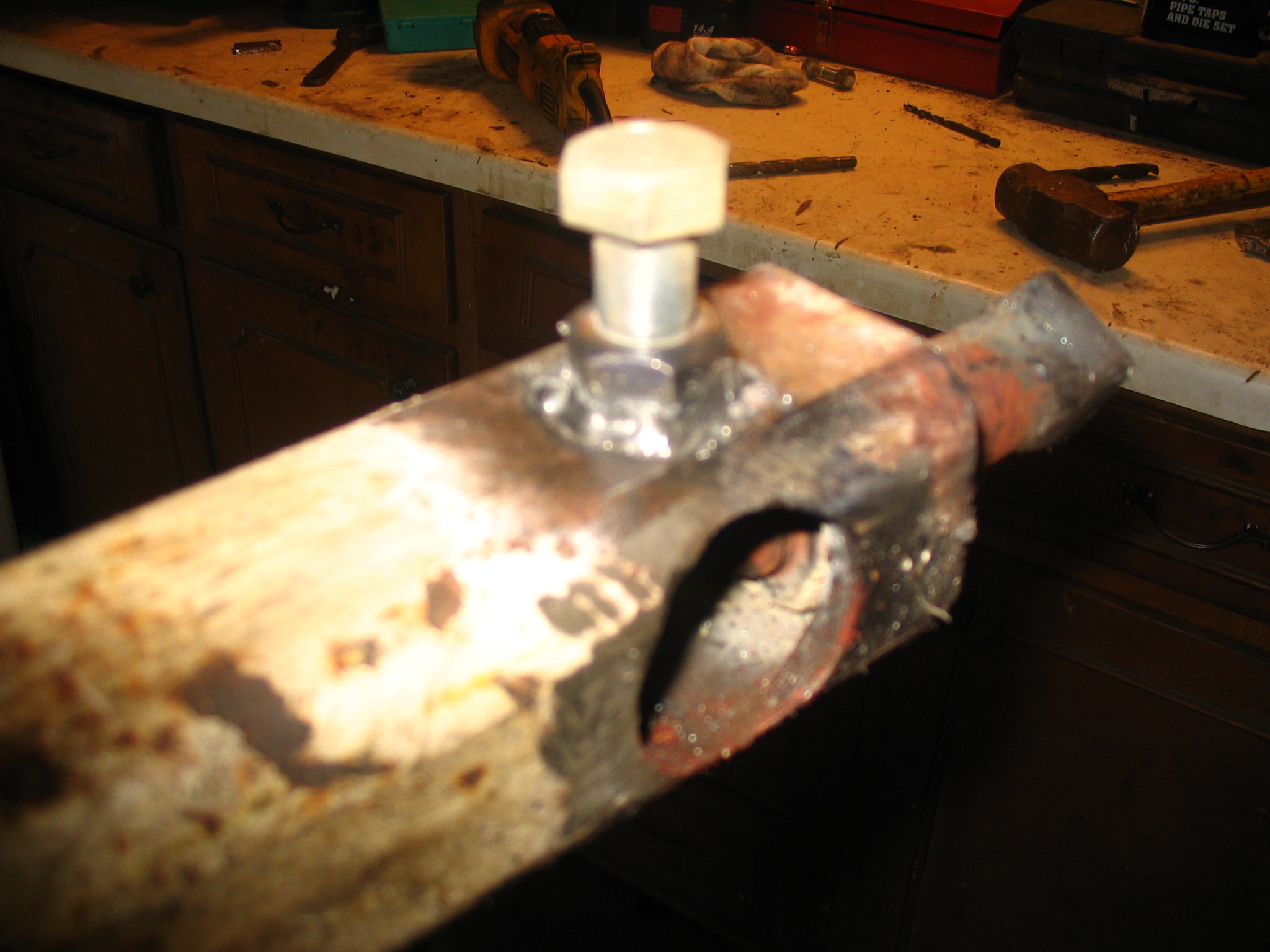

Second photo, drilling three evenly space 1 1/2" hole to accept the shanks for two sweeps. I can use either one sweep in the center or two on the outside.

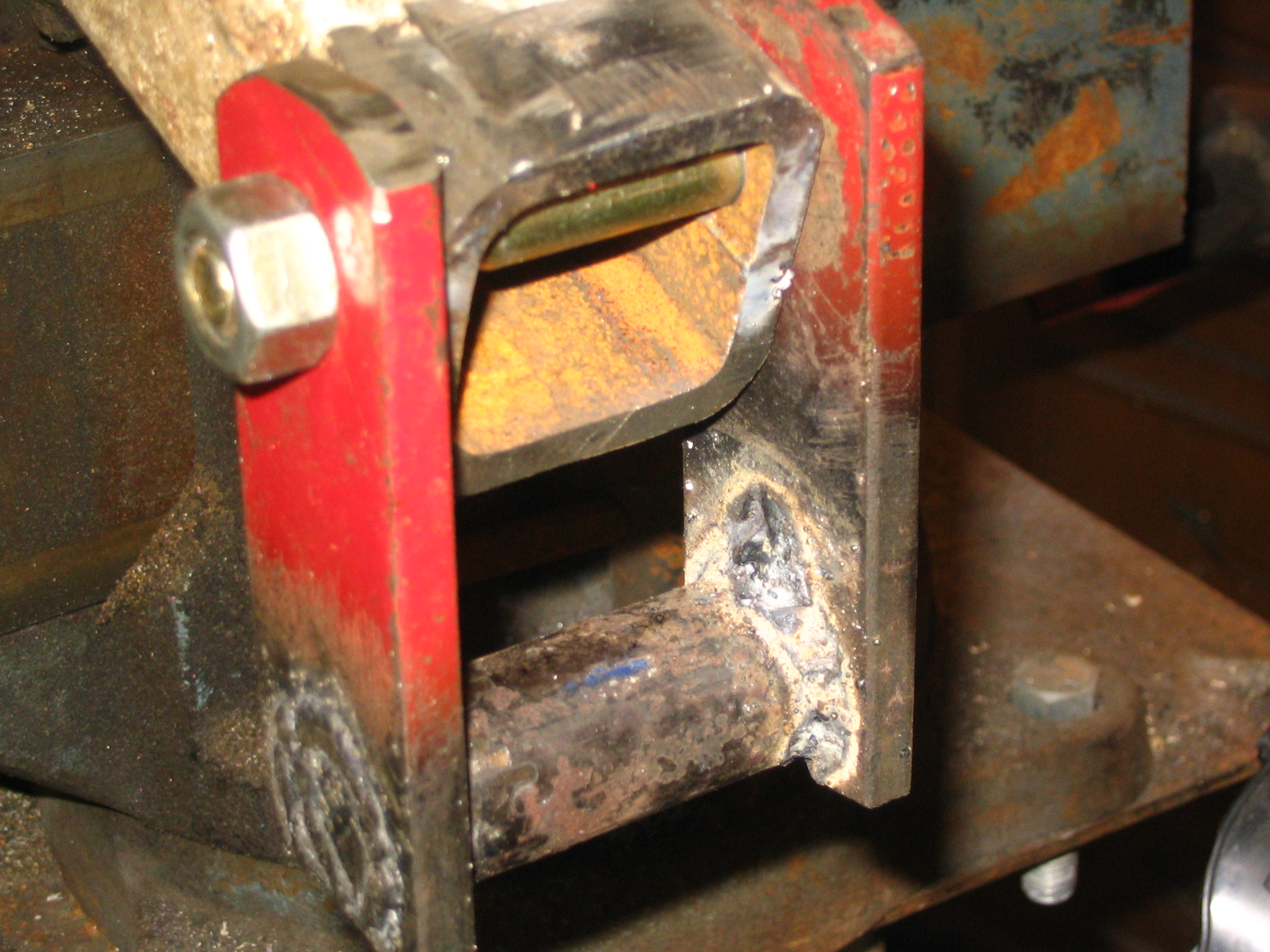

Third is welding in a couple of cat 1 pins.

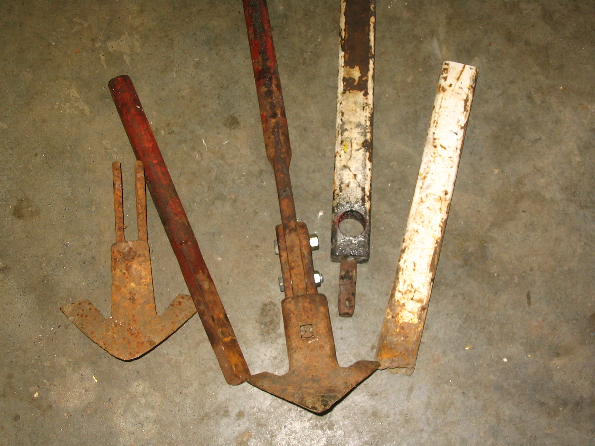

Four pic is how it looking so far.

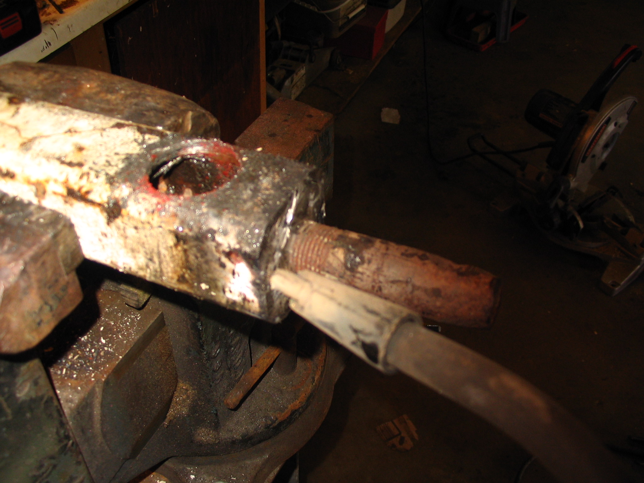

Five is welding up a vertical support for the top link.

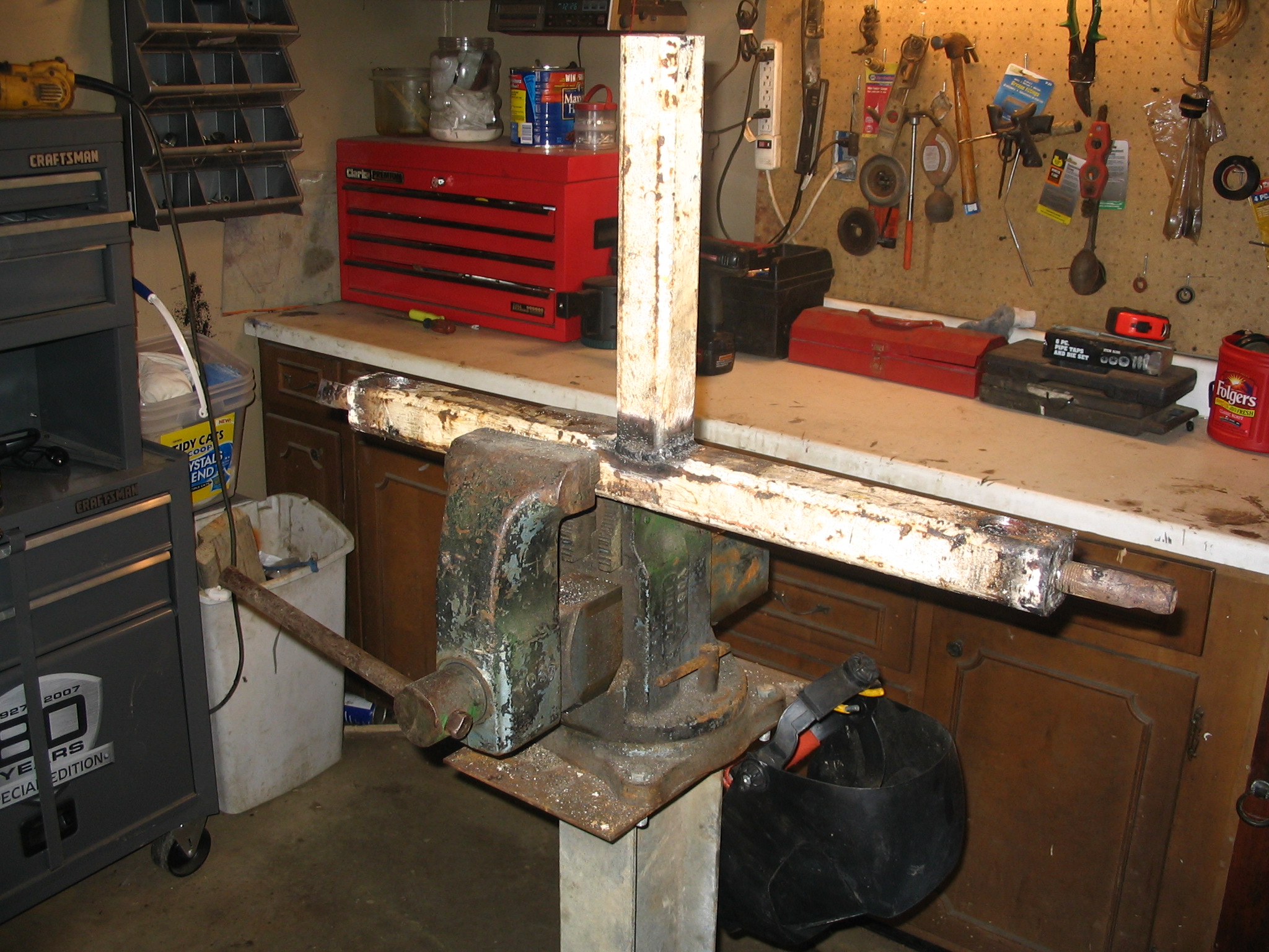

Six is 2" X 6" X" X 1/4" pieces that were drilled and then I welded in 1" bar stock for the top link attachment that mates with my quick attach.
Seven is the top link mate attached to the frame.
Eight is where I had to decide how to attach the cultivator shanks. I had originally decided to drill the shanks and use pins but after breaking 2 drill bits, decided I would just grind 3 flat areas along the length of the shanks to allow for some adjustment in their length and weld in some heavy bolts that would hopefully tighten up enough in the flat grinds and hold the shanks securely.
Nine is the finished product.
Ten is after taking it out and giving it a try in our extremely muddy ground. So far it worked great but I'll have to try it again when things dry out again.

Excellent project! The only thing that I might do to stiffen up the project is to weld gussets to the top link post.

actually, I found some 1/4" plate already cut into triangles in one of my scrap boxes that I intended to use just for that and I got ahead of myself and forgot to weld them in. I'll take your advise and do just that before I paint it.

I was going to finish welding in some gussets and painting it in the next day or so and will try to post some more pics soon. The picture of it attached to the tractor was taken after returning to the house after trying it out. I realized I had forgotten my camera when I was out in the field actually breaking ground with it so right now I don't have any pics of the "results".

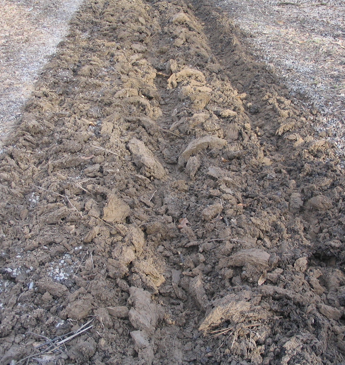

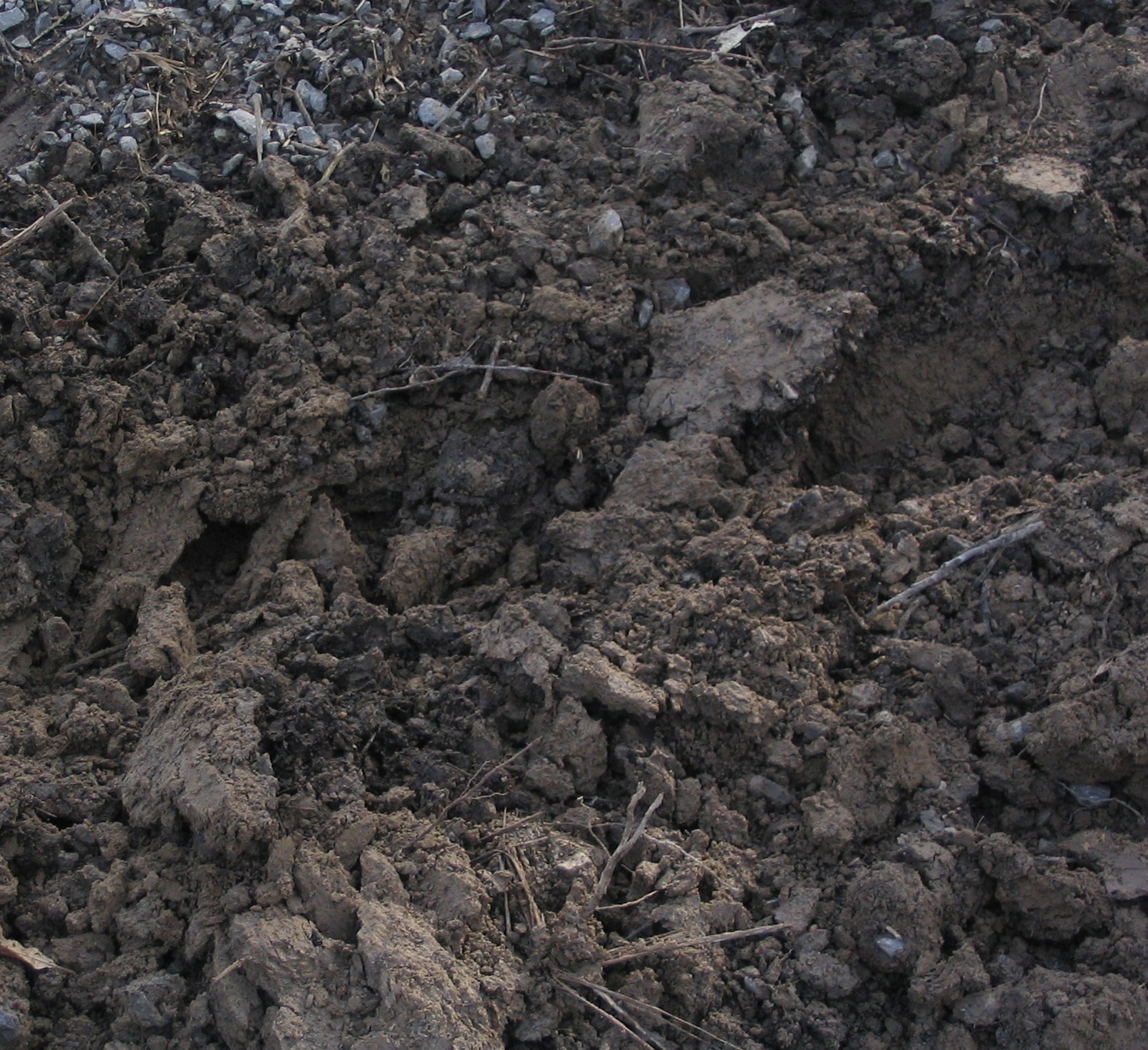

Charles, here are some pictures I took yesterday. I went back out and tried using it in the same muddy field I first tried it out in. Because it was just turning heavy grass clumps and mud it appeared pretty similar to the very soggy ground that wasn't disturbed and was difficult to get a picture that showed just how well it was turning and breaking the soil. I found a firmer area with just a touch of gravel on the top to try it on and was very pleased with how it works.
EDIT; I forgot to mention this was three evenly spaced passes with the sweeps set 24" apart.
