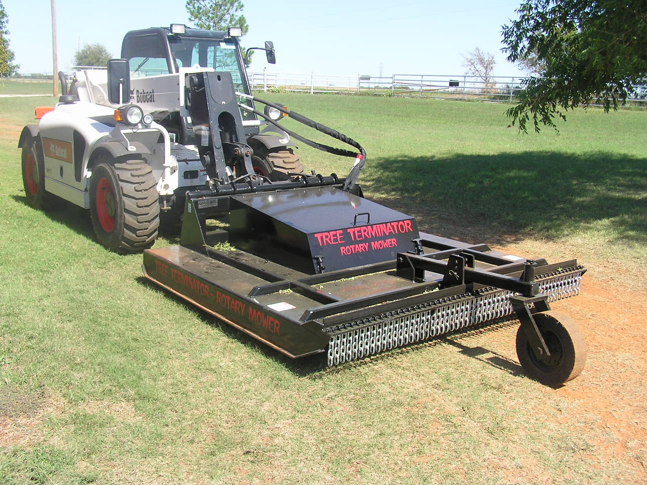

Looking good :thumbsup:
I also recommend a castor wheel on the front. Then with your hinge it would work just like my 7 footer.
Tilt the QA plate down so the mower can follow the dips and high spots on the ground.
